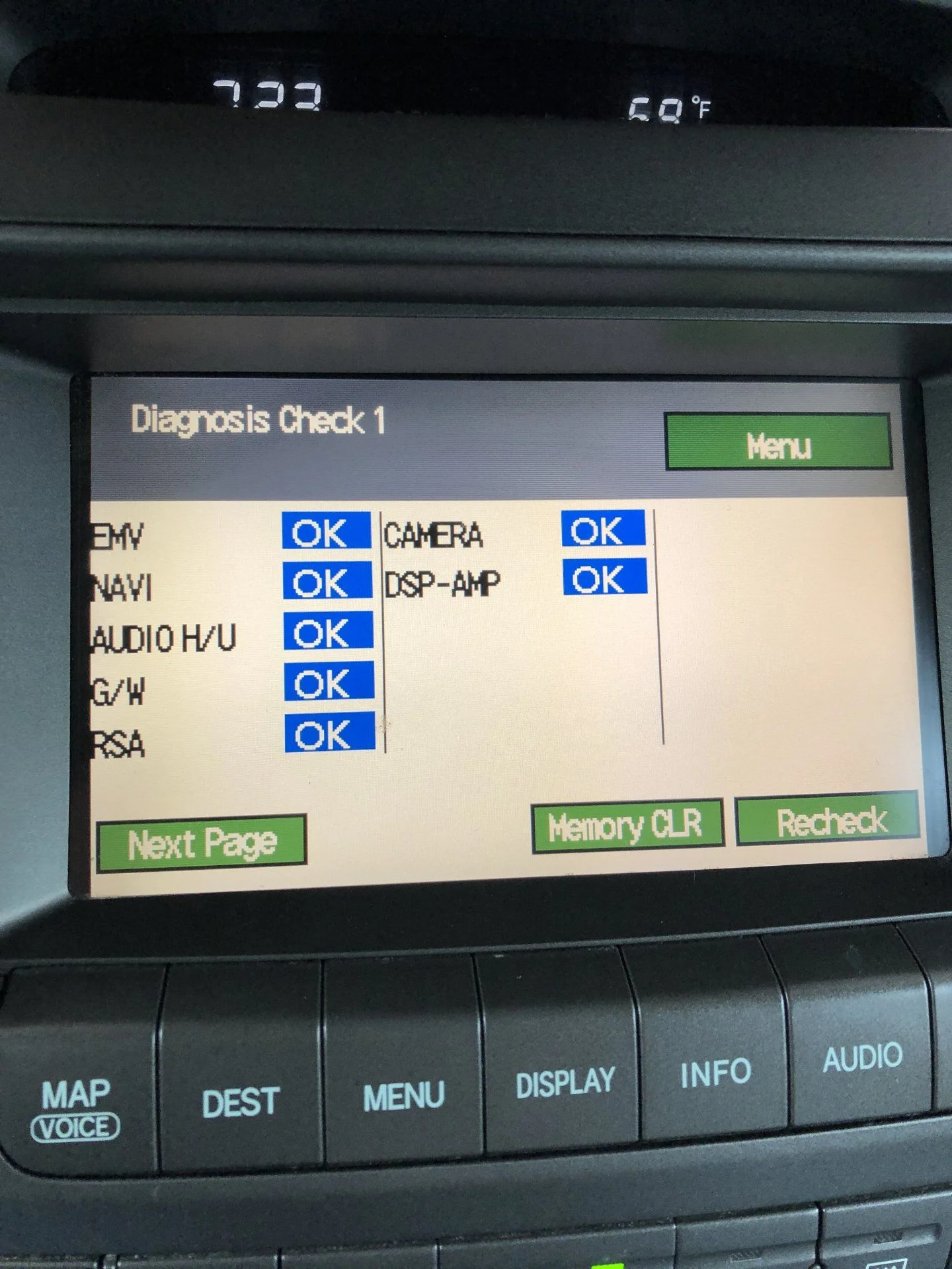

Hello. I have an issue where no sound will come out of the speakers using the radio. The NAV lady will talk out of the driver’s door speaker. I put the screen in diagnostic mode and everything came up Aces so I’m stumped.

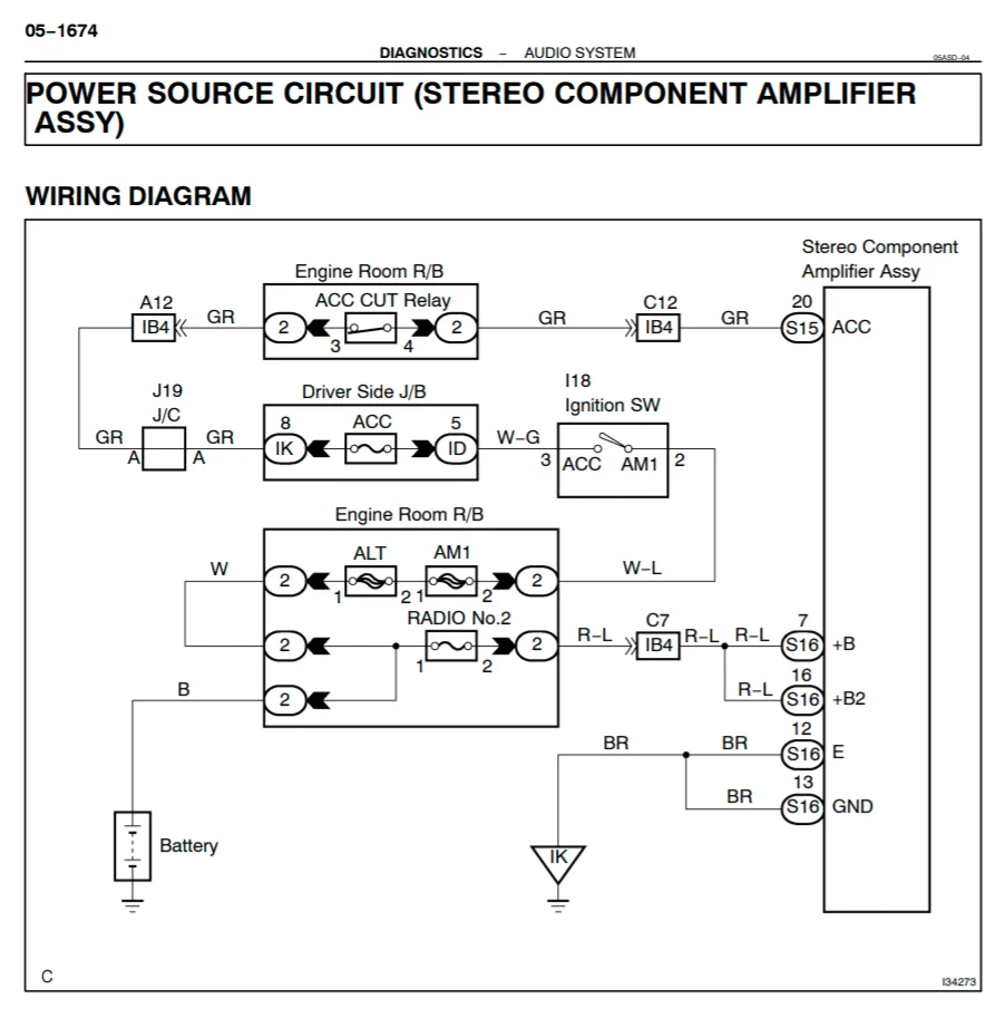

I just bought this thing on Saturday so still going through it. The screen would not come up initially and I found radio2 fuse blown. When I replaced it, the screen started work and gave me Nav and Backup Cam and of course now I can use the climate control functions. Is there a fuse somewhere else for the amplifier? I pulled the amp out from under the seat and looked at the board for burnt spots but found none. Put everything back reseating the connectors at the amplifier and at the back of the radio and still no dice. If it’s fried it’s getting bypassed!!

Sounds like a classic amp failure... Would be awesome if you had someone local to you so you could swap amps and test, since your amp appears to be online as per your screenshot.
