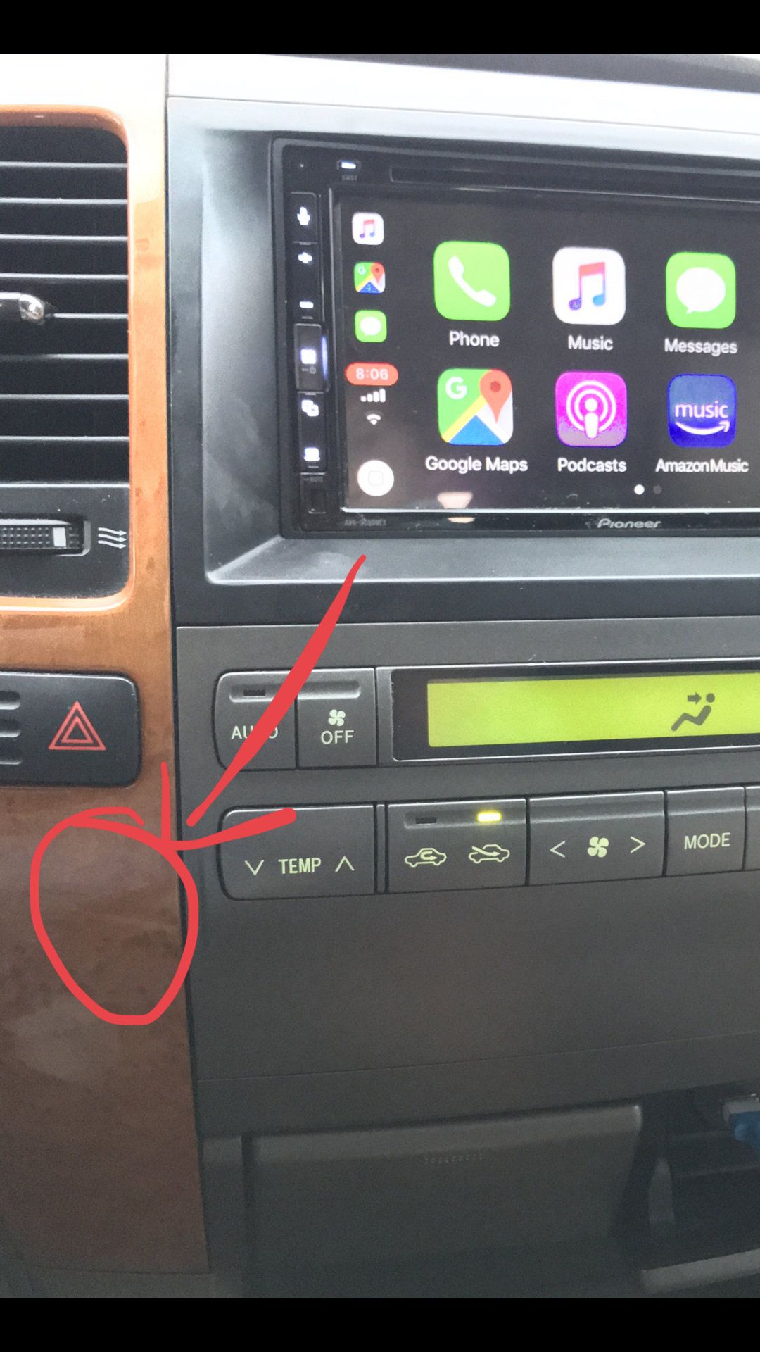

This happened to me again a few months back and I unplugged the large dash wire harness just left of the hvac controls (the big one secured with a 10mm bolt) and plugged it back in and everything has worked since.

Thanks for the reply and update. When you say big wiring harness, I know if the ones to the left of the driver in the footwell and the one to the right of the passenger footwell. Are those the ones your talking about or is there another one I'm missing?

I mean in the center stack. If you pull the wood trim that holds the hazard switch (gotta pull off the gray trim left of the shift lever first), there is a big wire plug held in with a 10 mm bolt. It’s how all the stereo stuff plugs into the car.

Well I gave that a shot and still no sound. It's definitely my amp. Let me know if you would like me to buy your old one.
