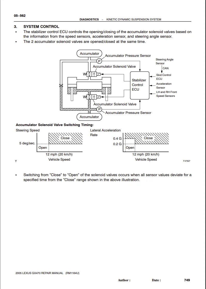

That's a great video and has me really questioning my butt dyno. I am curious if the systems are exactly the same between the 470 and 460? I have not seen the diagram referenced in both video for the 470 specifically - have you?

Honestly, I am mostly curious about the KDSS "rules" of the 470. I would not be at all surprised if our system is slightly different or less intelligent. ie locked to speed only vs. the multiple variables of the 460.
Found the exact diagram in the manual for a 2005 GX.

That is exactly the same diagram shown in his video.

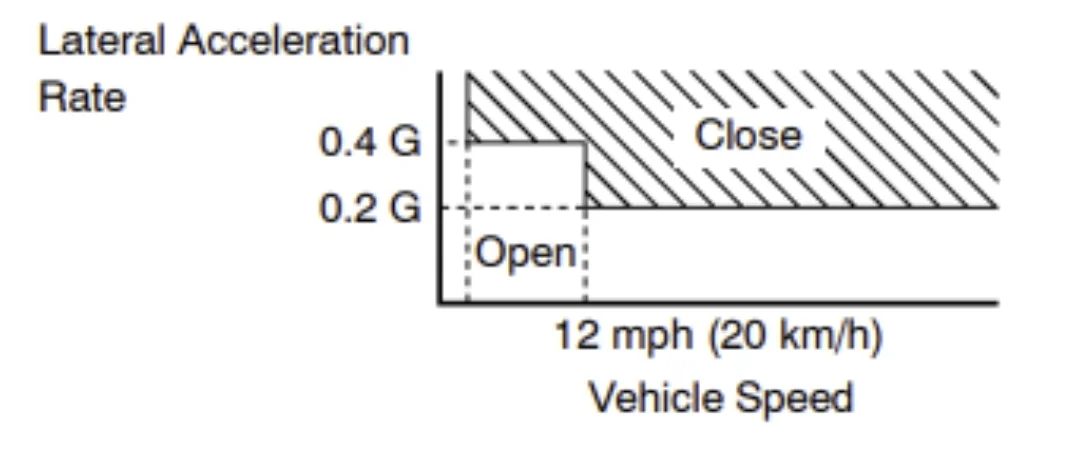

Steering input higher than 5°/sec and speed above 12 MPH would close the solenoid.
Second conditions are:
- lateral G higher than 0.4G above 2 MPH
- lateral G higher than 0.2G above 12 MPH
I would assume the lateral G can pretty bad below 12 MPH on rough terrain to cause KDSD solenoid to close.

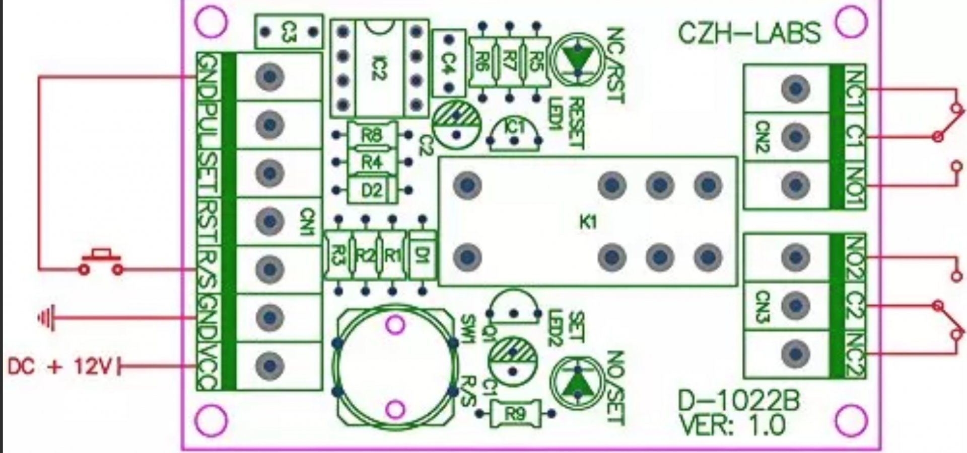

I used a Toyota style momentary switch that just says “KDSS” on it. No need to use a toggle.

I don’t have everything done, but I did use these instructions to get the relay wired and installed, and tested with a ch4x4 switch, so thanks for putting this out there. Should be able to get the wiring complete tomorrow.

What’s the advantage of using a relay + momentary switch instead of a toggle switch without a relay?
Is the concern with a toggle that you’d have all that wire running from the switch back to the KDSS harness in the back?
The intention is to have it automatically reset when you start the car. A switch works too and you only need to interrupt one solenoid. I did both upper and lower chamber solenoid and found out later it was not needed. One would throw a fault and disable the system already.

One follow-up question about how the momentary switch + relay allows the system to automatically reset when the car is started.
This is probably my lack of understanding of relays.
When the momentary switch is pressed, my understanding is the connection between NC1 - C1 flips to C1 - NO1 (same for NC2 - C2). If the switch is pressed again, flips again.
When the car is turned off then started, what is it that resets the relay to the normally closed connection?
This relay memorized the last state it was. Push the button again and it revert to original state. I did not realize this when I order it.
It can be configured to a few different way. I haven't mess wirh it to find out if there is a better way.
