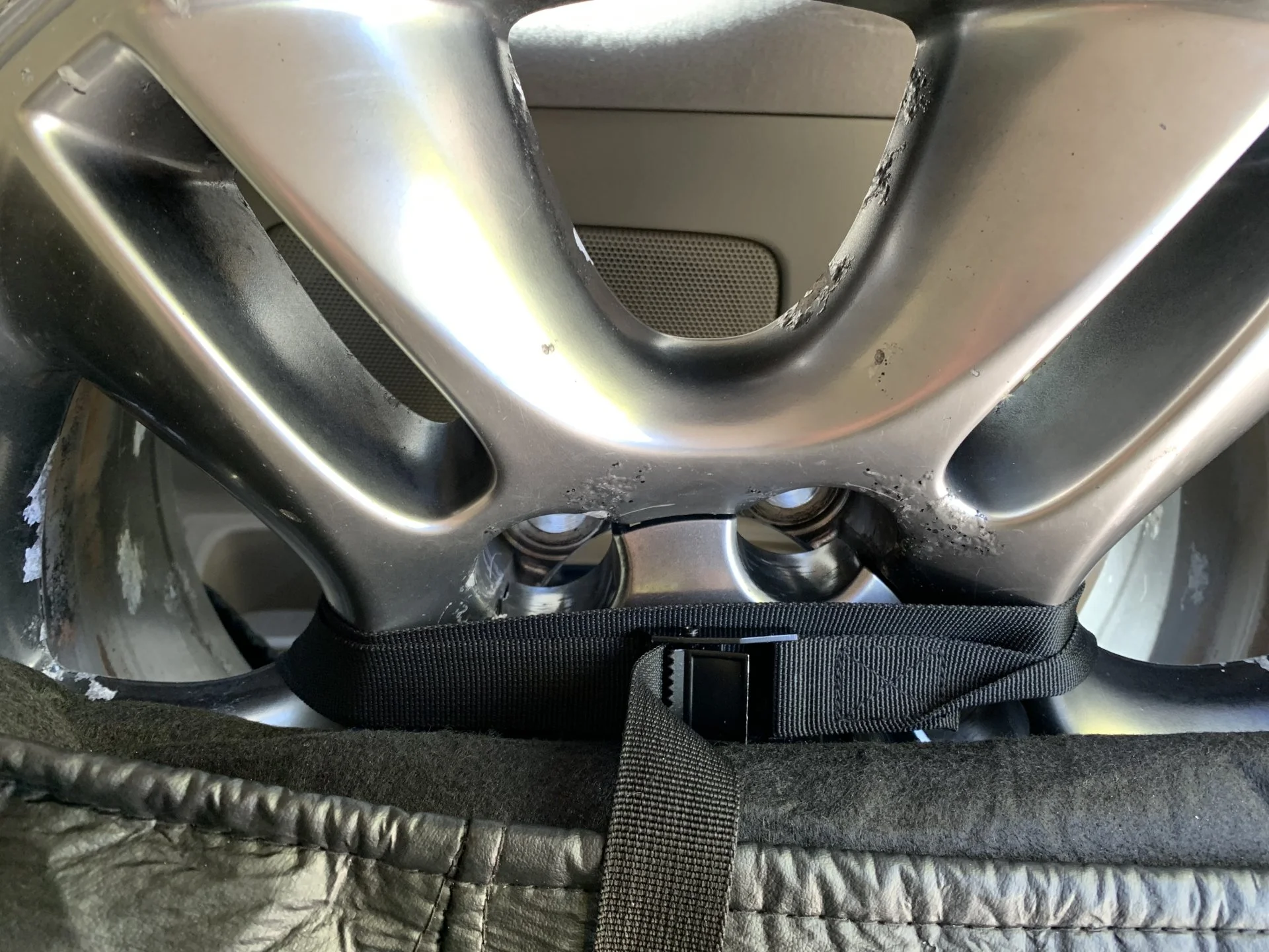

I had an eye bolt ran through a large "washer" to run my ratchet through. It centered the tension on the wheel better.
My "washer" was the remnants from using a hole saw to cut a piece of 3/8" steel. It was overkill but it's didn't deform under pressure.
I also used a down sleeping bag in a stuff sack to make sure the wheel didn't hit the window.

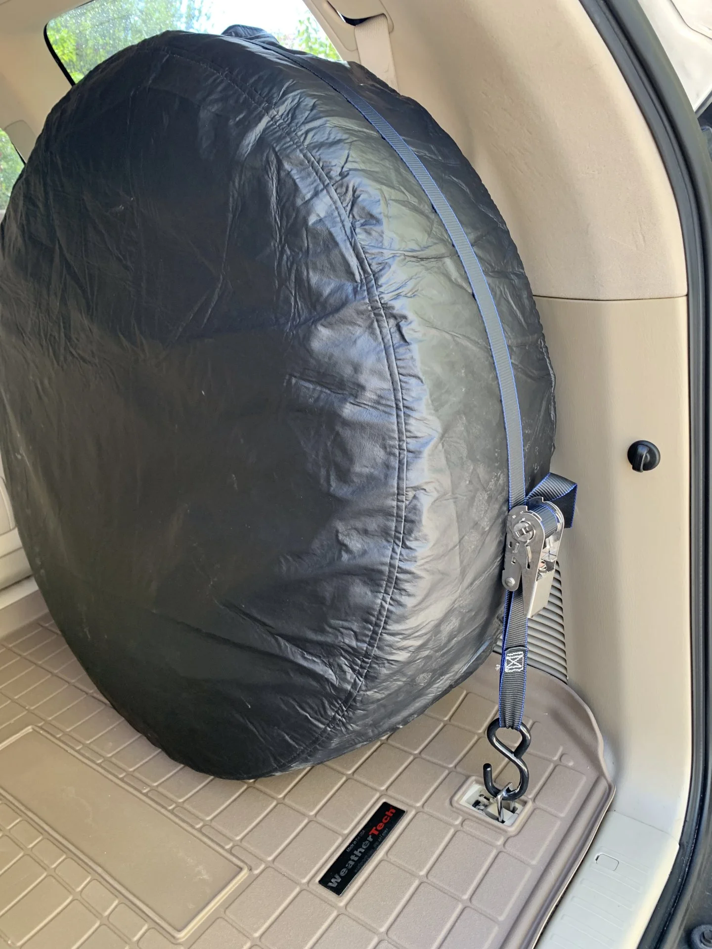

I got the above D rings from Amazon and screwed them in with the factory bolts.
Ran one strap thru the
Then a ratchet strap over the tire. Seems very solid but it does stink.

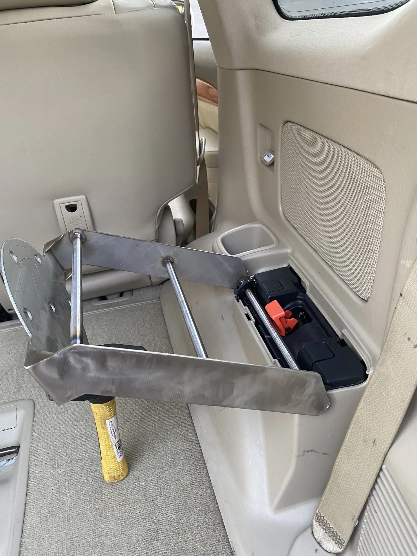

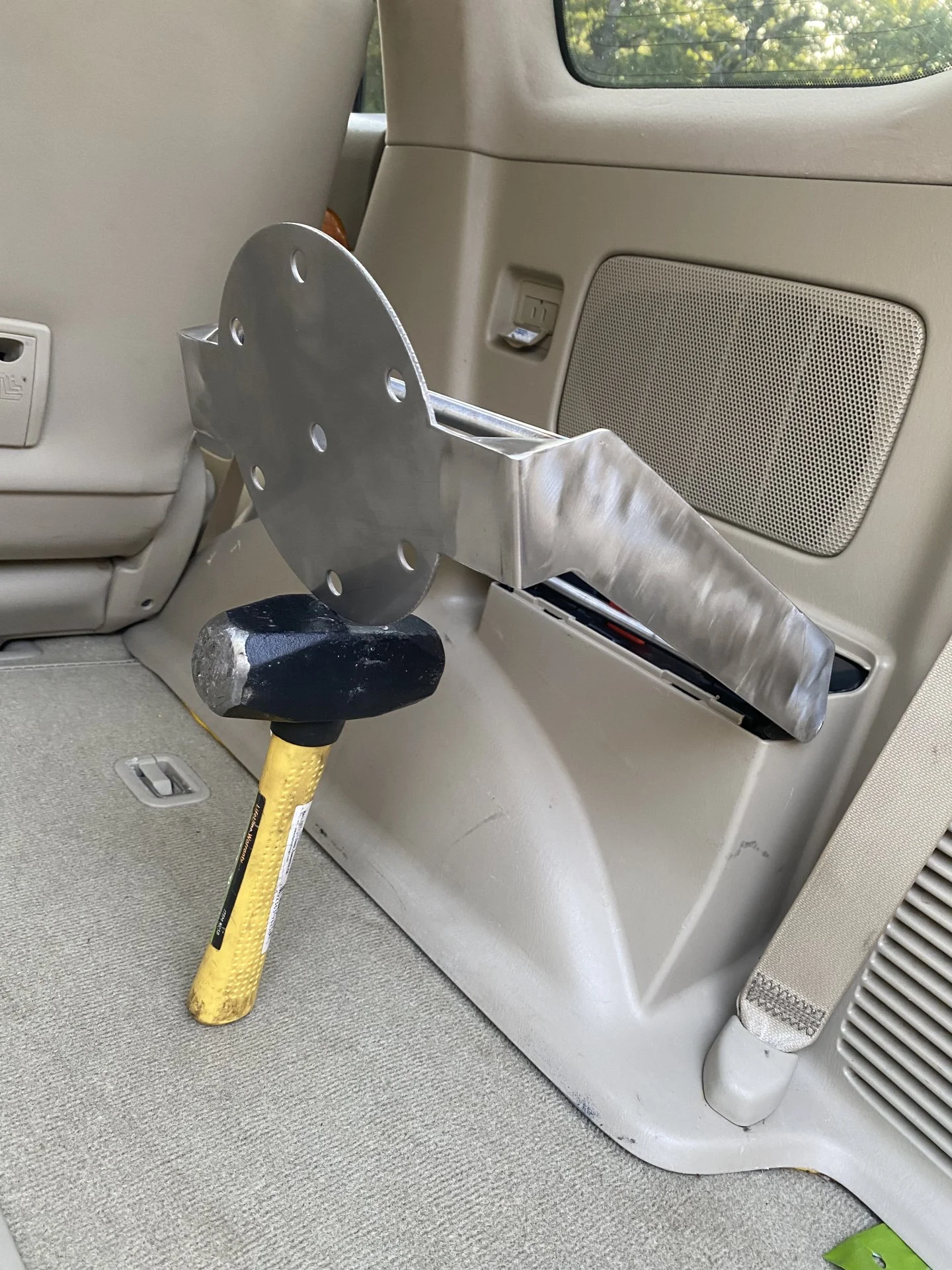

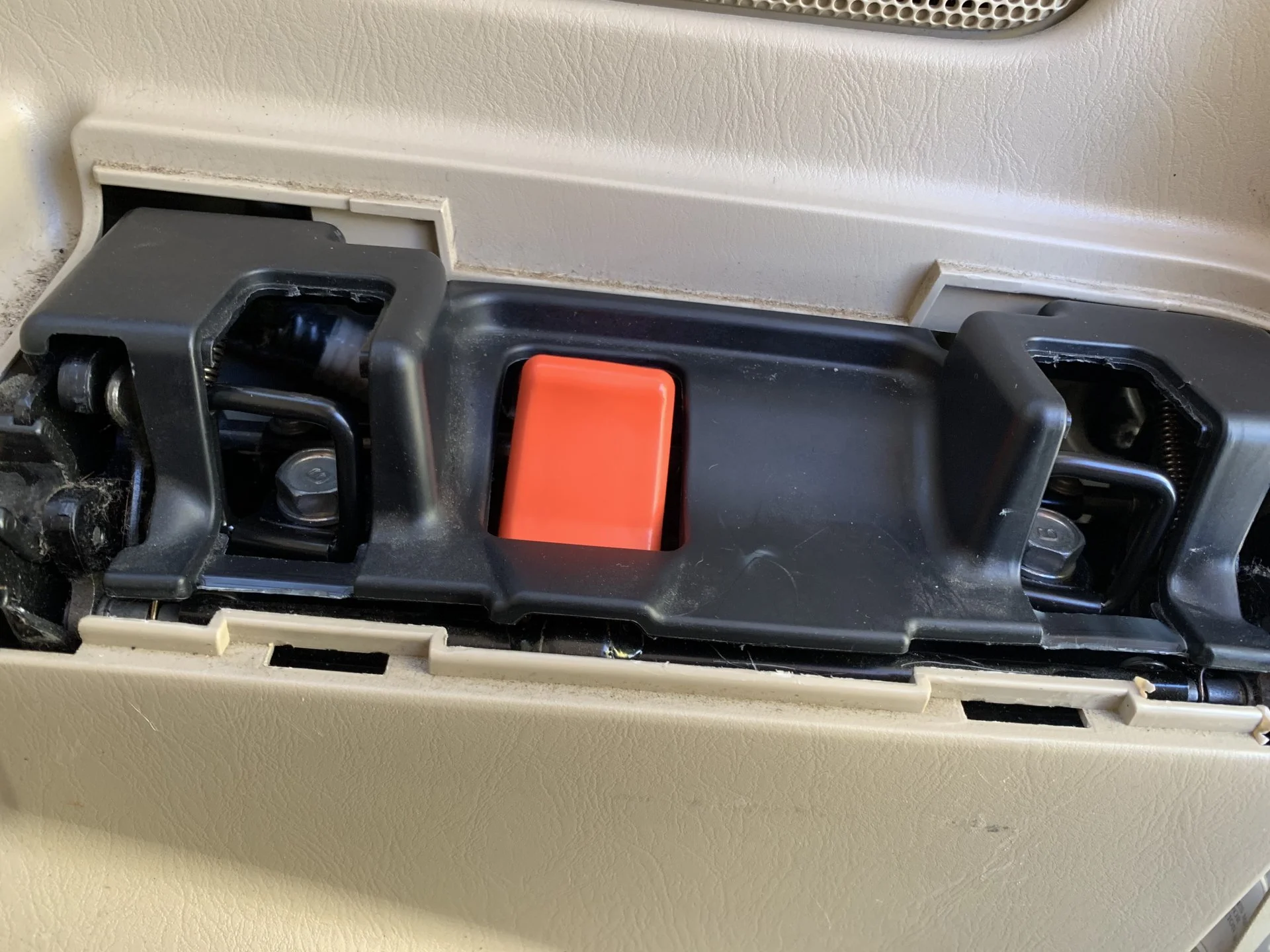

I liked this idea so much that I decided to dredge up this old post to share my incarnation of the cargo area wheel mount utilizing the jump seat latch . It’s obviously not finished yet but pretty stoked on how it’s coming along .
I'd buy one today if there were a reasonably priced option.
If someone were to produce a mount this style it would definitely be the most economical option to tire relocation . Also I like the fact that it does redistribute a bit of weight to the passenger side . Most people need that cargo space so it’s not an option for everyone.

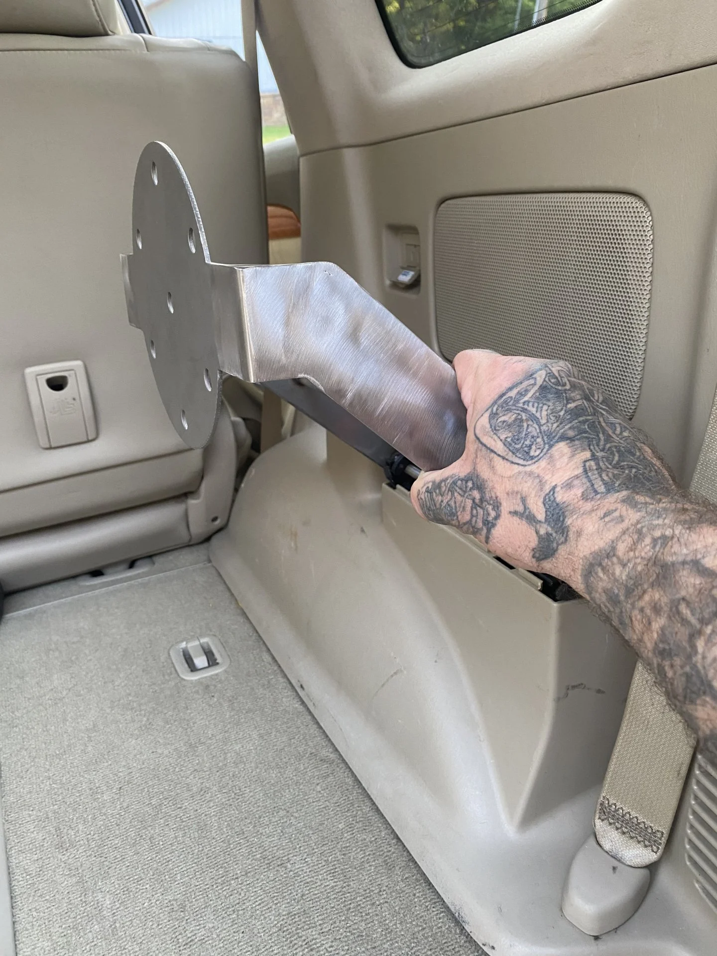

I had a local fabricator make me this after seeing this thread a while back. Except mine is on the driver's side for better visibility out of the passenger's side.
Great DIY project. Anyone done this in a 4runner without the 3rd row? There’s no seat bracket in mine it’s just an empty cubby… not sure if the third row bracket would mount the same or if I’d have to drill holes etc for it
