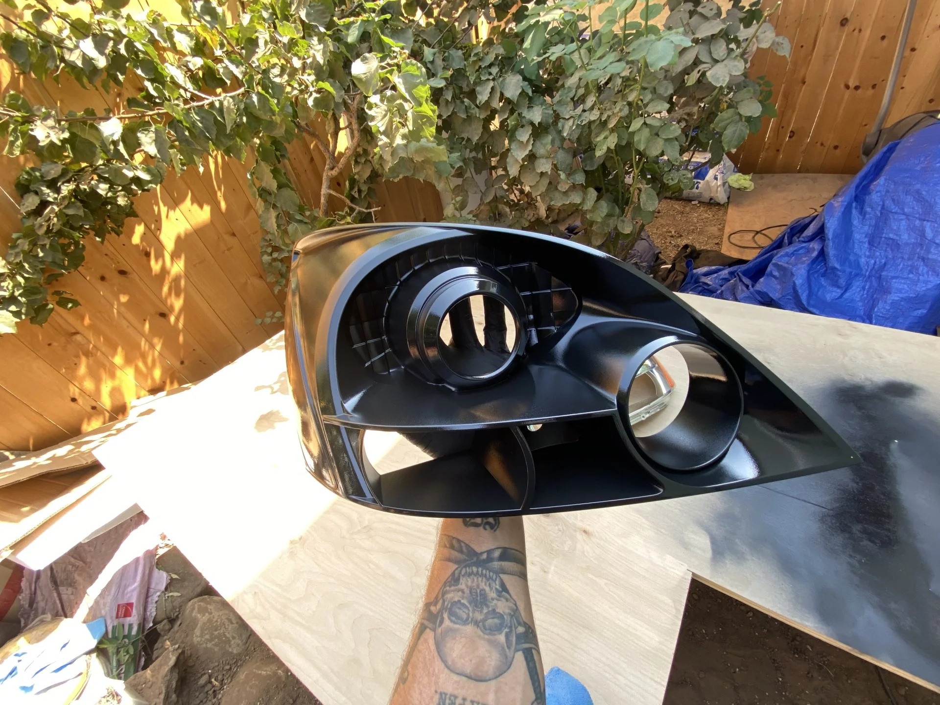

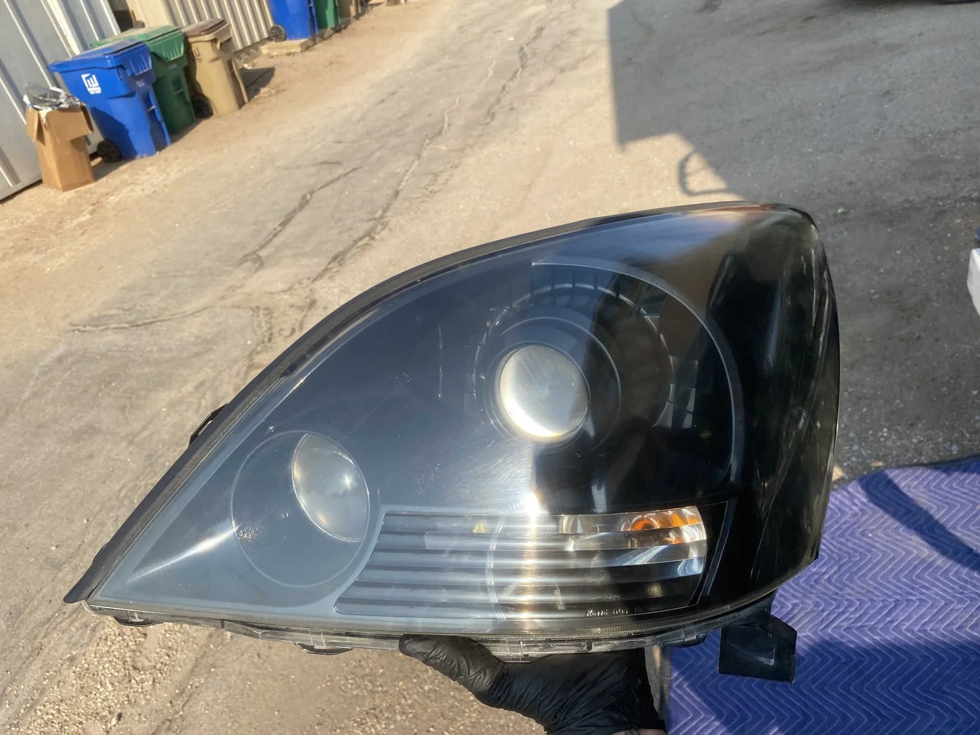

GX470 Black Headlight / Foglight Housing DIY

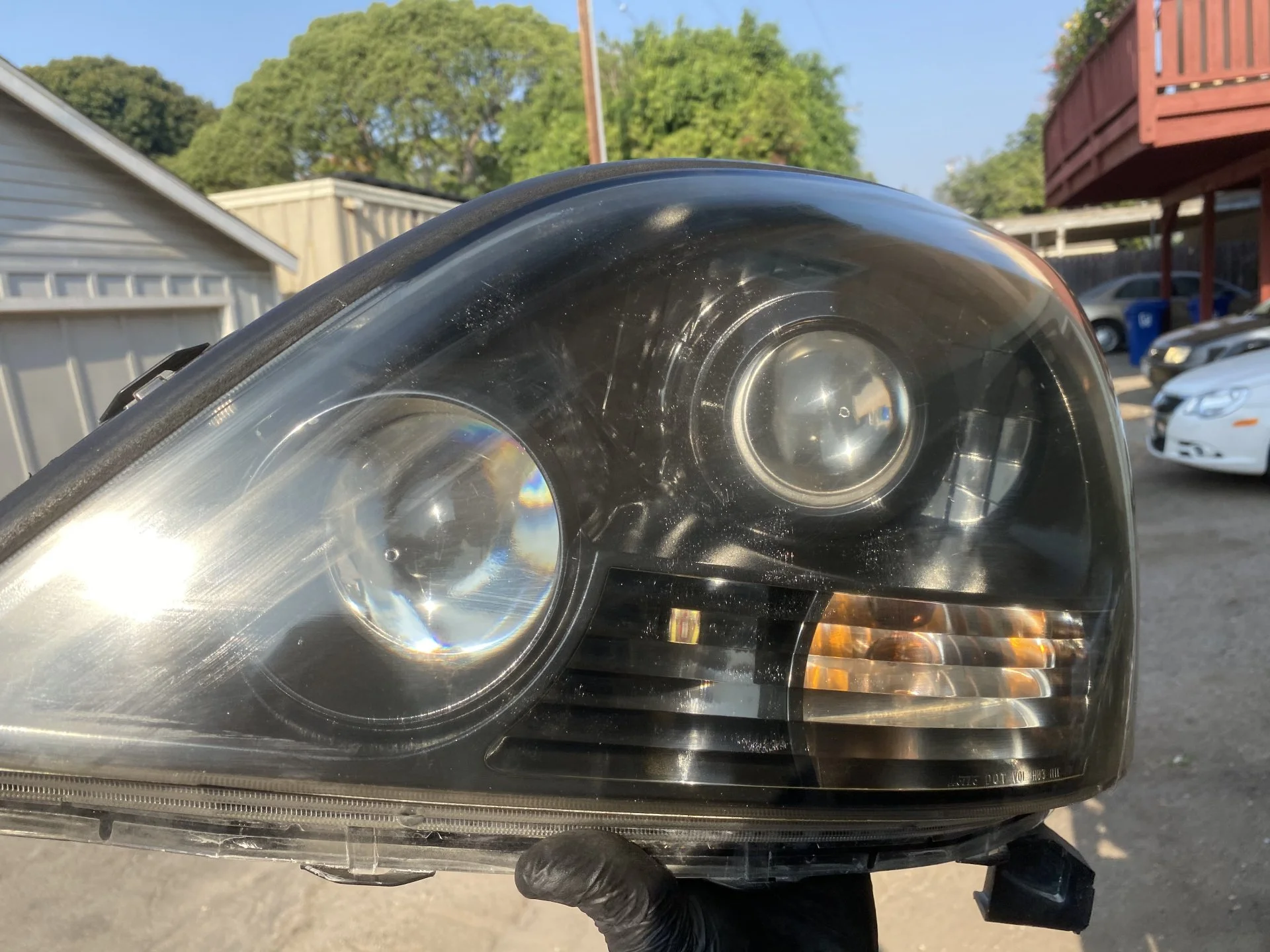

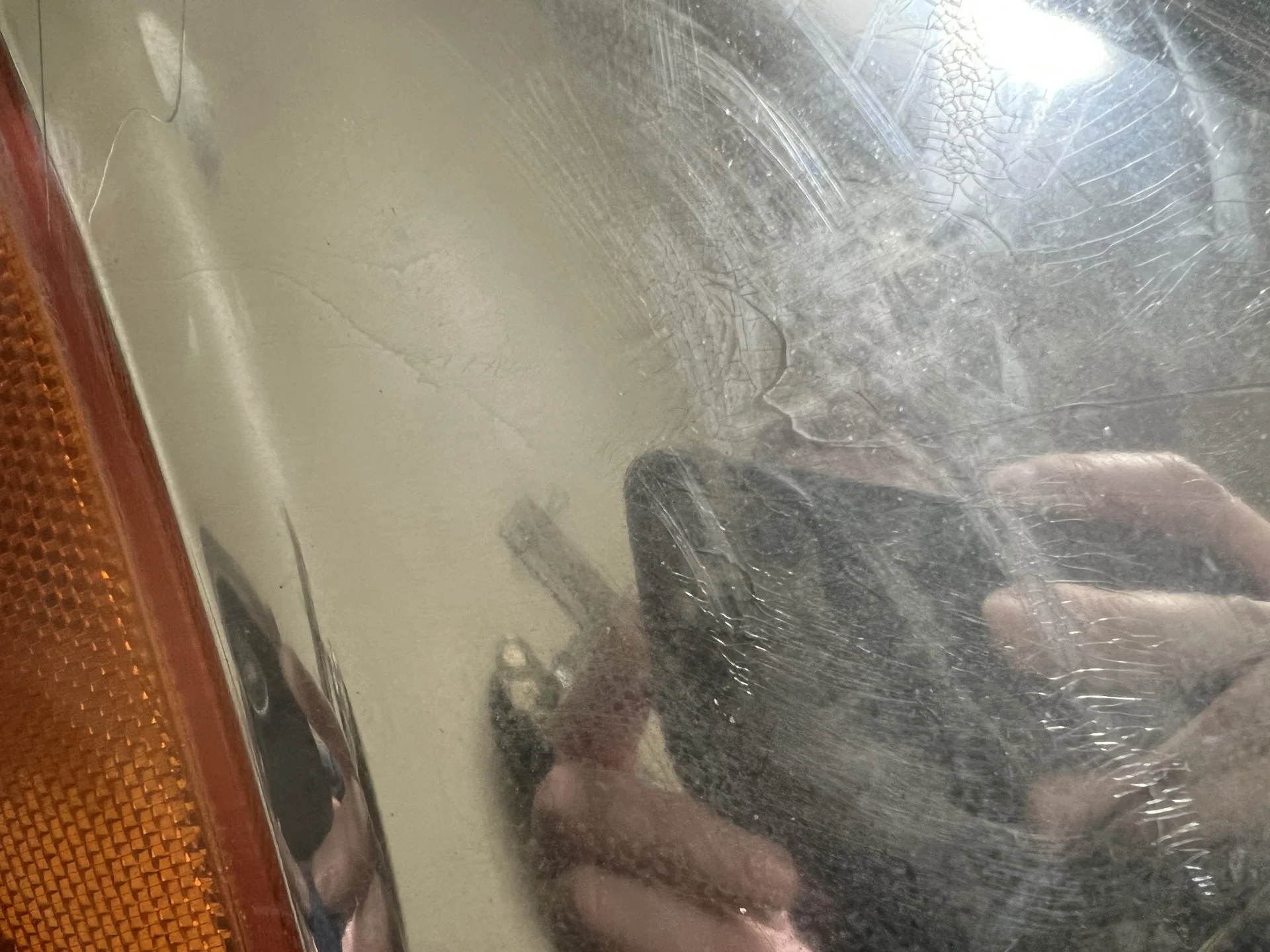

Dang really? Like how cracked?? I had talked to a guy that bought those and they were good for about a year. If you have to replace get some DEPO ones off eBay. If you’re talking like micro cracks in the plastic, mine has that too but you can barely see them after the restore
Good point, micro cracks so only noticeable up close. Hard to photograph.
Yeah! That’s not terrible dude. mine were like that as well. The other thing that helps hide those scratches is modding the headlights black like I did. I would try a restore kit that requires a buffer ( I shouldn’t say this but you can buy it at Home Depot, do what You need to do and return it at no extra cost to you). Try it!
Has anyone tried this and had good luck? I think I'm going to give it a shot soon. Curious if this affects actual lighting efficiency or not.
Definitely does not affect output at all - comment below pointed out that they’re HID projector lights. Not reflector so the light output remains unaffected
