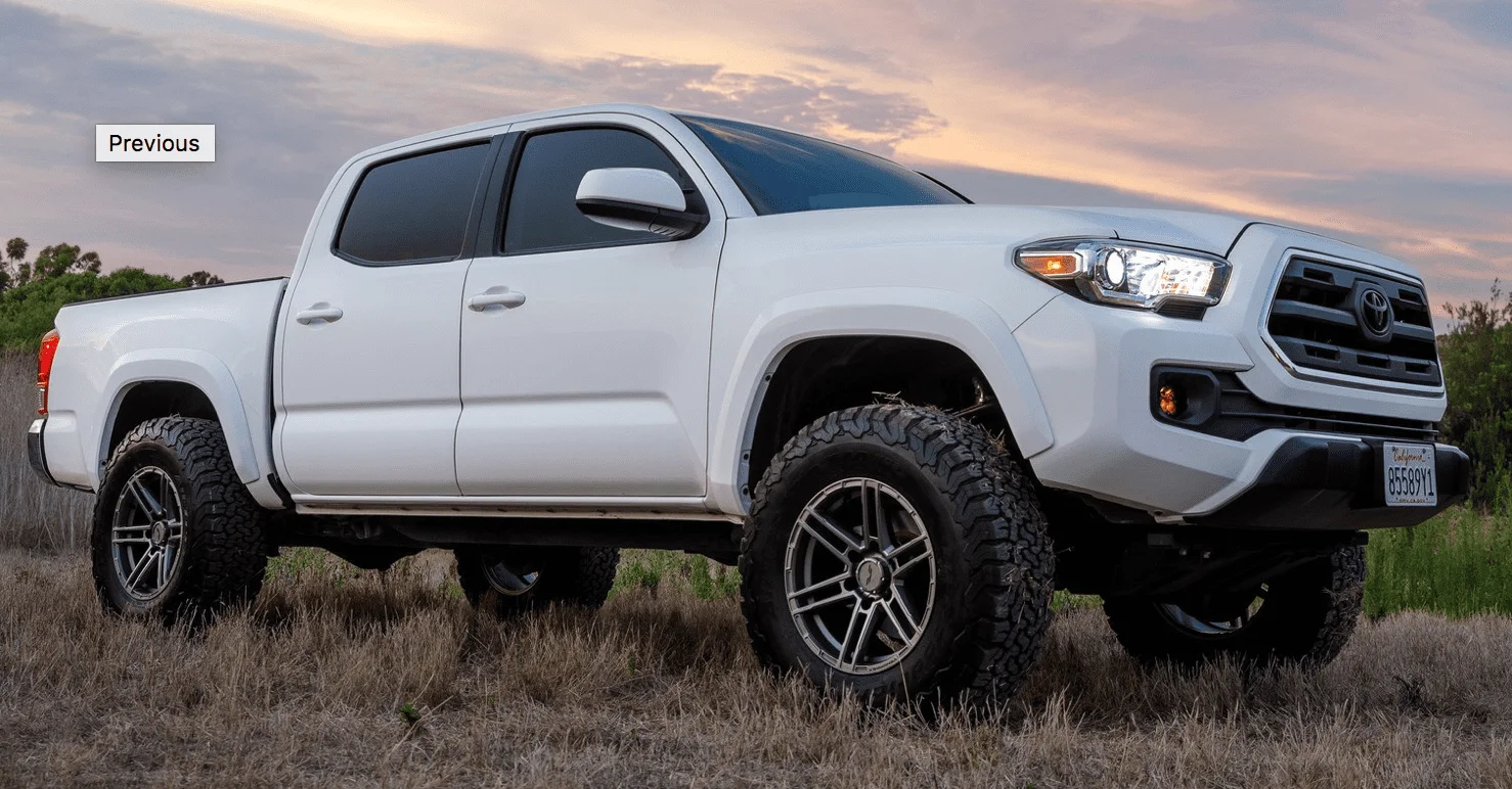

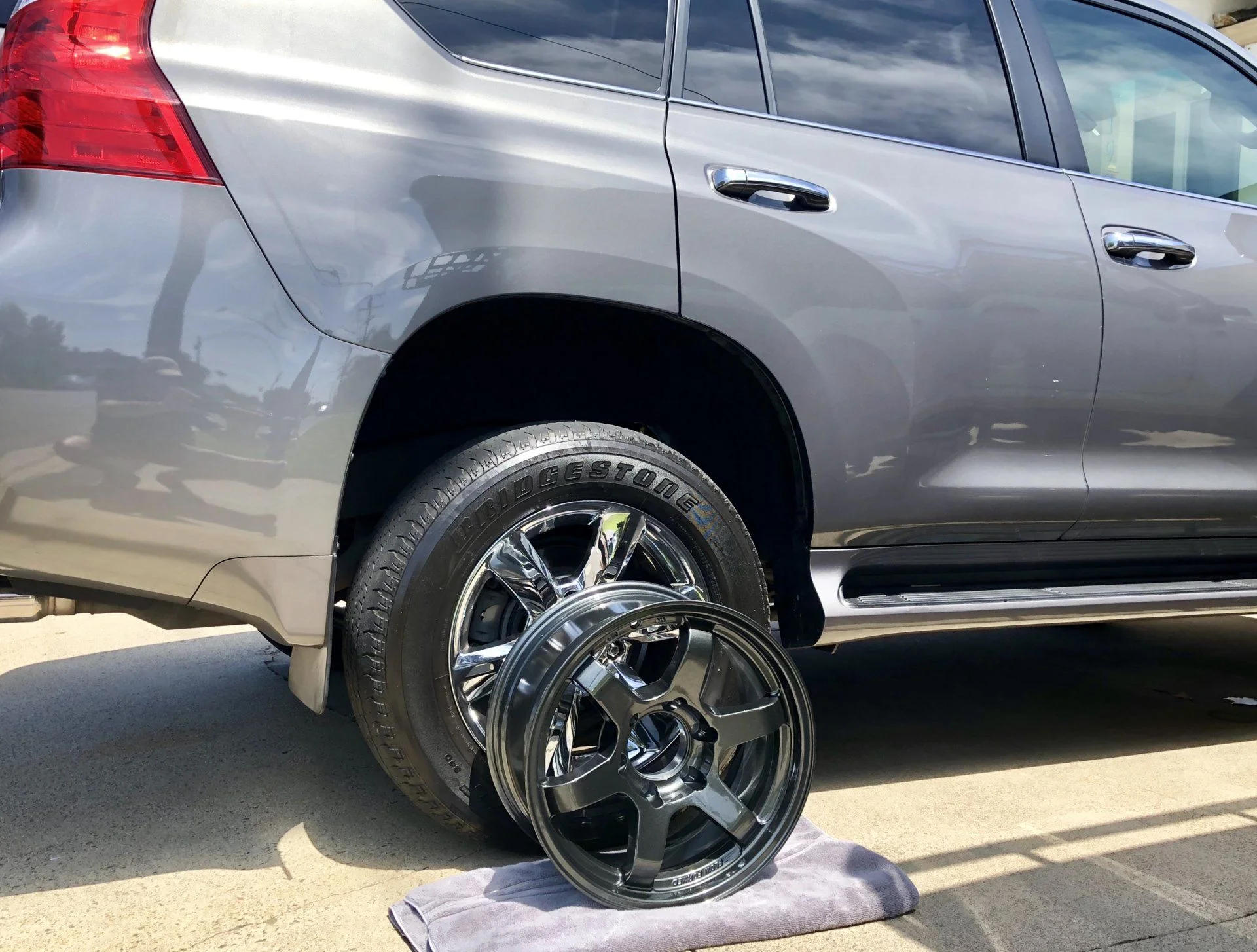

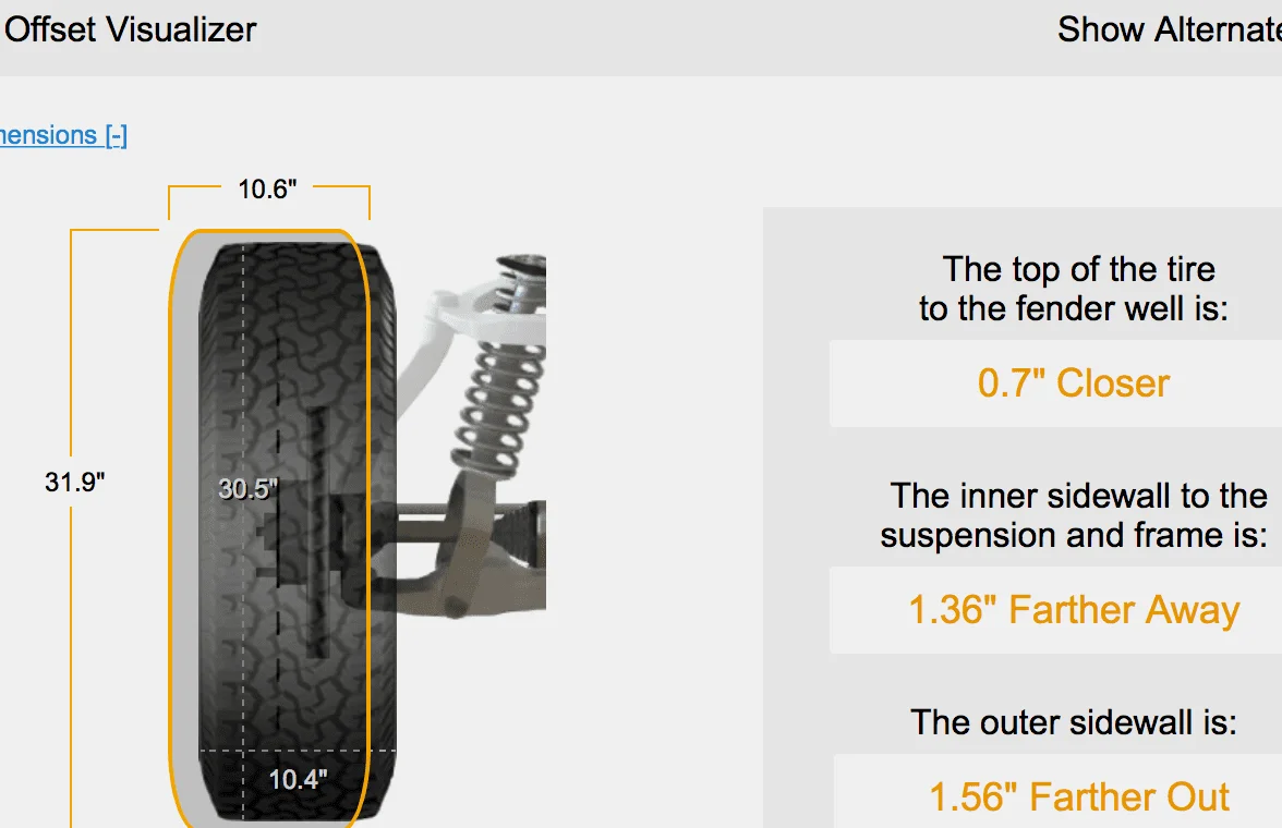

I've been obsessing over wheels for months, have collected hundreds of GX and 4runner wheel pics, and finally found a wheel that I really like. Problem is it's 9" wide with -12 offset, and I've got a 2" lift and want to run 265/70/R17 so I can keep the spare in the stock spare well. Any salty GX'ers care to lend me your advice as to (1) how much rubbing I should expect (2) is there a real downside to a 9" rim and a 265 tire, and (3) should I just let go and find another wheel even though this one completes me, fills a hole in my heart, and is sure to help me reach my full potential as a human being? I've attached pics of the wheel and also a tire calculator comparison between the OEM and the proposed new wheel/tire combo.

First off, I suggest you call GX'ers Anonymous at 555-GXADDICT. They will be able to help you recover if you can't get those wheels.
Secondly, just speaking off-road, a narrower wheel helps keep a tire from popping a bead off the rim when aired down to less than 15 psi. A wider rim will be more incline to blow a tire bead off the rim when aired that low.
Not sure how it'll look but try to avoid the bulging sidewalls. Not safe, not attractive.
Suggestion, how about a sightly wider, smaller O.D. tire? It'll fill the rim, less chance of rubbing and for sure it'll still fit in the stock spare location!

Thanks, I'll look into going wider. That said, I was hoping to keep the tire to 265 as I assume the increased contact patch/friction of a 275 will drive the fuel efficiency down a bit. I want it all!
My 0.02 a 10” tire on a 9” rim will be fine for 99% of your travels...but yeah don’t get excited about airing it down much.
I would stick with 7 or 7.5 inch wheels for these tires. I’m running 8 inch wheel with 315 on my 80 and I know people who even used 7.5 inch wheels with 37s with no issues. 10 inch tires might be too narrow for a 9 inch wheel, check manufacturer specs. Might work if your definition or airing down is 25psi

FWIW. I have Venomrex VR602 in graphite. 17x9, -12mm fitted 265/70/17 P-Metric Wildpeaks, stock height. Took me about 30 minutes of heat gun and massaging the plastic wheel well cover, no cutting. slight rub reversing at full lock only. I regularly air down to 18 and sometimes to 15psi with no issues.
2016 GX460.
