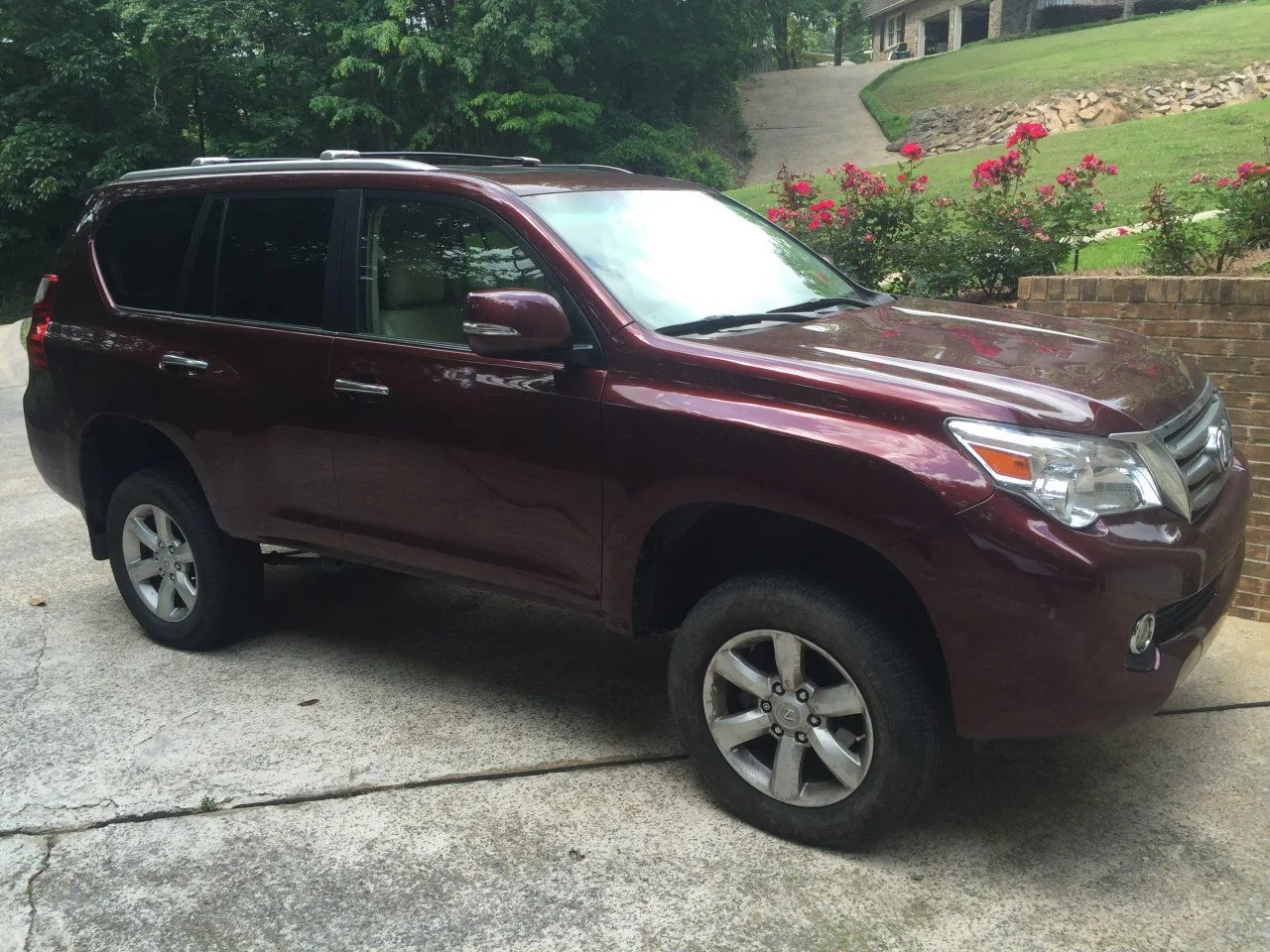

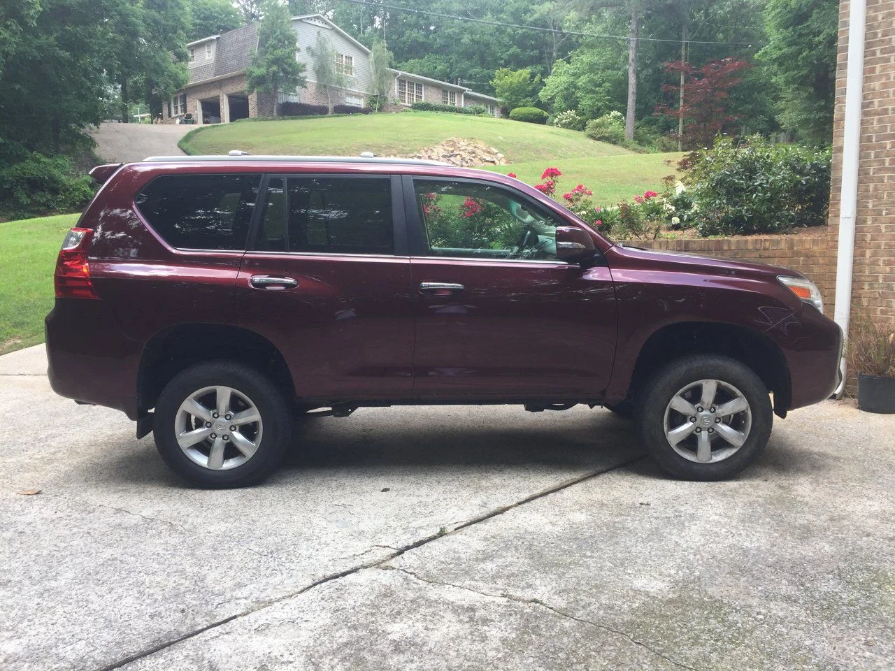

I think its about time we have a pic thread of our vehicles on here. Here is mine, 2010 gx 460 with the running boards off and then shortly after OME 3" Lift. Im waiting on these tires to run their time and then i will be adding some BFG KO2s

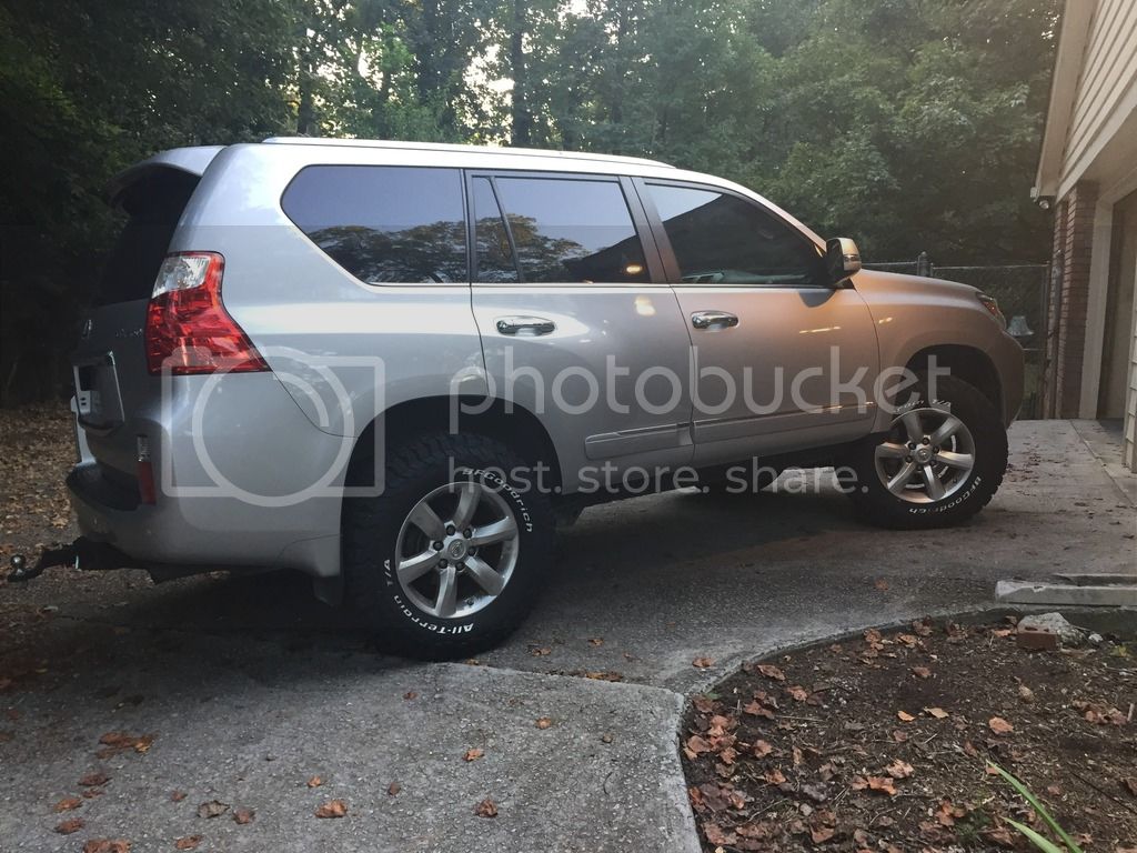

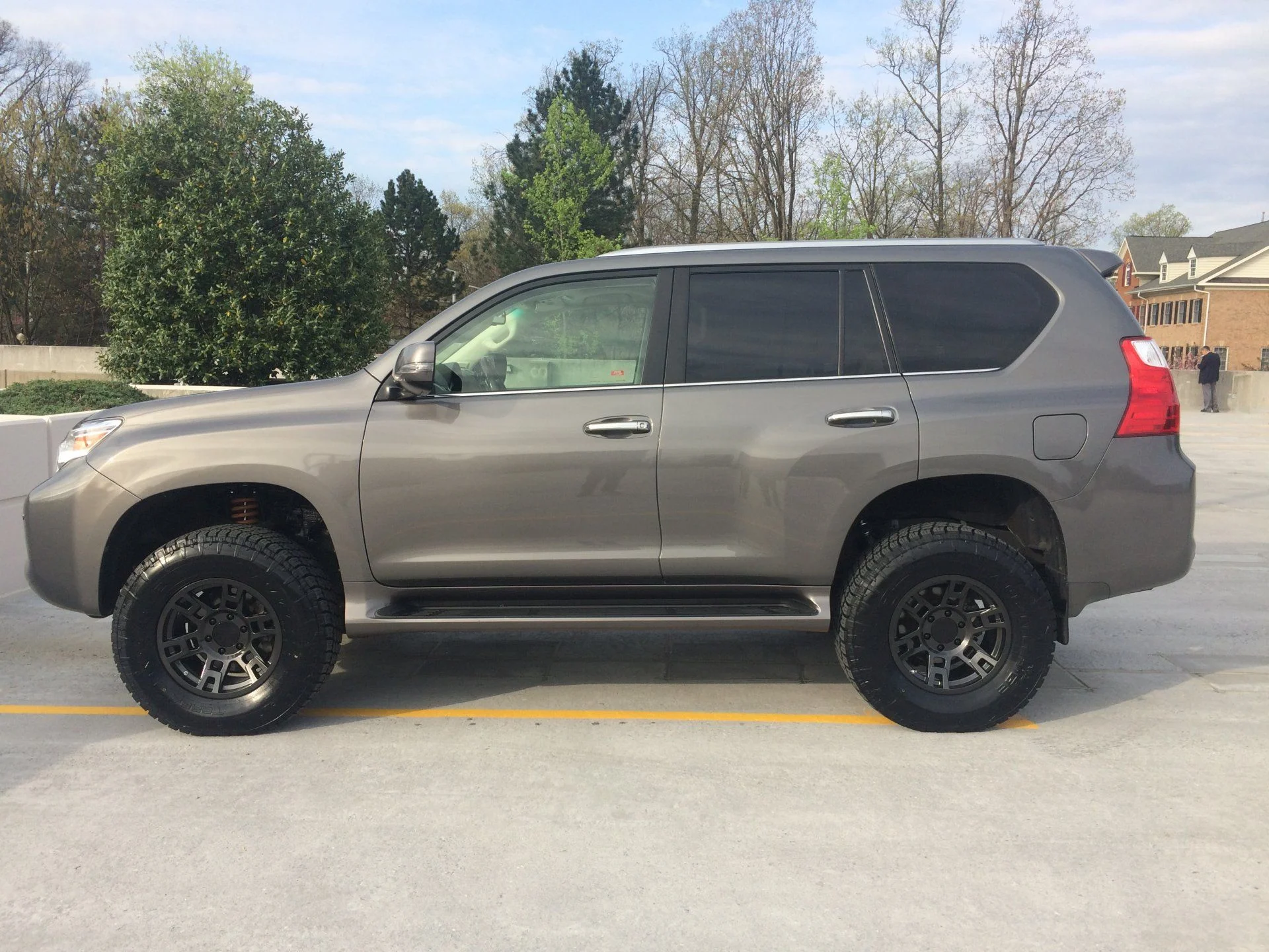

Here's mine as of today. 2013 GX460 Base with Bilstein 5100's set at the first notch which netted a full inch of lift. Just installed a set of 275/70r18 KO2s. A smidgen of rubbing at full lock in reverse, but nothing a few zip ties couldn't handle. Haven't been able to flex the suspension out yet, but so far no rubbing on the UCA.
Planning on installing OPOR sliders and OME spacer to raise the rear up slightly as I have about 1/8" of negative rake.

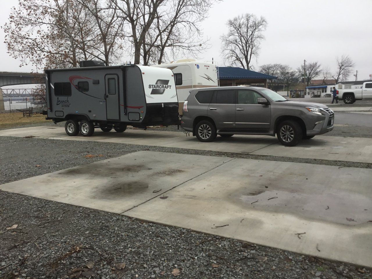

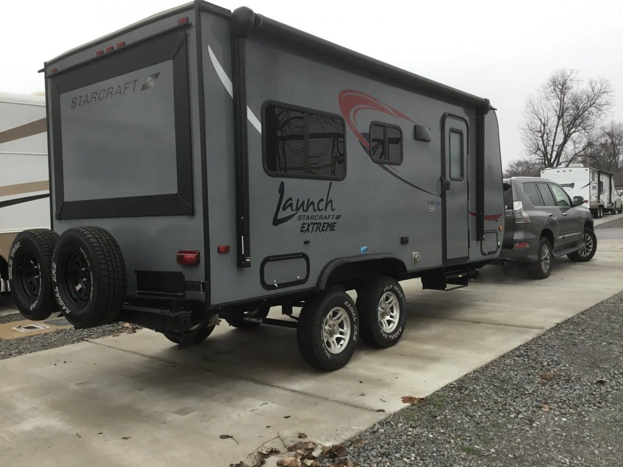

that gray GX above with the travel trailer is a 2014 Luxury with the air suspension. The trailer is just under 5000 pounds so I do not use a weight distribution hitch. The air suspension levels out the GX and it pulls fine up to 60 mph, would probably go faster but I have no need to try. I have to use a 6 inch drop hitch turned upside down to get up to the height to keep the trailer level as the GX hitch is very low and trailer has a lift kit. I installed a Tekonsha 3 brake controller using the supplied brake wiring adaptor from Lexus and it works flawlessly. Brake controller is mounted near left knee to avoid the knee air bags on right side. I get 11.5 mpg while highway towing.

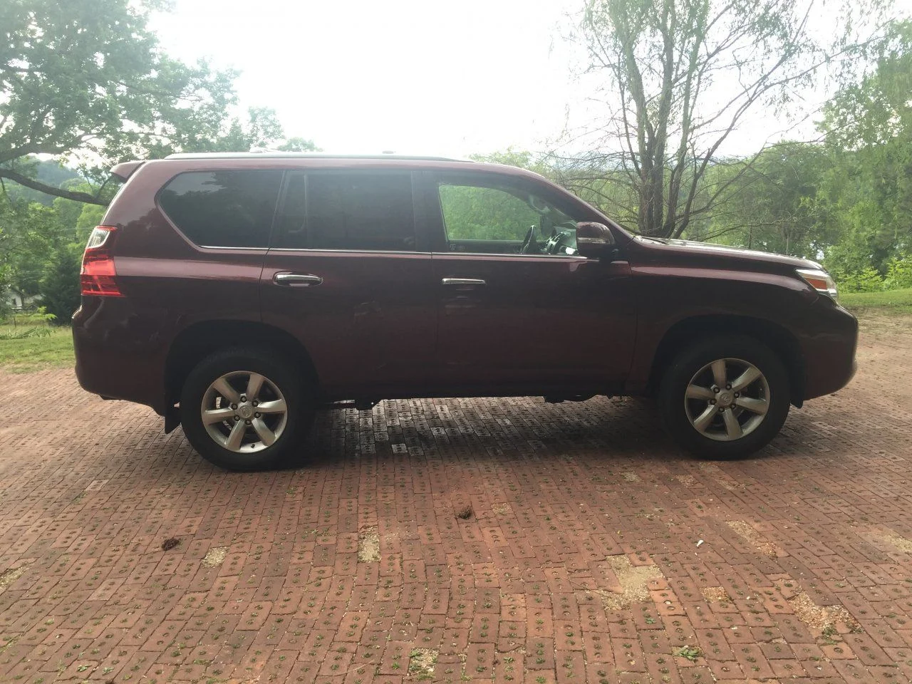

Got my tires mounted up this past week. I went with a set of the General Grabber AT2s in 265/70R18s. I purposely went with a P-metric tire to help preserve as much ride quality as I could. I have some very minor rubbing on the fender liner. Shocks and small lift are coming up next. Making progress!
