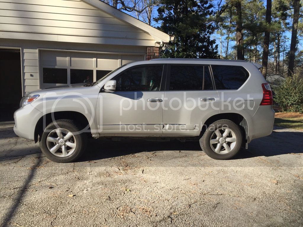

Looks good! How is the ride with the Bilsteins?

Feels close to stock with less nose diving when stepping on the brakes. It's not jarring over bumps either which is why I didn't want spacers.

That Mule GX just looks lifted because the side steps are taken off. I'm considering taking mine off and putting some sliders on.
I pulled my running boards as soon as I got home. A set of rocky road outfitters sliders will be going on. An ih8mud member has them bolted up to his GX460. I think they used his truck for the website GX460 pic.

The GX looks so much better without the side steps. I'm still considering a set of sliders, but am searching for Prado rocker panels so I won't have to cut the original side steps.
I did some light off-roading the other day and was glad I took the side steps off! I definately am looking hard at new tires, the Bridgestones don't do too well off-road. The biggest clearance issue I had with anything was the rear bumper, but more specifically with the towing package. The hitch receiver just sits too damn low! Might be considering a bull bar and tire carrier after all......
