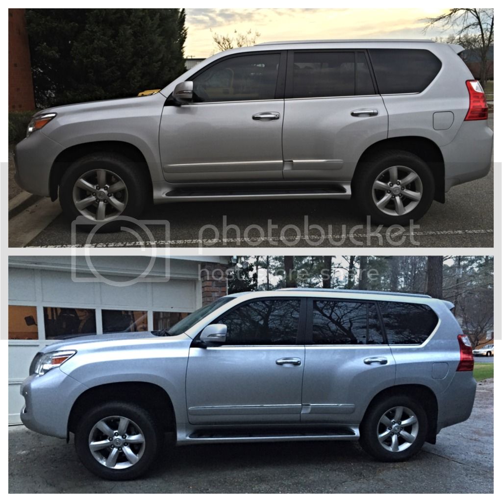

I just had the adjustible Bilstein 5100's installed on the front of my GX460. I ended up going with the second notch from the bottom (0.85" of lift) and it netted almost 1.25" of lift. I didn't want to go really big on the GX, just wanted a more level look as it's my daily driver and the fiance is only 5'. She has a hard enough time getting into my CJ5 on 33's. Spacers would have been the cheapest option, but wanted to keep ride as close to stock as possible. When my crappy Bridgestone tires need replacing I'll be put on the biggest tire I can fit without major trimming and/or rubbing.
Before and After
Before:
After:
Before and After
Before:
After:
I am not entirely familiar with the intricacies of the Bilsteins or OME. Any reason you went for the former rather than the latter? Also, any thoughts on the tires after the Bridgestones?
The only reason I went with the Bilstein's was because the price (paid like $150ish for them off jet.com with 15% off for new members). They are adjustable from 0, 0.85, 1.75, & 2.5", so down the road if I want more lift I can. OME makes some great stuff, just didn't want a full lift on all 4 corners. I was just trying to get rid of the rake and level the front end.
As for tires, I haven't decided yet, just know that I want a more aggresive tread than the Bridgestones. I also don't know what size I'll be able to fit with the front lifted. Stock you can fit 275/65r18, so hopefully I'll be able to fit 275/70r18.
