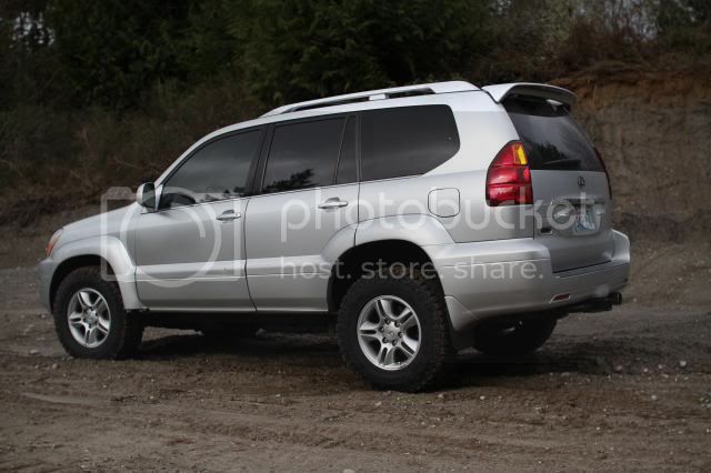

Well, since I couldn't get any input from anyone, I went ahead and ordered the 5100s for the front and did the airbag trick in the back. Struts should be here today so I can match the front to the lift that I have already done to the rear. I also emailed Slee about a lift, but they waited 8 days to reply (I had already ordered the 5100s by then).

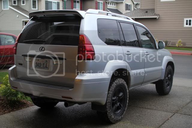

I have also debadged the rear, plasi-dipped any remaining chrome black, Plasti-dipped the wheels black, installed new pads and rotors on the front, put on some 265/70/17 DuraTracs, and got a bike rack for the back hitch. I have some vinyl on order to de-wood trim the interior also.

Yep, that front needs a lift to match the rear!
Earlier that same day, before I painted the wheels and the chrome thingie above the licence plate in back.
Looking Good! You HAVE been busy.
The black wheels do give your truck a more bad@ss attitude.
Looks good, any pics of the rear? I also have a silver GX and plastidipped my grille black, but I haven't done the chrome strip on the back yet.
Here is the rear, not a great picture, but it shows the black strip. I found it to be really easy to tape it off (I used blue painter's tape) but I had troubles when taking the tape off without pealing the paint off the strip for the first bit. The paint likes to stick to the tape, so when you pull off the tape, it wants to take the paint with it. I have a few spots on the top left of the strip that show a tiny bit of chrome below for about 1/16" or so. I found that you can scribe it carefully with a razor to break the seal between the paint on the tape and the paint on the strip. That worked a lot better. Of course, it comes off really easily if you don't like it.
