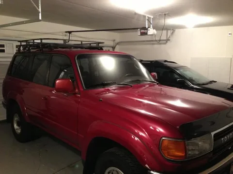

Did you get any resolution? I built a full length rack with gutter mounts and have zero clearance issues. The rack sits 1.250" above the highest part of the roof.

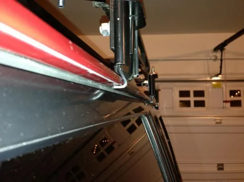

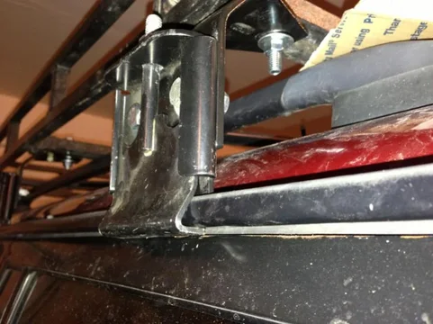

Ok, received the mounts today and attempted the install this evening and I still have the same problem - the clamp gets in the way of the door. In addition, I can't get half of the locking portions of he clamps on at all. I will let the pics do most of the explaining.

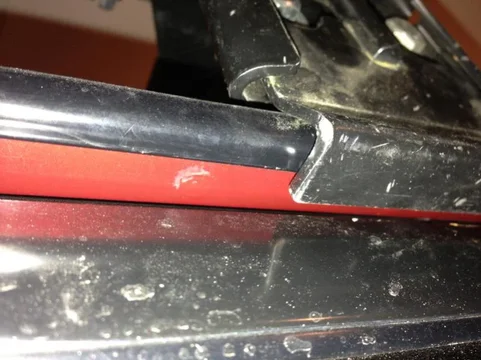

Do you have to remove the plastic/rubber that covers the gutter? I am at a loss here. Help again!
The first two are pics of the door problem. The third is of one of the clamps that I can't attach at all.
Question: Have your rear doors ever been removed/swapped? Has your rig ever been in an accident? For some reason, the gap between the bottom of the rain gutter and the top of the doors appears less than it should be to me. Perhaps the doors aren't aligned quite right and are sitting higher in the opening that they should. Just a thought....
Well, I finally went ahead and removed the rubber that covers the gutters. That solved the door issue and the rack is on.
