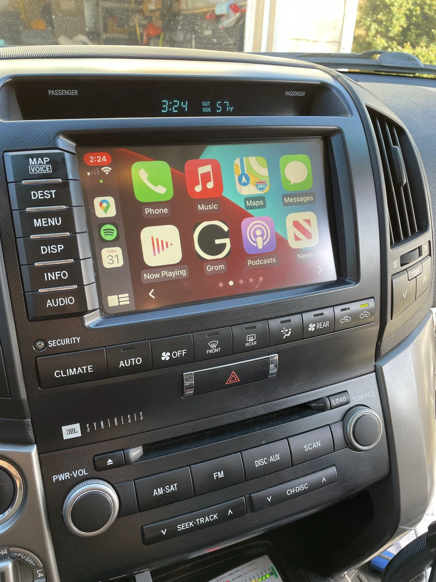

Installed and functioning. Need to give it a drive test but ran through paces. Apple Car Play (wired and wireless) working as expected. Audio quality on par with factory systems. Operationally the unit is quick as it needs to be. Factory resistive screen is the limiter.

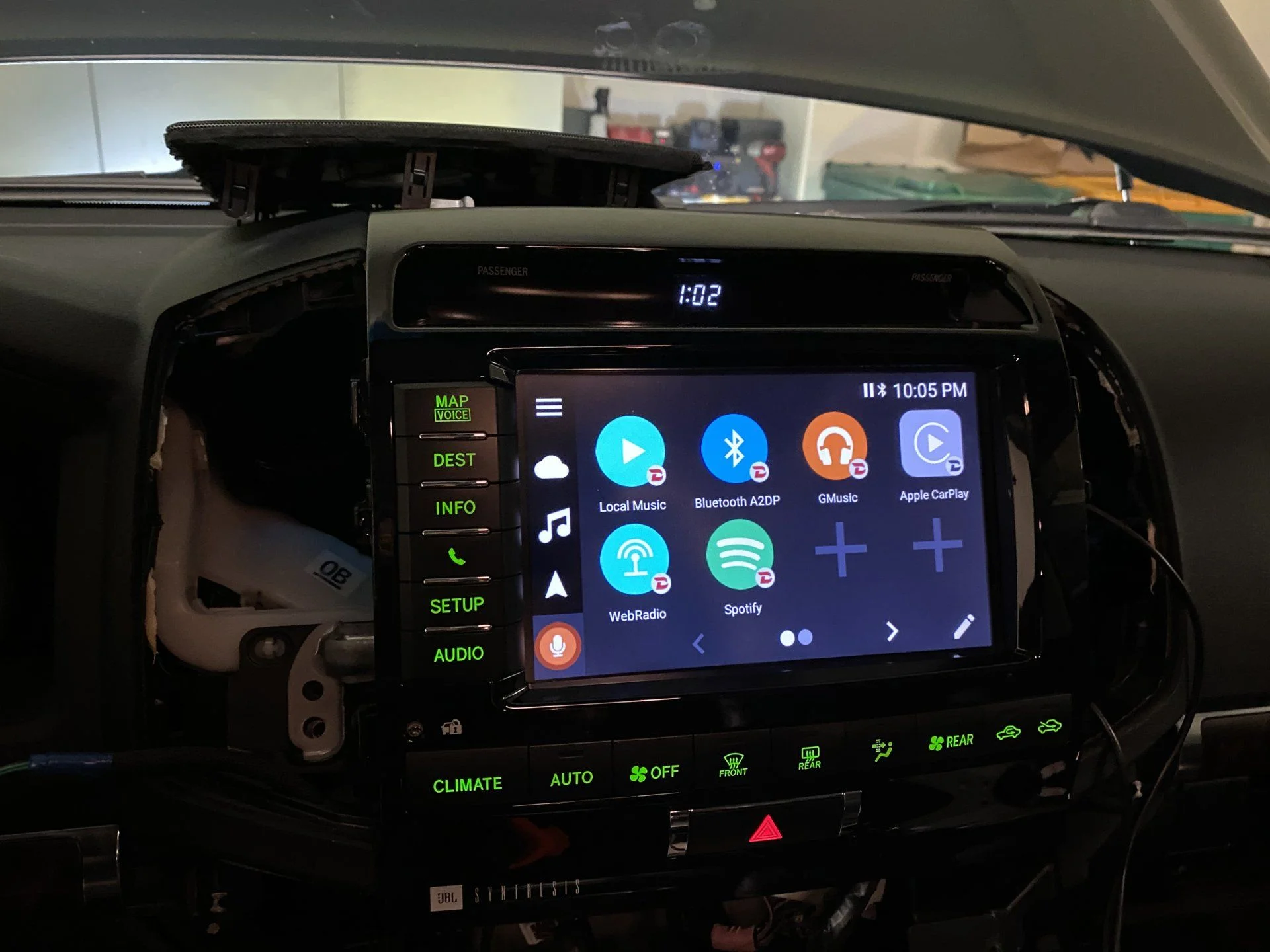

On my 2008 USDM LC, the installation was pretty smooth. Everything was straightforward and didn't require any soldering or splicing. Mounted the unit under the glove compartment.
