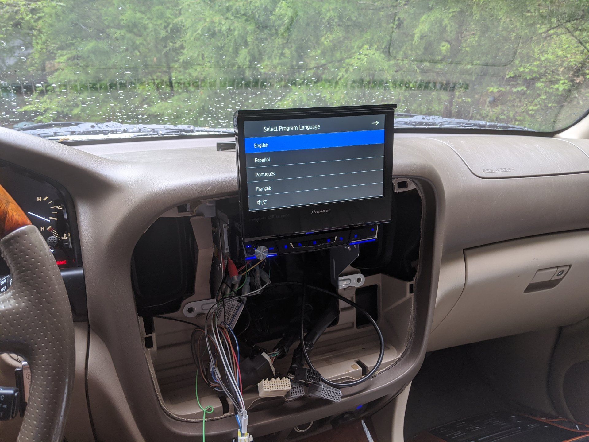

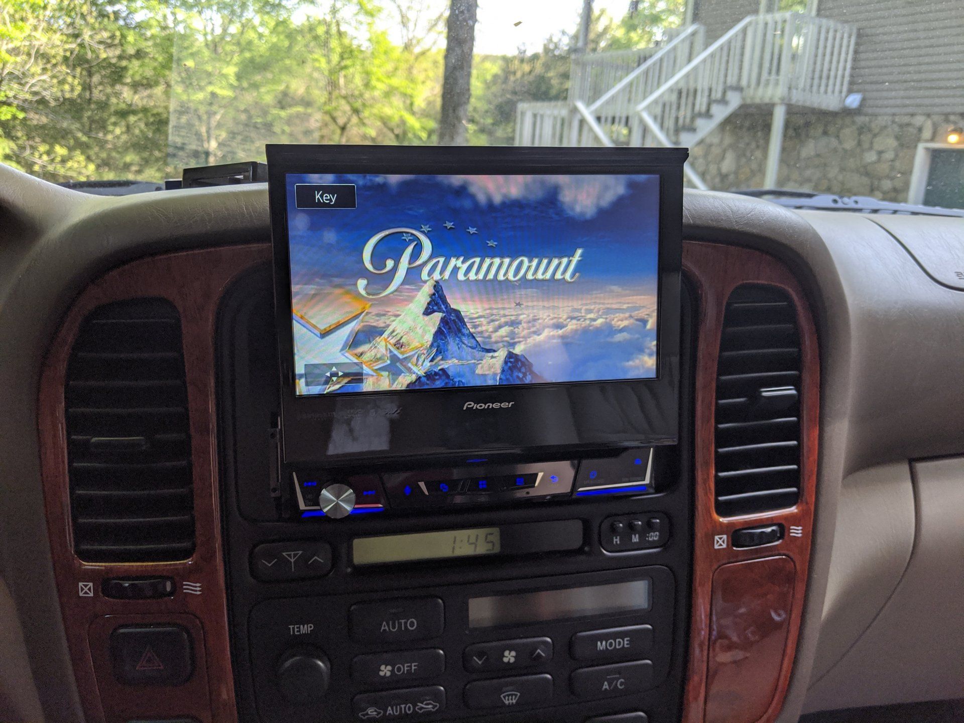

Thought I would chime back in for anyone in the future that runs across this thread searching for the same answers as I was. The GROM did not work at all due to the ML system. I ended up not going with the AUX and decided to go with a plug and play head unit with Android Auto. I used the Beat-Sonic SLX-82AAD harness and the single DIN Pioneer AVH3500NEX flip out head unit. The reason I went with this is the 01's don't have the steering wheel volume control and I knew it would drive me nuts to have to look/reach for the volume buttons whether they were capacitive or actual. The 3500NEX is the only AA unit with a volume knob besides the ~5yr old Sony which has a worse screen and out of date software. I refoamed all the speakers to help save on the cost and used a universal double DIN radio pocket to fill the gap. After testing it in both slots I liked the lower slow better as it looks a little cleaner to me and is easier to reach everything with my elbow resting on the center console/armrest, as well as with a hand resting on the dash and using my thumb to click on the screen. I added a USB extension flush mount in between the two factory cigarette lighters. I also changed out one of them to a USB-C/USB charger that shows the battery voltage as well. The Pioneer does stick out a bit from the side, but it doesn't bother me at all. I used a pioneer parking brake bypass off Amazon since the Pioneer units look for a on/off/on pulse for the DVD to work. I didn't realize until after I ordered it that I could have just grounded the parking brake and had access to all the features except the DVD player. So if I did it again I would have just grounded it and been done with it.
All in all I'm very happy with it and glad I spent the extra money for it versus cheaping out with the AUX and phone mount route. The audio quality is great and the speaker re-foam was a bit tedious but worth it in the end. I had one speaker with metal shrapnel behind the coil that I spent a good few hours with scotch tape getting all of it out so it didn't make the metal on metal scratching noise when pushing the coil in/out to center it.
