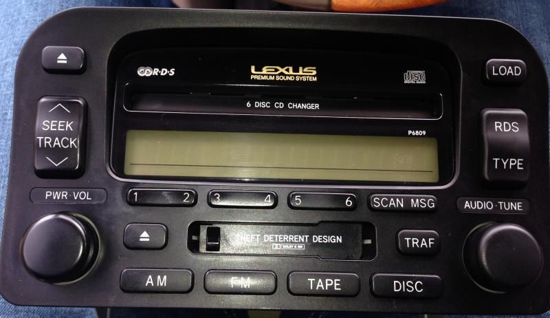

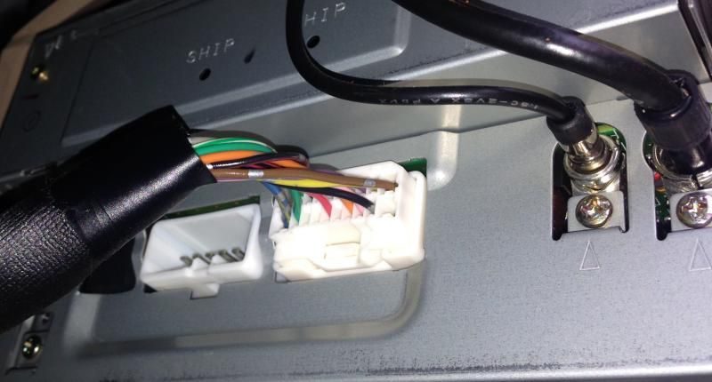

Hey all - I'm going to bring this back up b/c I'm having problems with this even though it should be pretty straight forward. I can't tell if it's user error or if the Grom that got shipped to me is defective. I have an 01 Lexus LX 470 with the Mark Levinson package with NO navigation. So I took the radio out, and noticed only 1 wiring harness is plugged into the back of the radio. Is that standard? If so, I plugged in the wire that goes from the GROM unit to the back of the radio. Turn on the radio and try to hit "Disc", and nothing happens. This is all while the radio stations that usually work, is very staticky and I can't really hear the music even when I know those stations worked before. I unplug the unit and the radio works perfectly. So after I kept getting the same results with nothing happening when I press "Disc", I saw something about using a jumper and installing it on the GROM unit if the unit doesn't correctly connect. I tried that and once I plugged everything together, the radio was still working so I thought that was an achievement, but when I pressed "Disc", again, nothing happened. What am I doing wrong?
Here is the radio and back of what I have.
Bringing this back from the absolute dead because I'm in the same boat currently. Stock 2001 LX470, GROM-AUX1 TOYOA1 kit, non-Nav, non-Nakamichi, Mark Levinson system. Just got done installing it into the spare port on the back of the head unit and cannot get it to see the GROM at all, just plays the CD as normal. Also installed the jumper pin and tried it that way and same thing. I shut off the ignition a handful of times in every scenario and it's the same, just plays the CD like normal. I've contacted GROM support so I'll see what they say and update this thread off that. I know I've wasted enough time searching this forum for someone having this exact same problem so hopefully this helps someone in the future should I get it to work.

Head unit made by Pioneer correct? Won't work. I went back and forth with GROM about their BT3 unit two months ago. I guess they still won't disclose their units won't work with the Pioneer made ML head units with the in-dash CD changer. Mine is an 01 too. Get a refund.
Yeah says Pioneer on the bottom sticker on the cage. That's a bummer, I swore I read about people using the BT3 with the ML non-nav 01/02 before but maybe I've been wrong. Their 03 LX470 harness looks like it matches the factory radio harness that powers mine. Wonder if that along with the Y-connector plugged in would work and just disable the CD player?
