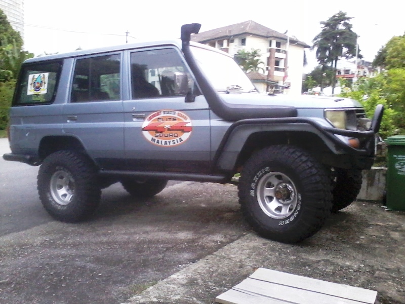

Finally after 2 years I have put a rear bumper on GREEN (yes its still blue thats next).
Next is the paint job back to and a twin motor for the 8274 winch and a Rear locker.
The new sneakers 35" look good I have moved away from XT tires - it was a challenge given to me "bet you cannot drive in the jungle on MT tires".
Story of last trip coming.

35" MT look pretty!
Poor Green has had a lot of work recently
Radiator went - so new custom made radiator (4 core) , new air conditioning,
Then last monday day after the cycle trip took it for a 120k run down to get RED's AMADA shocks repaired. You guessed it it overheated. Turns out they did not put fluid in the clutch fan or coolant only water. Now all done this week.
Bonnet sound proofing has fallen off now need to replace that. Next is a paint job back to bright green and a locking rear diff and a twin motor 8274 upgrade.
