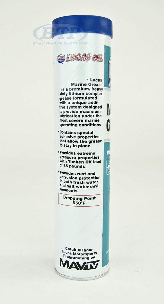

This may sound crazy but you could always machine the yellow OME bushes to suit o-rings and that way you could fill the whole assemble with marine type bearing grease. :)
Ummmmm, I am not familiar with the benefits of marine grease. It stays where you put it longer?
That's a good observation. Lucas marine grease is lithium based, that's what I typically use.
