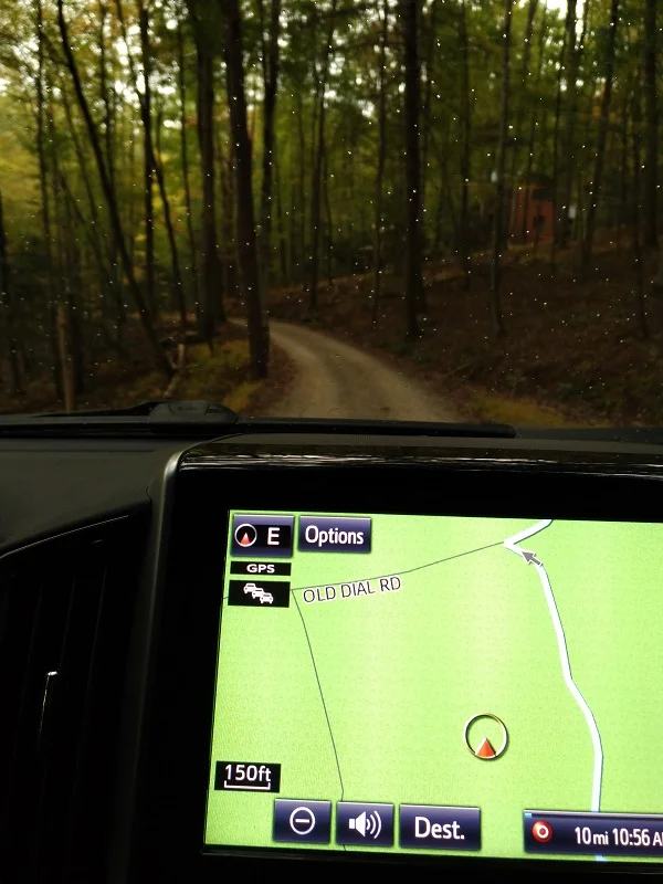

This is a fine example, I'm traveling down the road on the right.

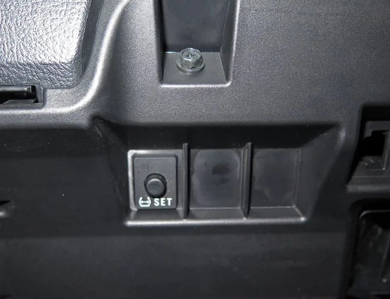

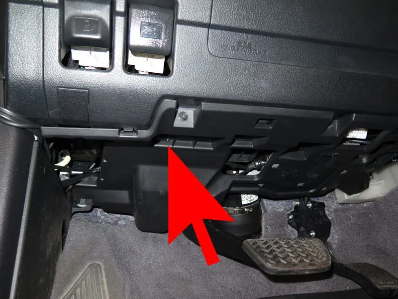

Check page 484 in your Owner's Manual - check around under the dash and you'll find the physical button:
HTH
That button I use when I lower the tire pressure or inflate the tires.
