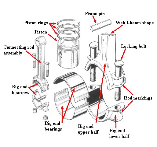

Forgive my ignorance but what does BEB's refer to?
I believe it is bottom end bearing. The JDM 80 guys will tell you to get it done if it hasn't been. From what I have heard the 1994 and newer did not have that problem.
Nope big end bearing is the correct term but IMO it is more of a connecting rod bushing than a bearing. But what do I know, I have drive a Safari. :rolleyes:

BEB = major motor work. What is the problem with these? Can this job be done thru the oil pan or is it a remove engine kind of thing? Also, is this just an 80 series thing?
It is just a 1HT engine thing. It is not a major job from what I have read. Either it is a few hundred $ or a DIY. Yes, you can do it through the oil pan.
I would not shy away from the 81 Cruisers with a 1HT because of it. Its just something you know you should do at 100,000 kms with the origonal BEB and to inspect every 100,000 km.
The BEB job is not that big of a deal. I did it myself in the driveway in an afternoon. I described the job in a thread in the Diesel/24v section here on Mud several months ago. Got the parts from Sheldon at G&S, let the truck sit overnight so all the oil would be in the pan, and went at it!
