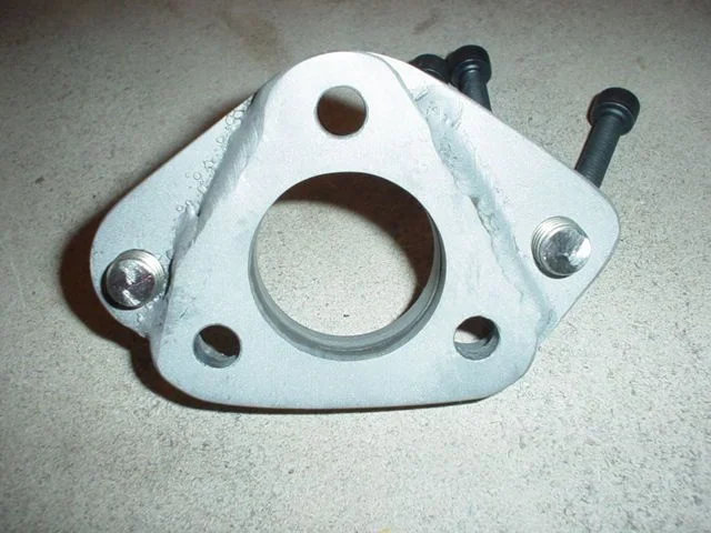

Could you give me some more info about the corvette mc swap? I was leaning toward a s10 mc on my '70 40 to save room. i'd like to see how the adapter plate bolts in and how the push rod fits. Also, how do you like it? Is the manual much of a PITA over a boostered one? Thanks again, ty
300 bucks....I must have been terribly bad in a previous life. Please Cruiser Gods smile upon me. All kidding aside..you've really made a difference. I, too am interested in learning more about the Corvette MC.........:cheers:dave
Jack, I have been following your build as well. Very nice job. I dont need no speed. Gets me in trouble.
Same deal though, just lookiong for a mild wheeler. I am not putting any lockers in any time soon, Just going to let the gearing and tires get me around for a while. Would like leectric lockers front and rear down the road.
On the corvette master swap. I used my old Clutch pushrod. extended it roughly an inch and made a very pain in the but adapter like Degnol did. 4 hours to make it but it makes the master go on oh so nice. Seen hereCant tell you how it works havent driven it yet.

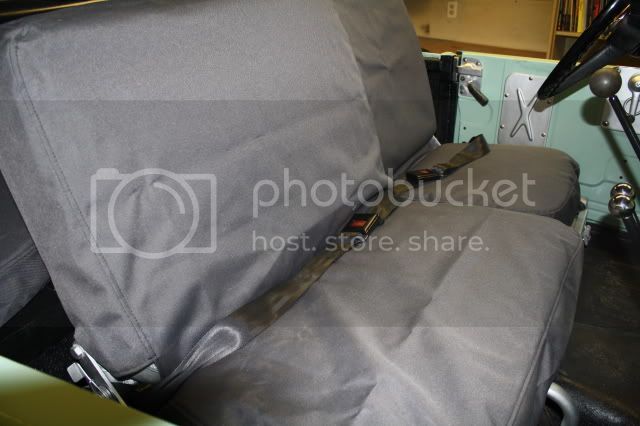

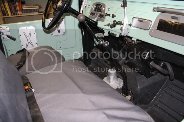

interior

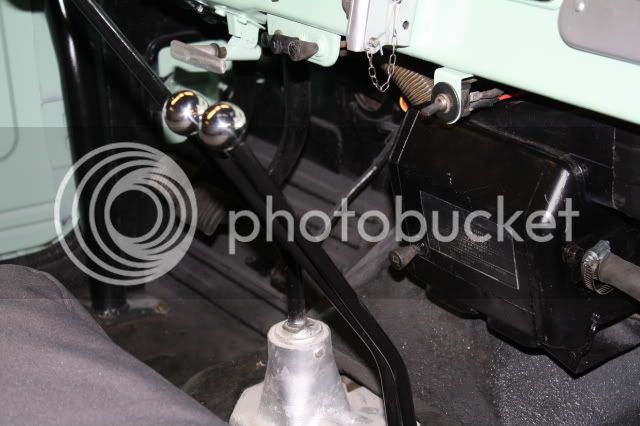

heater box in, twin stick for the dana 300, seats in place, finally some seat belts :lol: only took 3 years.

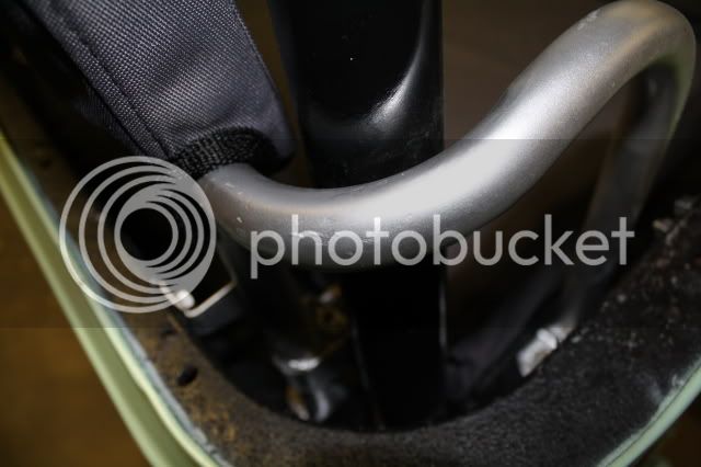

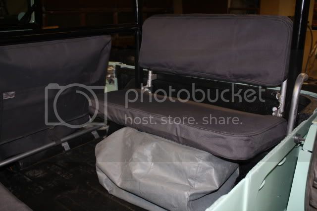

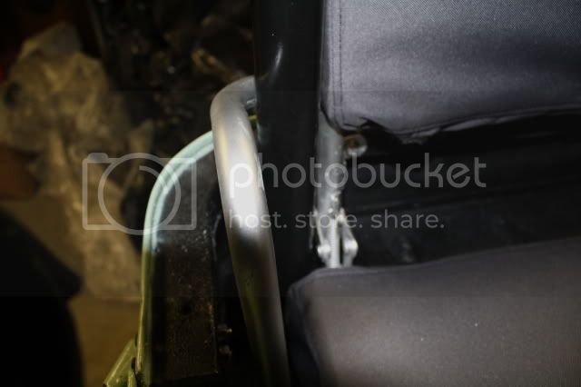

Rear jump seats in, Very tight fit to get stock long jump seats in with a custom full cage. As some of you know, I did it with no mods and used the stock mounting locations.
As you can see I squeezed the rear bar in between the arm rest and the cushion. Fits like a glove.

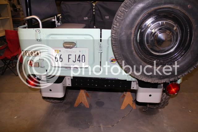

Hub caps on

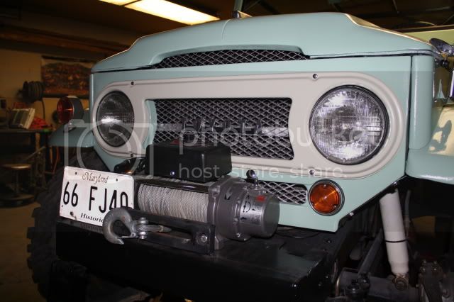

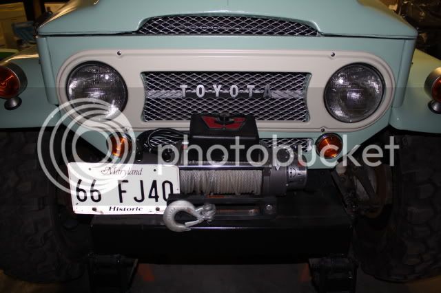

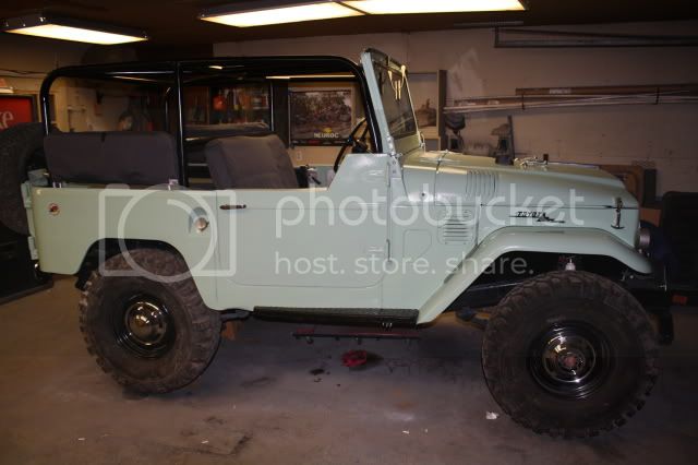

overall
Over all I am very pleased. Can't sweat the little things. It is worlds better than before.
As long as it gets it down the road I will call it a success.
