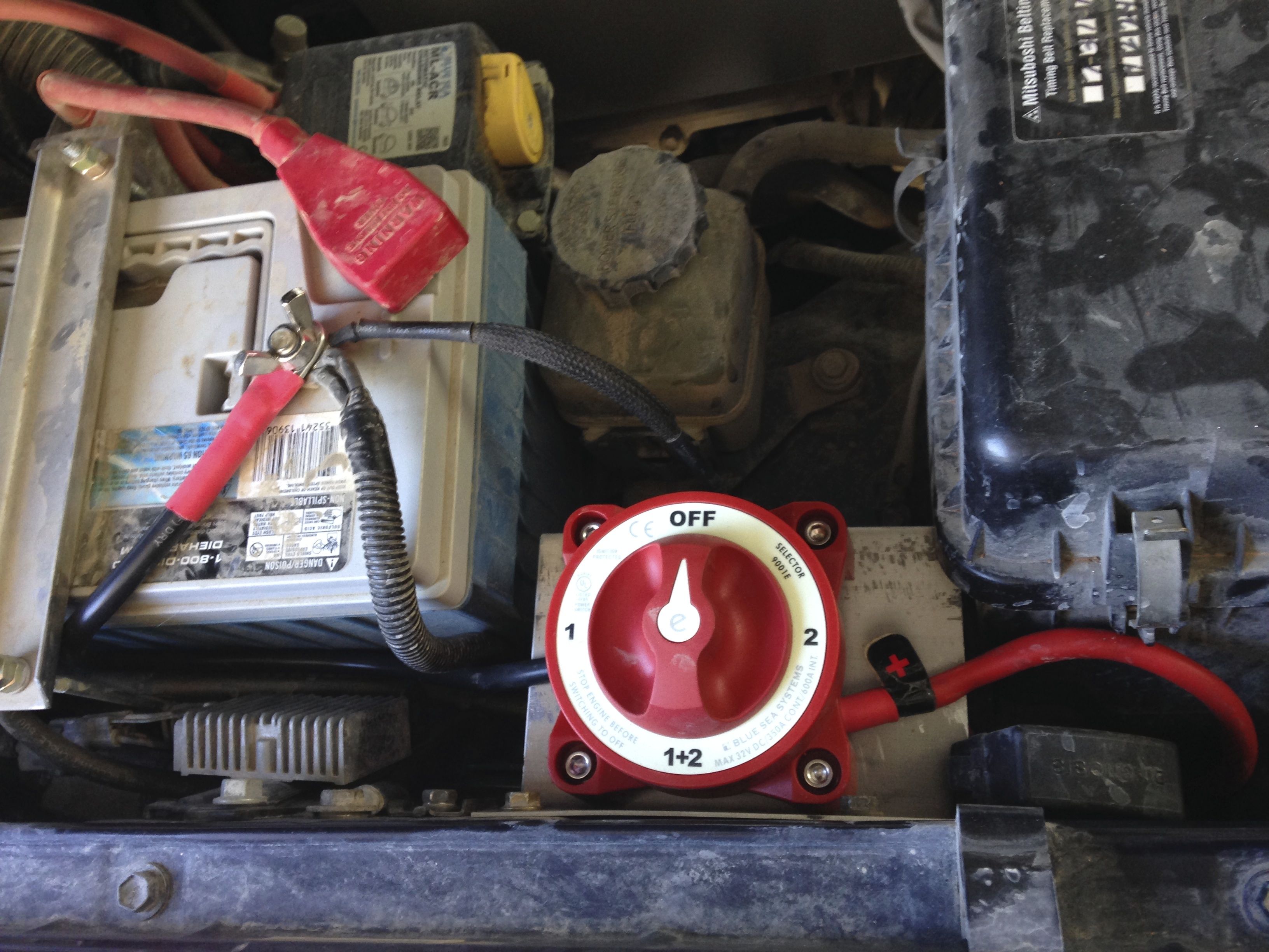

Or, could you use one of these big switches to completely bypass the battery isolator and combine your batteries manually (I'm using mine to isolate power to my winch)?
