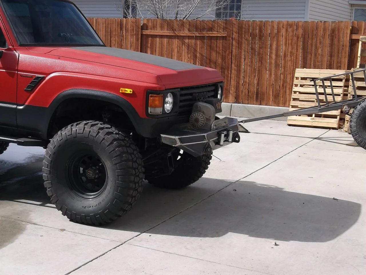

About that trailer... I like it. What sort of axle is best to use for something like this? And will you run shocks on it? Sorry if you have mentioned that before, but this thread is of epic length.
Just got finished talking with my guy. He said it would be another week on the product. He has another box of goodies headed to him today or tomorrow for R&D. @beno and @sschruff got me thinking on that box of goodies...
I built my own axle from individual pieces. 3500# components with FJ60 front springs. I plan on using this for more than camping so I beefed it up a little. I would probably take a leaf or two out if just for camping.
Yes, I'll run a pair of shocks. When I weld in my floor runners, I'll get the mounts installed. Then when fully built, I'll rack out the trailer for measurements and order the shocks. Probably OVERKILL, but OH WELL!
etrailer has some nice complete set ups. There are a few online trailer supply places and where you are... there should be PLENTY that you could just walk in and grab things. Shipping on a complete axle set is $$$.
