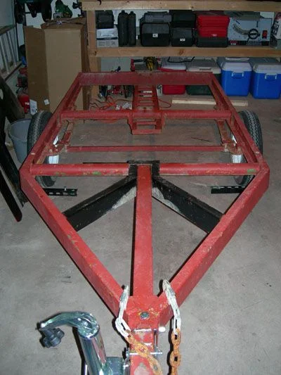

Well I picked this trailer up pretty cheap. It is roughly 4' x 6'.
My intentions are to turn it into a off road type trailer that I can use to haul hunting and camping supplies in.
does this look like a good starting point or platform?
first on the list of mods will be to swap out the axle to a 3500# axle with 6 on 5.5 to match the 4runner and 60.
Just ordered axle from abctrailerparts.com $168.58 shipped to my door! That was 1/2 what the local trailer supply store wanted to charge me!
any draw backs to using angle iron to make frame for box?
I think that is probably the easiest way to go. Just don't go too light.

What did it used to be? Just curious what that piece coming up the center from the back is,, Looks like a great start too.. Once you have a heavier axle in place you'll be set..
Steve
the piece coming up the middle is a motorcycle ramp. the guy I bought it from used it for hauling his dirt bike.

Minimum 1/8" and add some bracing you should be ok. I guess it depends on how big a box and whats going to be in it too. Just my opinion.
1/8" is what I was leaning towards. I know the box will be 4' x 6' but I am still trying to decide how deep to make it.
I have not been able to work on the trailer over the past week. The new axle is suppose to ship out Monday so hopefully I can get it mounted this weekend. I'll post up some pics once it is completed.
while others say don't build to light, I say don't go to heavy. Especially on a homebuilt. You'd be surprised the the strength of 1/8 angle iron and 3/16 angle iron etc.
The box should not be built heavier than the frame. It's all relative. Pick a design and discuss what you want on here. Hopefully some ok advice will come out.
