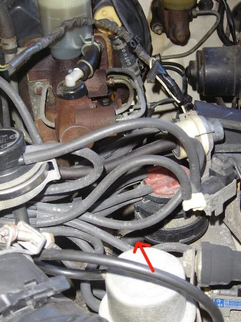

Take a look at this pic
attachment.php
It's the red and black thing on the right side of the pic. Has 4 hoses coming out the top and one large one out the bottom. If you blow into one of the top hoses and air comes out than it its good.
I also need one of the BVSV's. There are 2 of them that are threaded into the thermostat housing with 2 vacuum hoses coming out the top. I need the lower one.
Hey Mark,
I do have it...but, when blowing out of the three (of 4) upper hoses, nothing. If I blow on the lower 4th one, air does come out??? Not sure if it is good then...
