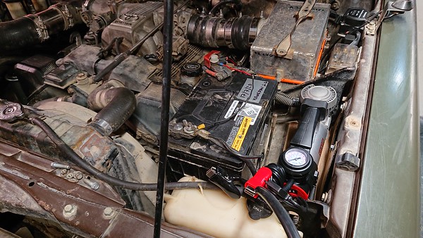

Thanks for the recommendations, I got the Viair 88P & it looks like a good value unit. Decent quality hose & wiring etc too.
It fits in the space beside the battery in an LJ71 nicely, currently making a bracket & will wire it in semi permanently.
It fills one of my 35's from 20-38 psi in 4 min 30 sec, so I'll be able to air all 4 back up no problem within it's 25 minute duty cycle. I don't air down hugely often so happy to trade off some speed for the convenience of having it fit under the hood out of the way.
