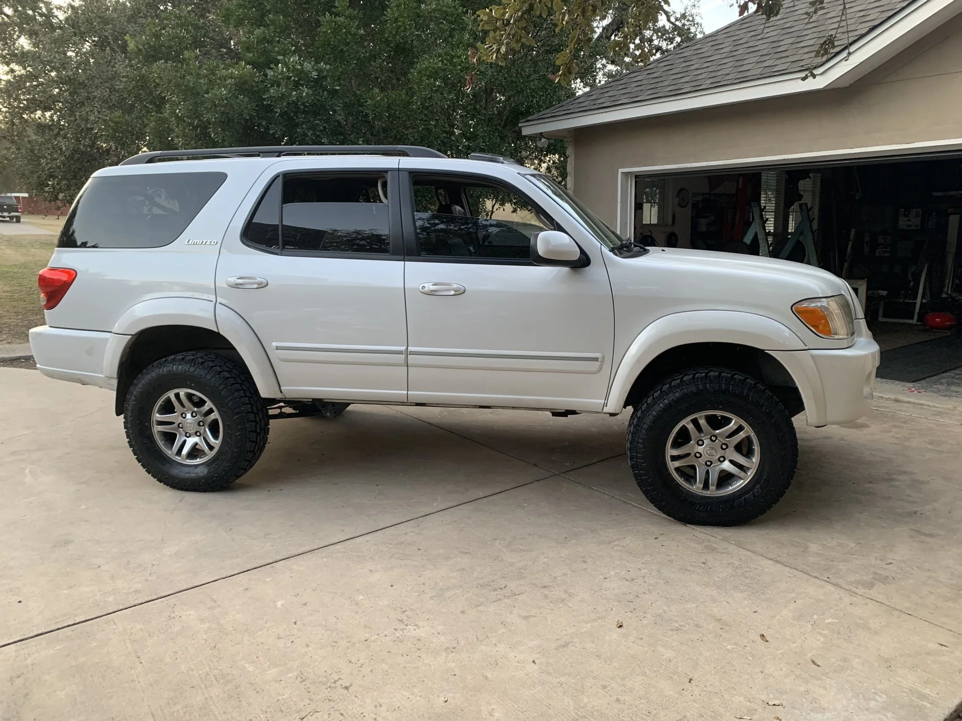

Passenger side rock sliders on. Gonna roll with just this side for a couple weeks while I finish fab on driver side and maybe learn any of the flaws now that I’ve got it in the truck. Biggest disappointment is the color. Got some rust oleum “dark steel” and it’s CRAZY metallic. I wanted something other than black, something closer to my wheel color but this ain’t it. Gonna spray darker gray and add grip tape for final product I think. Good news is I mocked this all up before I had lift and tires and the rear kick out is just barely outside of the tire, so I’m happy with that and the kids can climb in.

Thanks!! Been great so far. Took it out to Kyle seale under the power lines and was about as capable as the LX was. It’s surprising how much more spacious it is on the inside though. Overall very happy. Still not a cruiser…love seeing yours around!

Good luck! Sequoia wasn’t too bad. Does KDSS interfere with anything or is it a separate system from the shocks? It’s separate I think? Gonna look awesome and gain a lot of capability when you do it.
Happy with the 34’s but need to grind the pinch weld slightly to get rid of all rubbing
