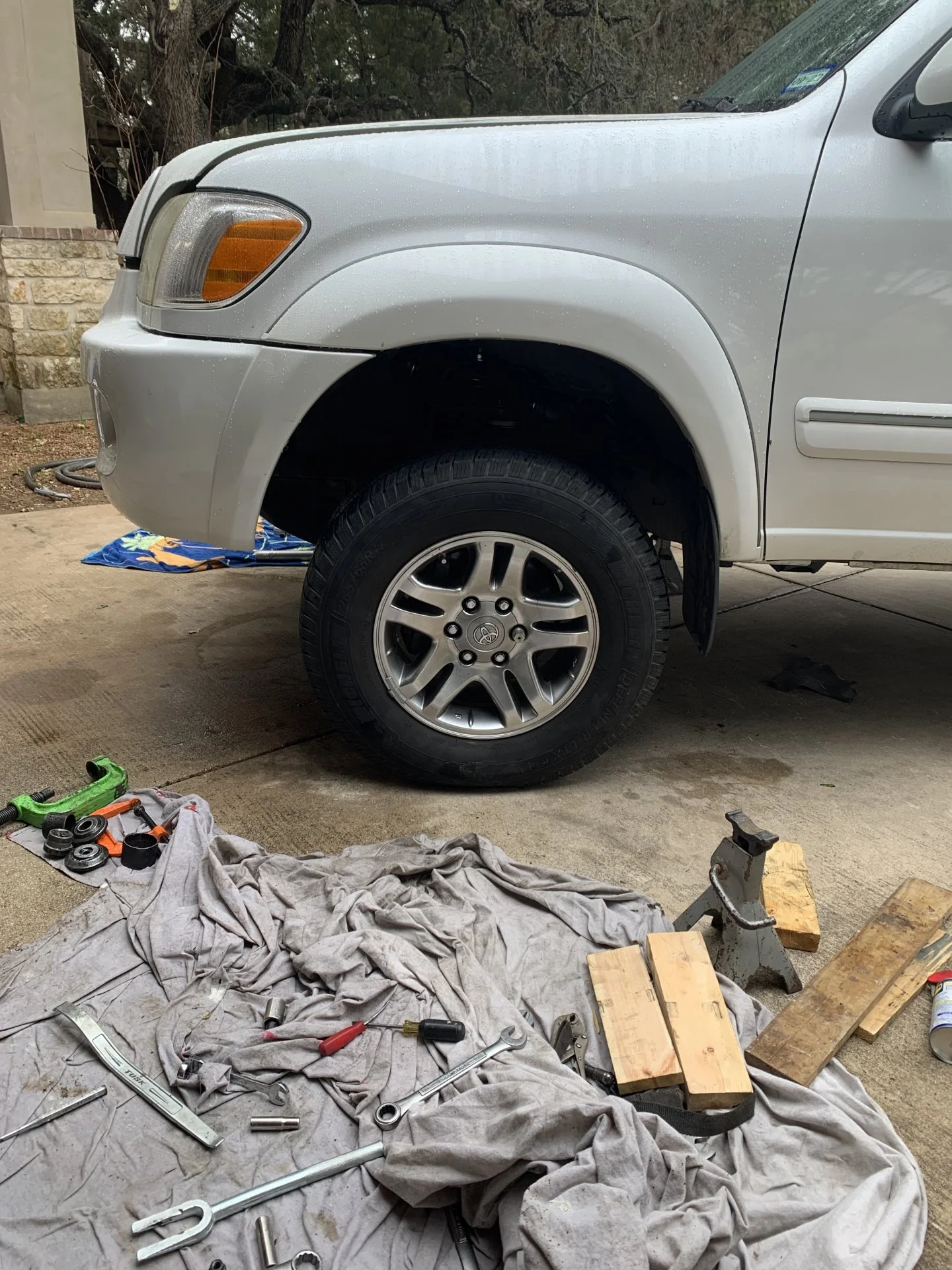

No build yet, planning on the next few weeks. Still struggling with tire sizing. I plan on keeping stock wheels unless a decent pair of used wheels/tires pops up that I like. Is 33 vs 34 that big of a difference in capability? Should I bother doing the extra work of fitting bigger or focus on a solid base lift and 33, then spend the time and money on more important things like a locker in the future? It’s not gonna see a ton of off-road work, I just want the capability to allow me to have some fun when I want.
Edit: I feel like I answered my own question just typing this out. 33’s are way easier to come by, and I could use cheaper UCA’s vs the SPC’s. Probably the best idea at this time.

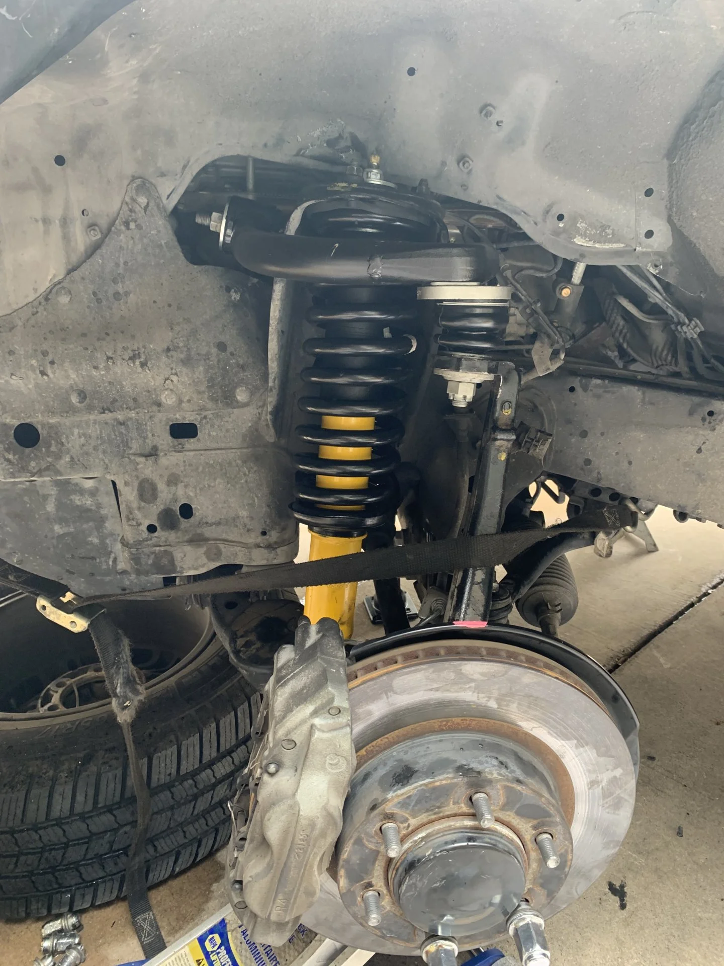

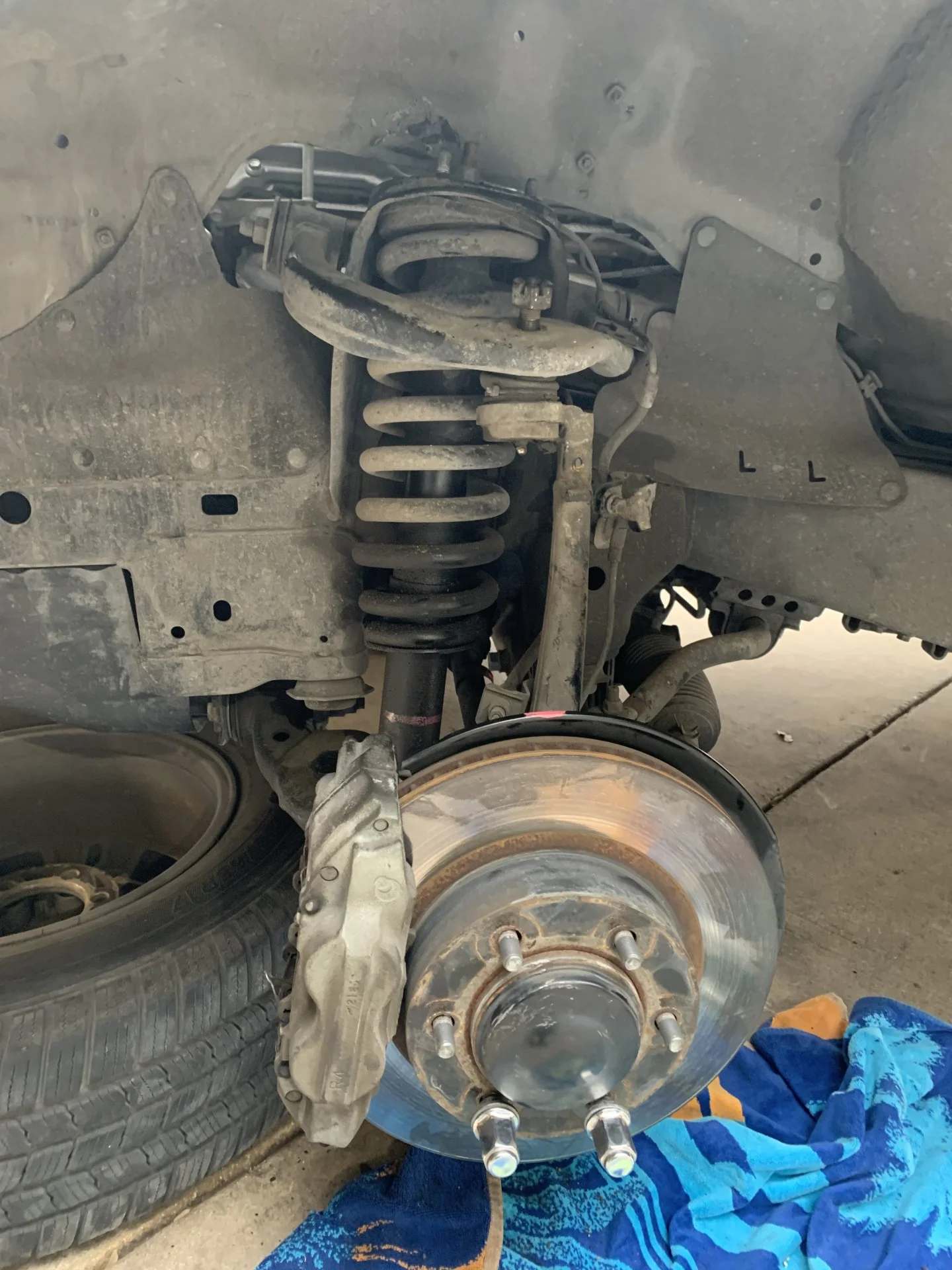

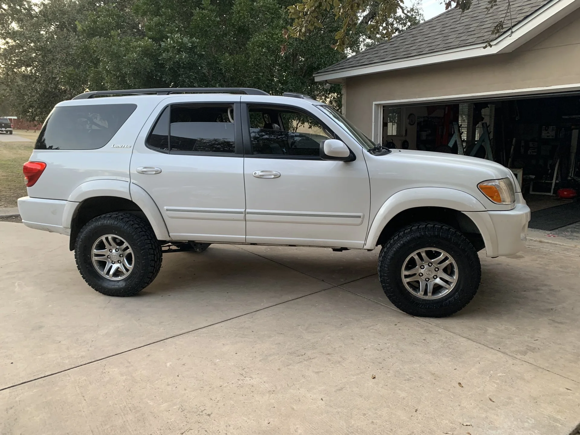

Well, got everything in last weekend but was too busy so I’ve started today. Front done! (pic from before totally buttoned down)Decided to do springs and struts myself but had no luck with the compressor from the auto parts store. Luckily I had access to a shop for using a wall mounted compressor and got it handled quickly. Otherwise everything was pretty straight forward. After doing driver’s side, passenger was quick. Definitely going to work on fitting 285/75/17’s in stock wheels (really like them) with 1.25” spacers from 1stgen. Unfortunately no ko2’s anywhere in country (allegedly) but Discount has Toyo Open Country A/T 2’s in stock and I just don’t know much about them so I’m torn. Doing rear tomorrow and have to swap out air for traditional. Hopefully quicker than doing the fronts!
Looks like a little dejavu, I see you also used the ratchet strap trick for the sway bar end links.

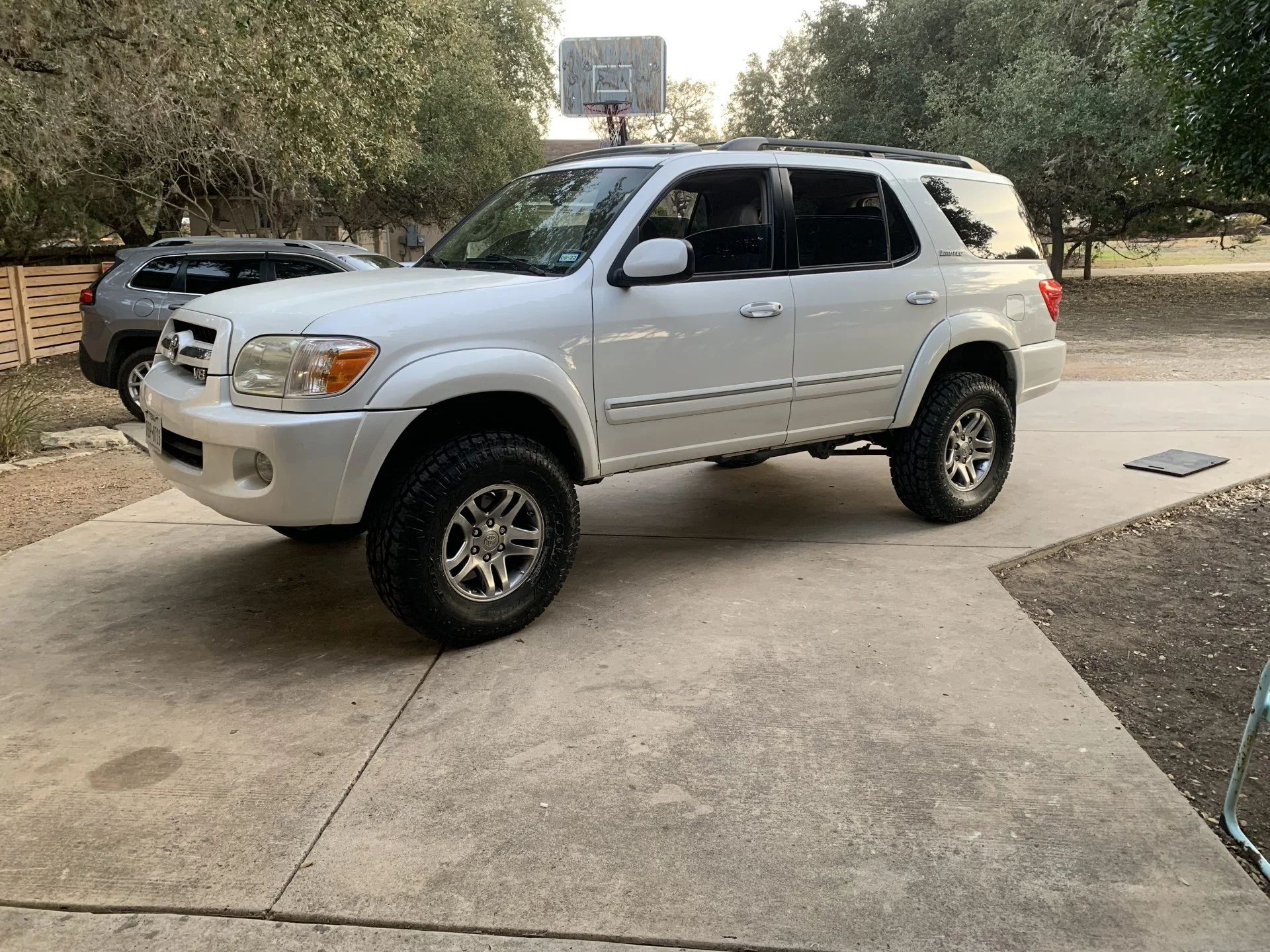

Love your build man! When I talked to Josh over at 1st gen he encouraged me to go SPC for the additional caster if I wanted to go bigger than a 33” tire. I figure might as well spend a couple hundred more now to allow for it rather than change my mind down the line. I’m in southern TX so pretty much nothing but rocks on our trails. That extra inch in a 285/75/17 could go a long way. Pulled the trigger this morning on the Open Country AT2’s at discount to just be done with it. Seem to have good reviews.
Next is finishing some rock sliders I have mocked up!
Looks great! You did wheel spacers I presume? What size? The stance looks fairly wide. I’ll be interested in your impressions of the OME and it’s ride. I love their stuff.
Yeah, had to gain a little clearance near the upper control arm. They’re 1.25” spidertrax. Measured out closer to 1 1/8. The front is good but the rear does look a little wide for my taste. We’ll see in time what I decide to do with it.
