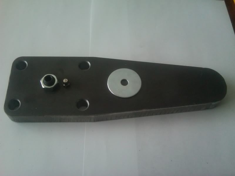

That high-steer arm has no mechanism for adding preload at all. That's unexpected.
Wierd eh? Upper was solid tho it was the lower that was loose....
D
The thing about that though is that if the kingpin has no preload then all of the force will be on the upper, not on the lower. Think about it, the springs drive the axle housing down and is stopped by the upper if there is no preload.
I think new high-steer arms are in need here, or drill and tap those ones for some large set screws like these. For $95 a pair, you really can't lose:
http://www.pirate4x4.com/forum/axle...ringless-high-steer-arms-50-each-95-pair.html
I think these are old style ones that use shims to set preload. If it gets loose again ill look into new arms for sure.

So johnny, youre saying that periodically the wobble appears and you just tighten up the preload dealie on your arms and that cures it? That right there is reason enough to grab a set of the arms you posted. Just gonna confirm theyre the same length as the ones i have on there now before ordering a set. Thanks btw.
Honestly, if you had a buddy to help you you dont even need to remove the locking hub or c clip. Unless youre hercules and can manage to put the axle shaft in while simultaneously holding the knuckle and hub.
D
And now im gonna order new arms....
I think you could save the cost and just drill/tap out your current arms for a preload screw. Use the current grease hole as your pilot and then relocate the grease hole. Unless of course you aren't happy with the current arms and want something different. Should be pretty simple and a cheap mod.
I would be tempted to try but am wondering what the bottom of the preload screw looks like. In my head i see it having some sort of flat washer lookin dealie that pushes on the bushing. Would the washer be a part of the stud or just a stud pushing the washer pushing the bushing?
D
The stud just pushes on the washer, which pushes on the upper busing.
Gotcha, thanks. How thick is the washer? I can see a thin one deforming....
