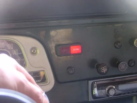

if you attach a 24 v light to the glow strap / bus bar and - battery you can see what is going on in the cabin.
The wiring for realtime glowplug light in cabin: (red wire from yellow cap (=glowplug) to cabin and - from battery)
(If you connect a wire to the yellow rad cap make sure the engine is cool :cheers:)
file.php
The magical light at 21V sunshine mode (try not to look at it while turning the key :cool:)
file.php
The light in sunset mode getting 13V :popcorn:
file.php

HJ60, I love your 24V light that shine!!
Thanks Biche, I should mention it as best mod under 50 dollar :D with the wheelchair 24V light buzzer :grinpimp:
