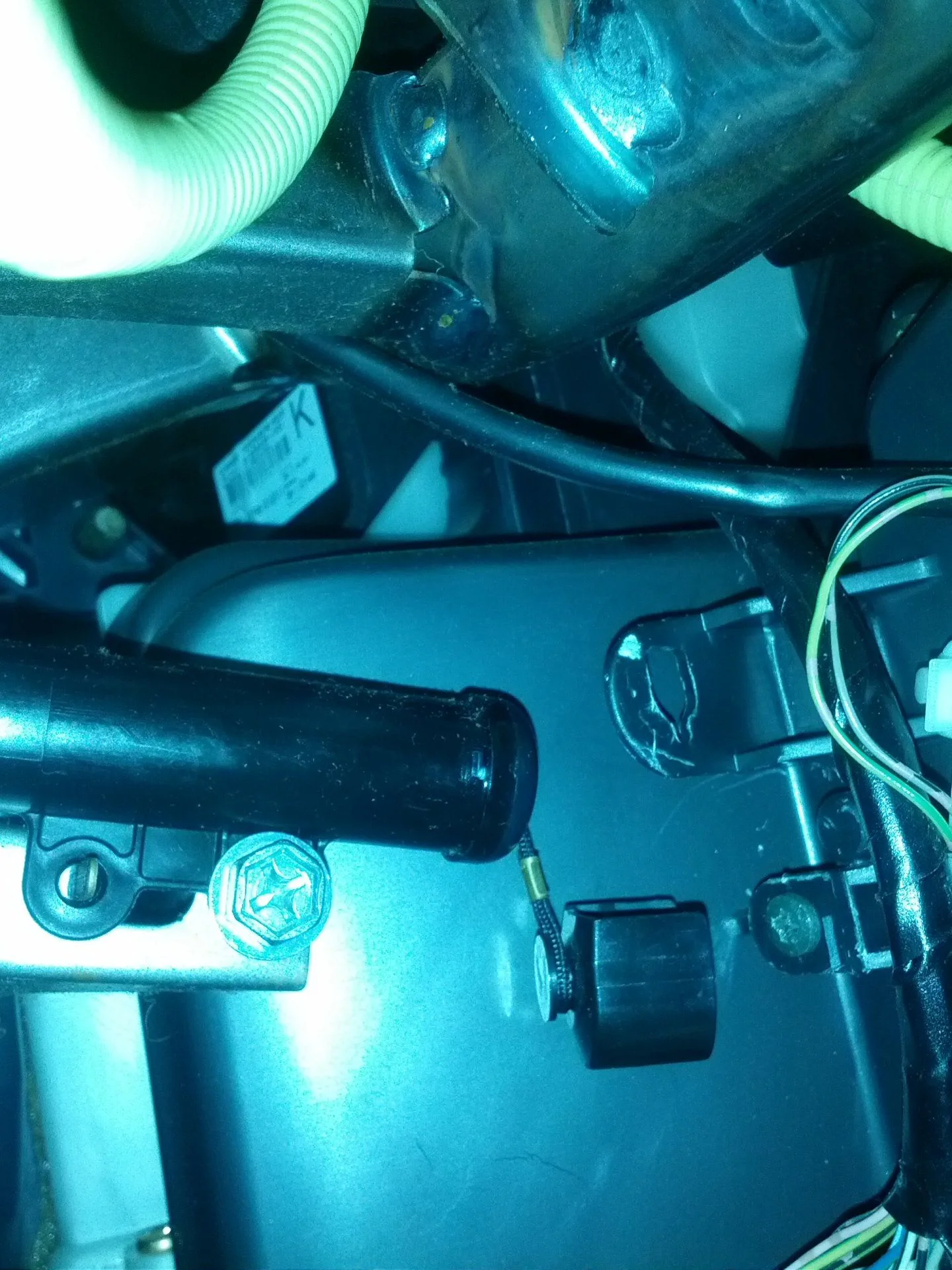

The glove box should be dampened. There is a little cylinder setup on the left side of the box where a string comes out of it. Can only see it with the gbox door off. A string goes from the damper to a post on the glove box. On mine, the string had broken off. I simply tied a new string to the old string and reattached it to the glove box post. Now it opens very slowly and closes very smooth. You might get lucky and just find that the string became unattached.
Check out the pic in one of my earlier threads. You can see the damper unit. It's on left side just above the yellow flexloom.
I noticed that structure, but couldn't figure out it's purpose on initial inspection. I bet the string is busted. Does the string come out of the back of the cylinder (side facing the engine)? Will have to get back out there when it warms up and suss it out. Any recommendation on "string"?

I've been meaning to ask what that string was for. I noticed it when adding cabin filters. I need to go back and try to reattach. What exactly does it attach to?
Beat me to the pic. It should attach to the left-hand drawer guide, from what I've found.
Since my string if still attached to plastic, does that mean the plastic broke off from the box?
THAT is a great question. Per this diagram and pic, it would appear it's attached to the string, but maybe just snaps to the glovebox?

The string is attached to the plastic thing, and the plastic thing clips to the glove box .
It's best to attach the plastic thing to the glove box when the glove box is unscrewed from the dash
