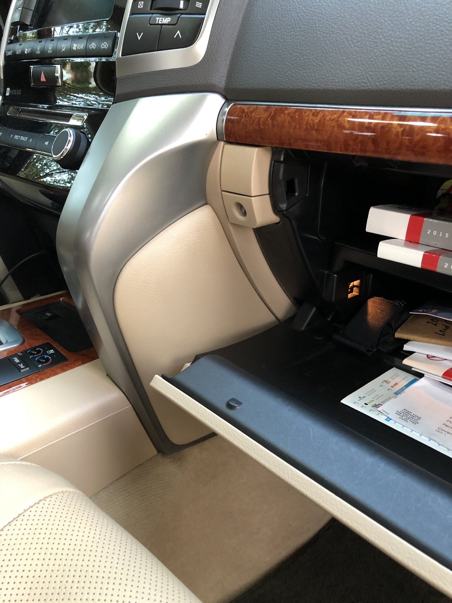

How do you get to the glove box bulb? 2015 LC. I think it actually gets darker when its on.
Remove the:
Head unit Passenger side knee pad
Wood trim above glove box
Passenger side molding around the head unit (the silver trim stuff)
Passenger side lower molding (trim around the air bag)
Passenger side shin air bag (disconnect the battery, don’t want that thing exploding on you)
Glove box
Now you have access to the little bulb. It’s not really that bad, I replaced mine with a Putco LED and it’s so bright in my glove box, I can see my floor board when the glove box is open.
You can see the bulb just sitting there thru the side of the glovebox. Crazy that you cant just pull it. Thanks for explaining the process though.

Just out of reach. Unless someone knows a trick.
also, I assume the padded thing is the knee pad. How is it attached? Same with the silver trim.
It’s just clipped on. Simply pry it off.

OK. I'm stuck. Got as far as the passenger shin trim and airbag. Small front clips came out easily but something else is holding the trim piece and maybe the airbag on very solidly. Whats the secret for getting it out? I dont want to break anything, so want to just use brute force and regret it. It looks like there's two wide tabs that need to be pushed up from underneath, and a metal bracket underneath. Help!

Mostly successful. Got the bulb in, wrong polarity but caught it before I put everything back together. Great tip from @bloc to just support the airbag rather than unplug. I put it all back together and then realized that I needed to keep the silver trim off to get to the ashtray bulb from the driver side. Will get back to that at some point. As small as that ashtray is, a brighter bulb will only remind me how small it is.
HOWEVER, when I got it all back together I found this bolt on the floor. Anybody recognize it? Dont want to pull everything apart just for one bolt that may be unimportant or might not even be from the glove box area.
All 4 airbag bolts (black in color) accounted for. All the trim screws are phillips head/self tapping 10mm bolts. The light fixture is held in the glove box by phillips screws.
