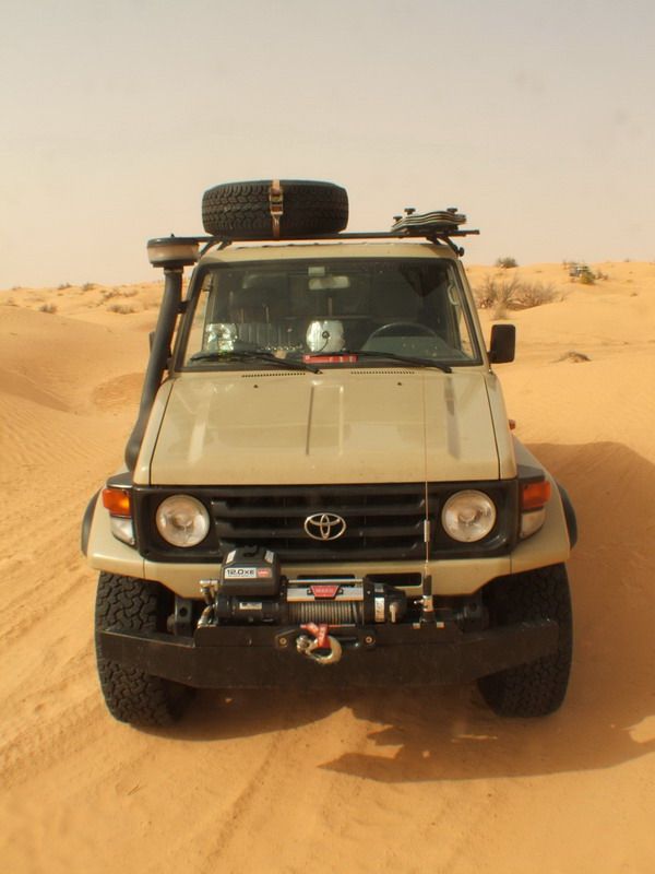

1. Year and model of vehicle
2001 Hzj 79
2. IH8Mud Handle
T0Y0TA
3. Location of vehicle
Genova, Italy
4. Country of Origin
Japan
5. Mileage on the truck odometer, in KMs please
150.000
6. Modifications
vehicle adapted to the sands of the Sahara
6. How you use the truck-
explorations Saharan

WOW very nice
Do you have more info on how the tyres pump up and down with those air line into the centre of the wheels
For Clint 79
Sorry for my English, I write with the translator of google ...
The automatic tire inflation system is very simple ...
The toyota I have installed two electric compressors and a reserve tank for ten liters of air ... compressors start with a dashboard switch, when the cylinder reaches the ten bars of pressure will stop the plant automatically ... part of the cylinder tube large cha reaches the dashboard where a distributor with four outputs for the wheels and one for exhaust ... each output reaches the wheels where the rotors are installed high speed which have a fixed part which receives the air ... and a rotating part that delivers air to the tire ... each wheel receives the air to separate from the other ... and can also be deflated separately ...
Can I post images more special...
For Clint 79
yea more pics and information on how it works and gos through the center hubs
