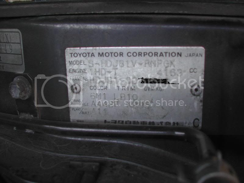

Dave,
Look on the VIN plate, it will tell you what box it has, if it says A442F then it has the later electronic box.
you should have an A442F by the year .. unless Toyota made something weird as usual with thier models in diferent markets ..
I'm not an auto lover .. ( already swap out my A442F and I'm running H150 right now ) but those trannys are extremely strong .. and there is always the Rodney resource in Australia ..
IIRC there is a MUD member ( from Spain ) that already have an auto from Rodney .. and he's happy.

Dave,
That's not always correct, early diesels came with an hydraulic version of the A442F
here we don't know a A442F hydraulic version .. here we know A440 which it's hydraulic and the A442F which it's electronic controlled or assisted.
that's why I wonder if exists an A442 hydraulic version ?
I have just been told by a Mud member that the hydraulic version has D32 shift where the electronic just has the d2 but pos with ETC?
I have absolutely no knowledge of these automatics whatsoever.
regards
Dave
I can tell you we made a group buy on the spanish forum of transmission temperature gauges from Wholesale automatics, and Rodney asked us about what type of transmission we were running, as the fittings were different all the guys with early models 80's , including me, assumed we had a A440F, as we had the PRND32L pattern, when I told Rodney he seemed amused and told me "come on and check your Vin plates", and all of us were shocked when we checked we actually had a A442F.
Anyway, in case of doubt someone just have to check the Vin plate and will find out for sure.
I'm just in the middle of a big debate with a firend who import a 81 from 91 .. and it got a full hydraulic A442 .. I just crazy with this info ..
