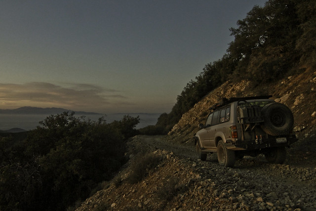

I like my little Saddleback Mountain - Santiago Peak - Santa Ana Mountains.
We are descending and light is falling faster!
Nice BDAY trip with my daughter for both our BDAY's!

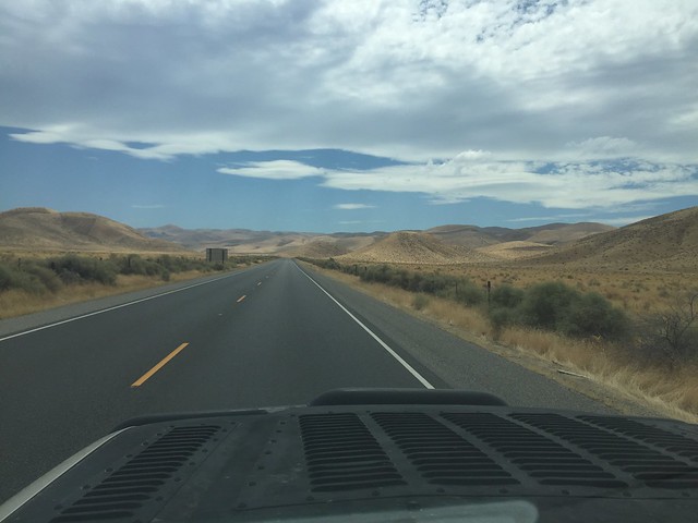

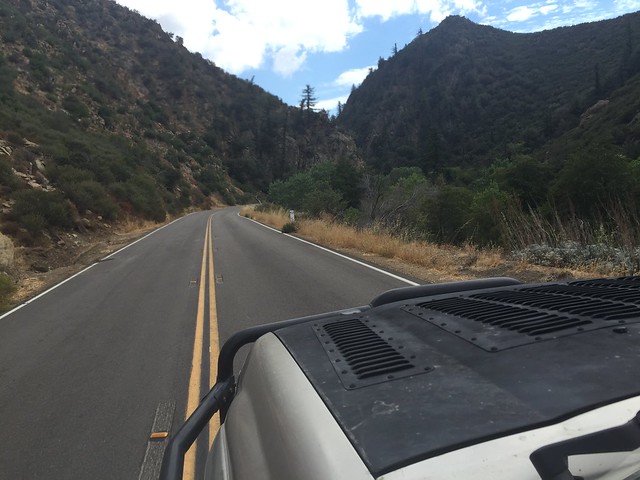

OPERATION HOOD VENT LOUVERS
For all of you who drive the 3FE UNDERpowered 80-Series, you know these rigs make a lot
of heat under the hood! My first thought was to give the rear of the hood, the hotrod look, but
actually attempting to release the heat! The function is the fashion. Longer bolts and three thick
washers later, the ADV80 has been rolling like this for at least a couple of years(?).
I purchased some Pontiac GTX vents that sat the the garage...
I visiting a long time buddy who was into the whole rally thing with us and apart of our GravelCrew.
Seems as though we are all on the same wavelength as he now has a Land Rover and doing the dirt
course in slow speed too!
I finally got time to visit the louver maker:
I took some samples he had to start test fitting with. Yes, this is on backwards, but the overall
shape is what I was looking at.
We take a lot of measurements:
A few days later I receive an email with his proposed vent panel. Yes, I wanted a LOT OF VENTING!
A few days after that I receive a package of vents!
I remove my hood and take it into the garage.
Serious time! I use the panel to make some marks so I can have some guidance for cutting!
With the bolt holes marked, I draw a line inside as this will be my cut line.
CUTTING TIME!!!
continued: OPERATION HOOD VENT LOUVERS
First line cut! No turning back now!
The easy bake oven door is now cut!
The trick is to only cut the surface sheet and not the subframe below as best possible.
I file the edges... But that's no fun..
I NEED SPARKS!!!!
Laser beam sparks!
Measurement what size drill bit needed to sink the bolts through with a little safety allowance.
Now it's time to drill some bolt holes.
continued:: OPERATION HOOD VENT LOUVERS
That's a big hole! Better for me to dream about a diesel or LS swap with!
Lets do some side vents now!
Sorry, the whole motorsports side of me is coming out with these vents!
Just so I don't get messed up and cut the wrong shape in the hood on the wrong side...
The blue tape now comes into play as I use it for it's natural body line and guide for the
side vent plates.
Holes indicated and cut-lines drawn..
Underneath I take a photo of the remaining two stickers - never saw what the other sticker was...
BRAAAP!
One down and one more to go!
continued::: OPERATION HOOD VENT LOUVERS
Attitude Adjustment Device - that's an old sticker from my past...
As you can see, there is the sub-frame that will require some "going through" with the screws.
Take some measurements as to what will be needed to clear the socket installing the nuts.
Silver market indicates diameter needed to allow the socket to fit down into the thickness of the subframe.
Awww darn! No sparks for fancy photos...
They work great for working in the garage too!
LUNCH TIME!!!! And paint dry time.
Time to start putting in all the bolts! See, I read instructions!!!
PS: This is where I got the louvers from too!
I start with putting the side vents on first.
BOOM!!!
RHYS MILLEN BETTER WATCH OUT!!!

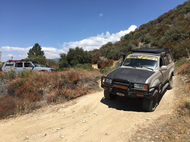

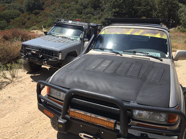

He went for the RodLouvers hood vents as well and told me the first thing he noticed was his feet
were cooler! RodLouvers actually started making louver vent kits for the XJ's. I found them through
my buddy who knows them and hopefully you guys like my setup with or without the side hood vents
for your own rigs.

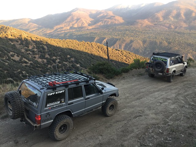

Later that afternoon as the day cools and the mountain blocks some of the sun, we start our
decent down
Radford Camp Road from the top of Snow Summit. This will drop us back down
onto HWY38.

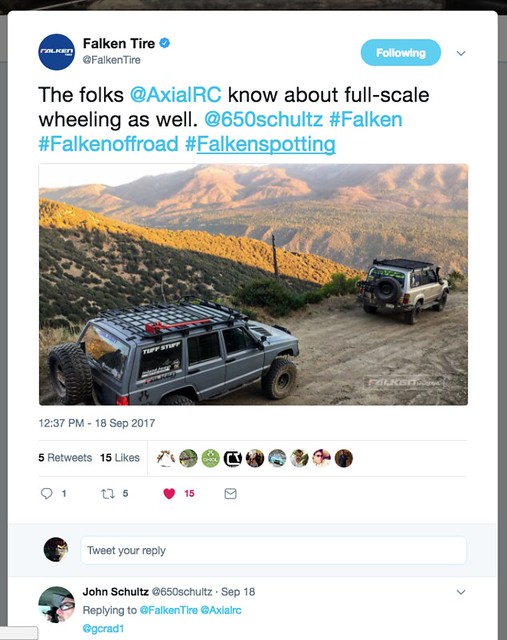

Stoked to see this image make it onto Falken's Twitter page!

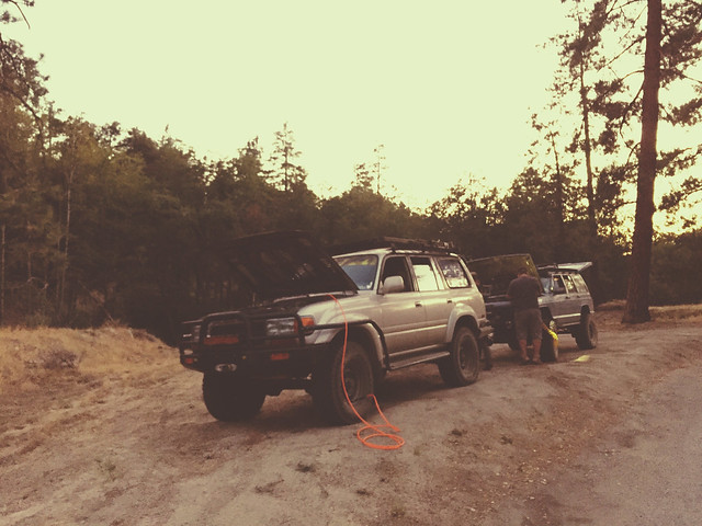

While we are airing up:

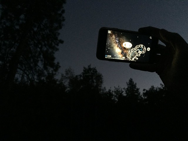

Our buddy is surveying the stars with his cool phone app!

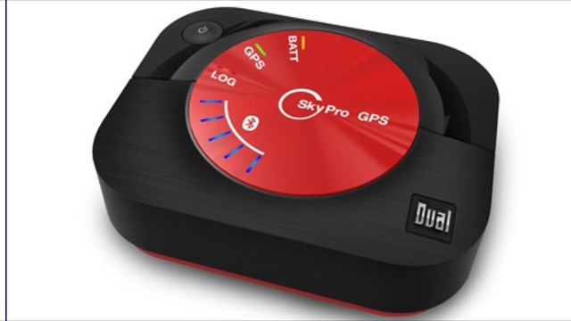

Mojave Trail Prep - Navigational Booster Buggy Whip!
I've placed an order for one of these Dual Electronics XGPS160 SkyPro Bluetooth GPS Receivers.
I want to be one of the cool kids, just like all my friends! Yea, it's that simple, my buddies have
them and swear by them... I hope I don't swear at it and them!
WHAT THEIR WEBSITE SAYS:
The Dual XGPS160 SkyPro brings GPS capability to your Apple iPad/iPod touch/iPhone, Android phones and tablets, Blackberry phones, Windows devices and laptops running Windows, OS X or Linux. If you have several phones/tablets/laptops in your household, and you’re looking for one GPS to work with them all, the XGPS160 is an excellent choice. The Dual XGPS160 works with popular electronic flight bag apps including EFB, ForeFlight, WingX Pro, and many others.
The Dual XGPS160 is very easy to use. Once you have paired via Bluetooth, the Dual GPS Receiver will automatically connect to the device it was last paired with and you will be able to use it with hundreds of apps that require GPS location information. The XGPS160 also comes with a useful GPS Status Tool app that is available free on the iTunes store and will show your location, the number of satellites you are connected to, the battery level, and more.
The XGPS160 includes a non-slip pad for use in your airplane, car or boat.
My iPad / iPhone already has a GPS - why do I need this?
The iPhone and the 3G models of the iPad include an internal GPS, however the internal GPS is made for use on the ground and is not very reliable in the air. You will find that you experience intermittent outages from the internal GPS while flying. The Dual XGPS160 is a WAAS-enabled, GLONASS capable, super reliable and accurate, GPS receiver that you can count on both on the ground and in the air.
More Info: http://www.mypilotstore.com/MyPilotStore/sep/9473
I have the older model. Seemed to work fine. I can't remember which I struggled with connecting, the Apple or Droid stuff, one gave me a headache. I'm sure they fixed some of that.

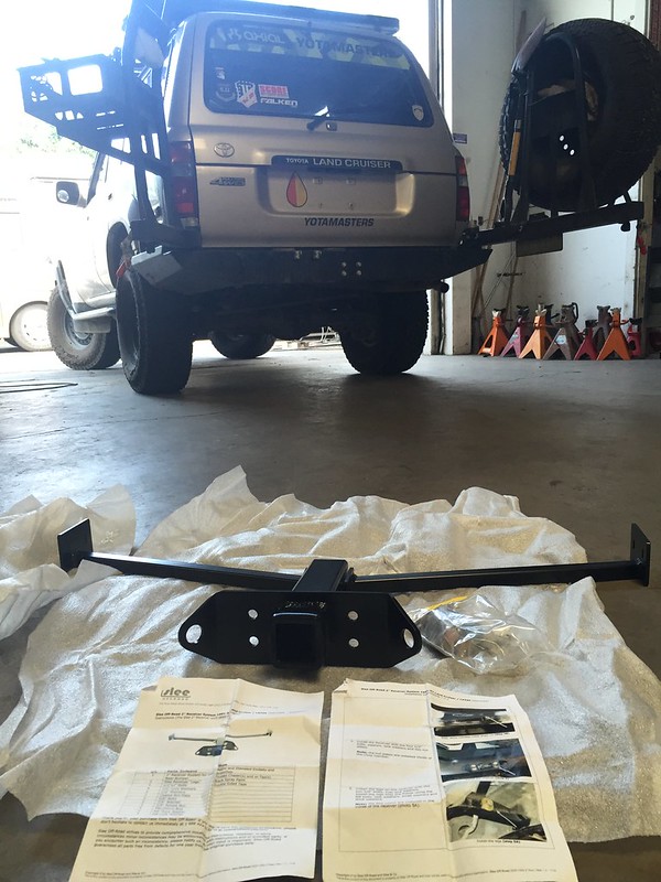

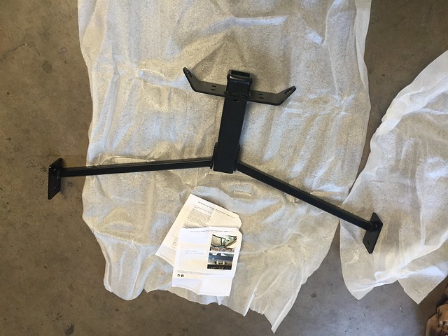

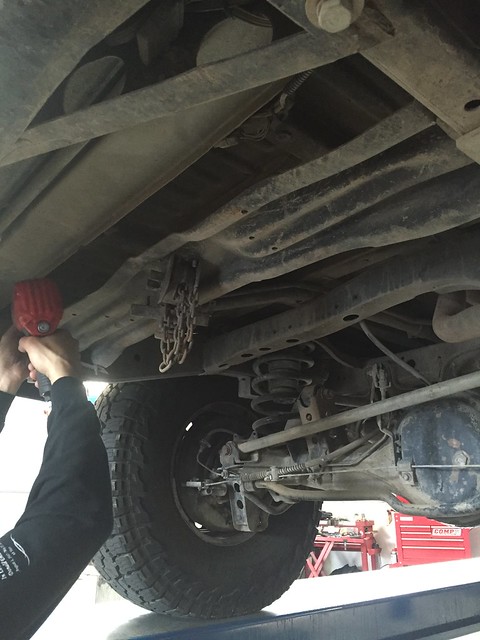

NOT MOJAVE PREP - But moto-transpo prep!

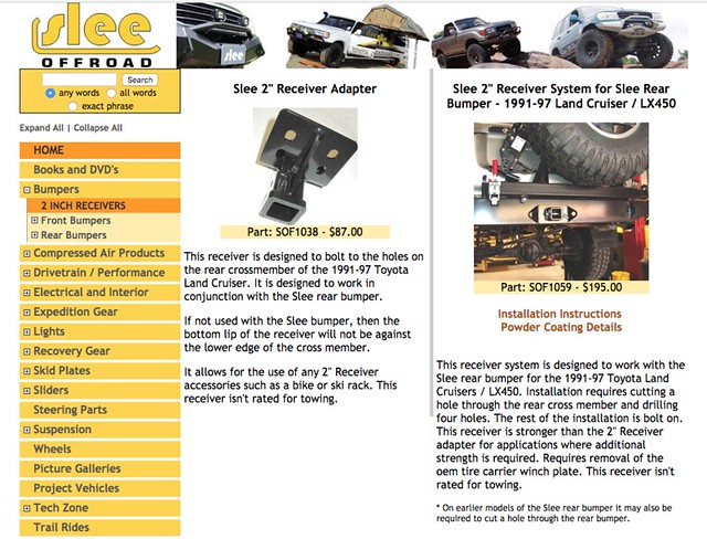

This is one of those items that was "IMPOSSIBLE" to find previously on the SLEE Offroad page as
it was buried in some instructional thread or in some lost corner of the "internight webula"
Never the less,

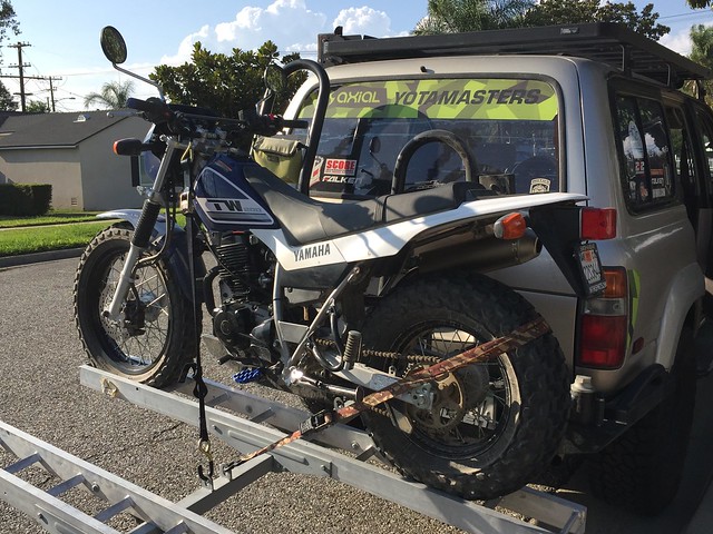

I found it and bought it as the hitch mount is how I get my motos around.
Slee updated the page to make it easier to find as well!
So let's get this receiver party going!

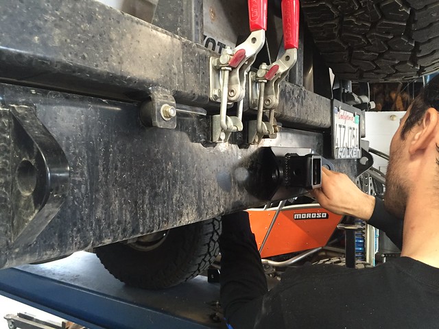

I really like the design of the receiver with it's additional supports.
I go visit Kenny The Fabricator at his secret undisclosed location.

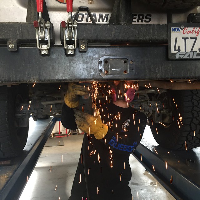

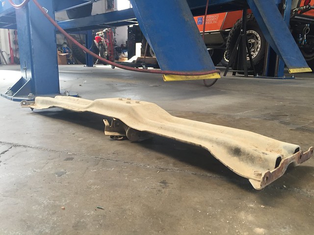

Lets take this spare tire carrier cross member out. It's not getting any use
anyhow with these 34" Falken Wild Peaks.
Craigslist Listing: Honda Civic DTM rear wing. Chain drive adjustable height.

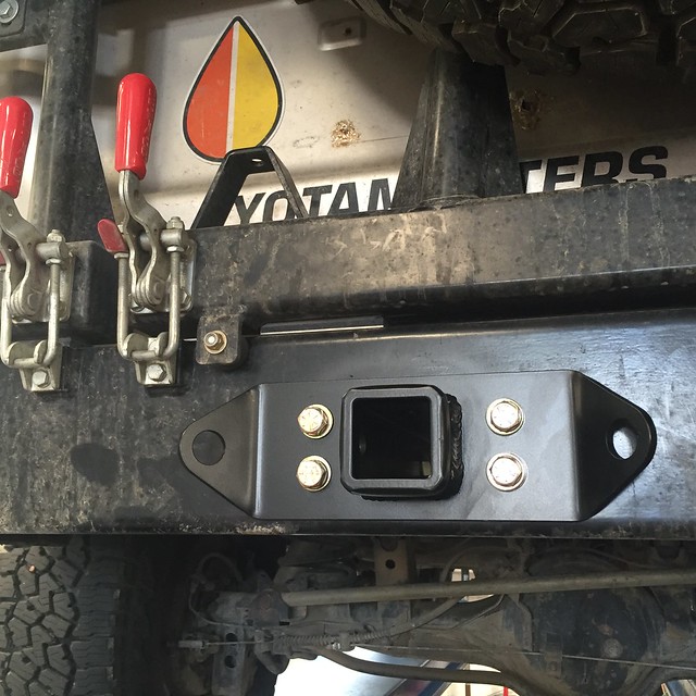

There is some official Toyota metal we have to go through back here in order to install the SLEE receiver
hitch mount. I like the fact that the hitch will not be hanging under the bumper like it use to with the
factory bumper.

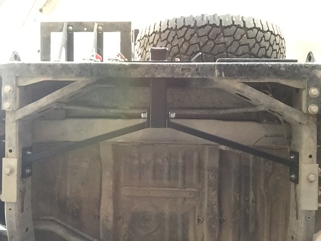

1, 2, 3,...
It all came together super easy!
Here is what you really want to see, how it all connects underneath. And the fact that it uses the
factory bolt holes from the spare tire cross member is a nice touch! And yes, I am still loving my Slee
rear bumper carrier! Its a work of art and it does its job very very well!
All for this!
