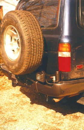

I am working with a local welder to make me a Tire Carrier that mounts on the OEM Bumper and would copy closely Zane and Johnny Lange aka wildyoats design...Wild Yoats Toyota
Really there is not much to it, but some cutting and welding, then painting of course. I am willing to work with my local welder to make more quantities if others here are interested.

When we opened the shop we looking into doing it, and the problem is that for the cost you end up with the tire out of the way, but still with plastic corner pieces. Most people that want the tire out of the way wanted stronger bumpers as well. It did work pretty good though. I always found the difficult part was to determine exactly where to cut the hole in the rear bumper piece. Remember back in the days those corner pieces was expensive. My truck has about 30k on it when I did that.
Good luck, you might get some piece that want it. Make sure you get the support under the plastic pretty strong.

Man, that was a long time ago. Bought with 8k miles on the clock. Was never going to off-road it. This was the day before I sold it. Was also never going to sell it when I bought it. :D

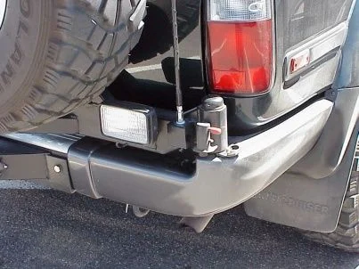

The Tire Carrier is finally finished. So much for a couple of weeks..
The most time consuming part is deciding on where to drill the hole on the rear corner piece, and getting the spindle arm to match up against the hole correctly and every other little detail about it (height for example) (FYI, it is better to drill closer to truck’s body...because if you drill farther away you loose clearance as the rear plastic bumper piece gets in the way of the spindle arm mount.)
I went with 1/8” 2x2 box steel for the main carrier, and 3/16” thick plate for the bolt on face plate that connect the spindle arm to the rear frame. It is secured by 3 bolts on the face, and the 2, 12mm bolts that secure the hitch and recovery hook under the frame….I had to get longer 12 mm hitch bolts to make up for the extra face plate thickness…
The spindle arm is made from 1 ½ x1 ½ , ¼” inch box steel…Like Christo said in my previous post, the key is getting the support under the plastic pretty strong, and I believe we have addressed this pretty confidently.

Rocklogic IPOR Spindle ($53 shipped…SLOW DELIVERY)
Locking 2000 pound latch ($42 shipped…Small Parts 341-R)
locking bumpstop pin or limiting strap.(decided to go for a strap instead temp strap for now) around $20
OEM Toyota Tire Lug Nuts and bolts, plus other bolts and stuff Some bolts and tire wheel lug nuts ($30)
Steel: $30-$40
