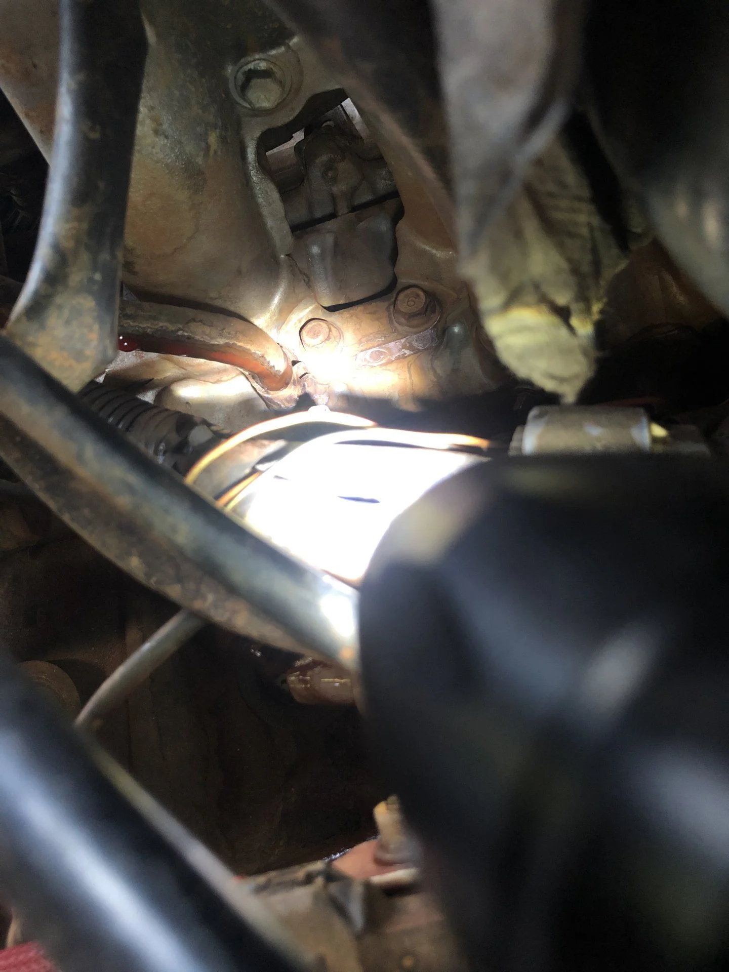

I did that a year ago using the relief cut method! Still not 100% on approach to rear heater.
My final issue is at 233k miles the birfs are original. There are no signs of grease in the diff or oil in the birfs. We top up the grease every 3k miles, but I would hate to send it out there and find they leak ….
