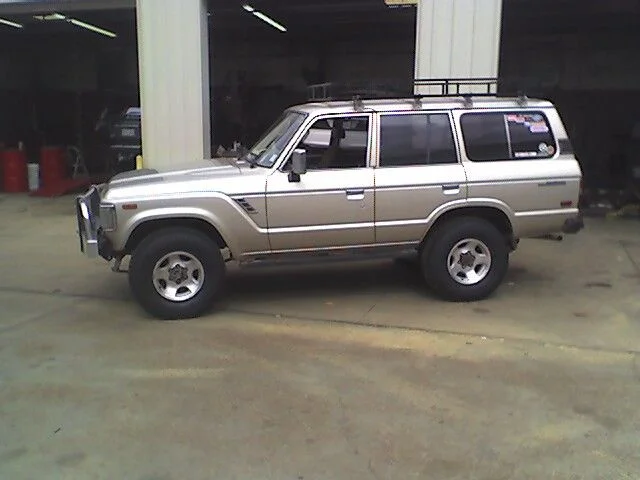

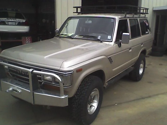

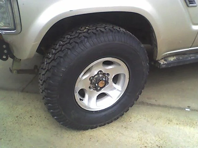

Spent way too much time and energy deciding what tires and wheels I was going to use. Ended up with FZJ80 wheels with 285 BFG AT's. I'm using 1.25 spacers from Marlin Crawler behind the wheels. With 2 corners flexed all the way the 285s rub a tiny bit in the front, not enough to bother me. I wanted to go to 295's but they would have rub too much.
OME 2.5 with long shackles.
Body lift and 315's at some point down the road.
Changed all the fluids, start packing for Moab tonight after work.

Still running the same spacers as original. Right about the time BFG came out with the KM2's I did a 2" roger brown body lift and went to 315's on the same wheels. This time last year I painted the insets of the wheels, sorta like on 40th's anniversary wheels. I'm still running stock bump stops. I really need to extend them down by 1" in the front to keep them from stuffing into the fronts of the fenders, but my concern for them rubbing is small enough that I've not been motivated to do it in 2 years. :rolleyes: They don't rub bad enough to tear the tire up. Heres a pic that shows how I painted the wheels.

Ok well I was JUST over at Chatsworth Tire and was ready to plunk down $907 for 4 tires, valve stem, mounting, balancing, the works. They took one 80 wheel and mounted it on a 285/75/16 KM2 tire. LOOKED FREAKING SWEET!!!
But without spacers the 80 wheel definitely rubs on the tie rod end. Its a no go. I am looking at Marlin's spacers but 1.5" is A LOT.
So they put my old tires back on :(
