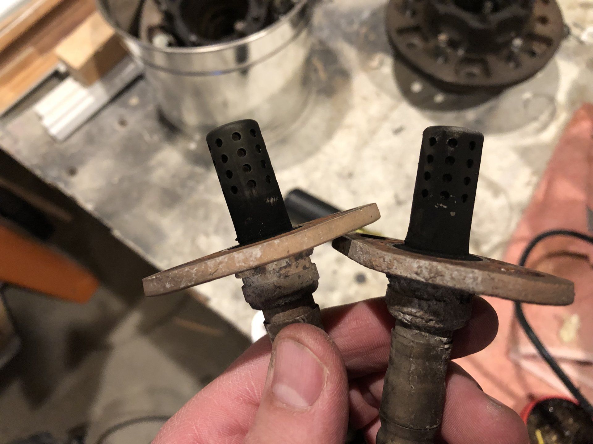

FZJ80 O2 sensor Replacement
Just did this. Those Irwin bolt extractors are magical. Mine look like they were about done.
1912600
I don't but if your in a jam. I just replaced mine with stock nuts and a gasket from the help section at O'reilys.
Used a 1/4 ratchet and one hand snugged them.
My exhaust came back from Tellico in shambles. Broke rear muffler hanger by passenger wheel well and upstream o2 sensor nuts disintegrated. The muffler hanger broke first. I think the vibration of the tail pipe on the frame disintegrated the nuts after that. The nuts were badly rusted.
Campers and hikers love you when roll into a campsite with tuned exhaust note of the upstream o2 sensor blown out of the mount hole. I made the trip back across i40 with the o2 sensor held in place with SS wire.

Anyone have recommendations on how to get those O2 sensor nuts off? I sprayed them with PB Blaster a couple times a week before attempting to remove them. I got one off with the Irwin tools but cant get the other off.
I had to remove the stud and then after stud out removed the bolt.
Sorry to resurrect for a question. Thought it'd be good to keep together. Anyways, has anyone just flattened the mount surface and just put the o2 sensor directly on mount/with no gasket. It seems rust creeps in the lamination. Unless the previous owner purchased aftermarket ive seen this a few times.
