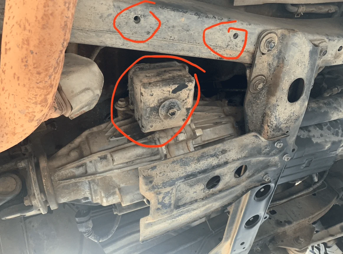

I've searched quite a bit, but have not found my answer. On my 1997 FZJ-80, the transfer case has a mount on the passenger side on the TC that is not being used.
Seems to me that this would be important, but am being told by another LC owner that this isn't needed and he removed his too???
The vibration @ the H/L selector in the cab on the HWY is very noticable. Other than the vibration, no other symptoms.

It's different in that it's just to take up harmonic vibrations. You see them on exhaust sometimes. It is not meant to mount to anything else, like an actual mount would. You know how a steel pipe sounds when you drop it? Now imagine a 1 pound block of lead attached to the pipe - much quieter. That's all this is really doing.
Ah, yes, the dynamic damper! I have heard of such a device.
In this case, wow, it sure looked like it was meant to attach to the frame. Wonder what used to be mounted on the frame... (empty, threaded, holes)
