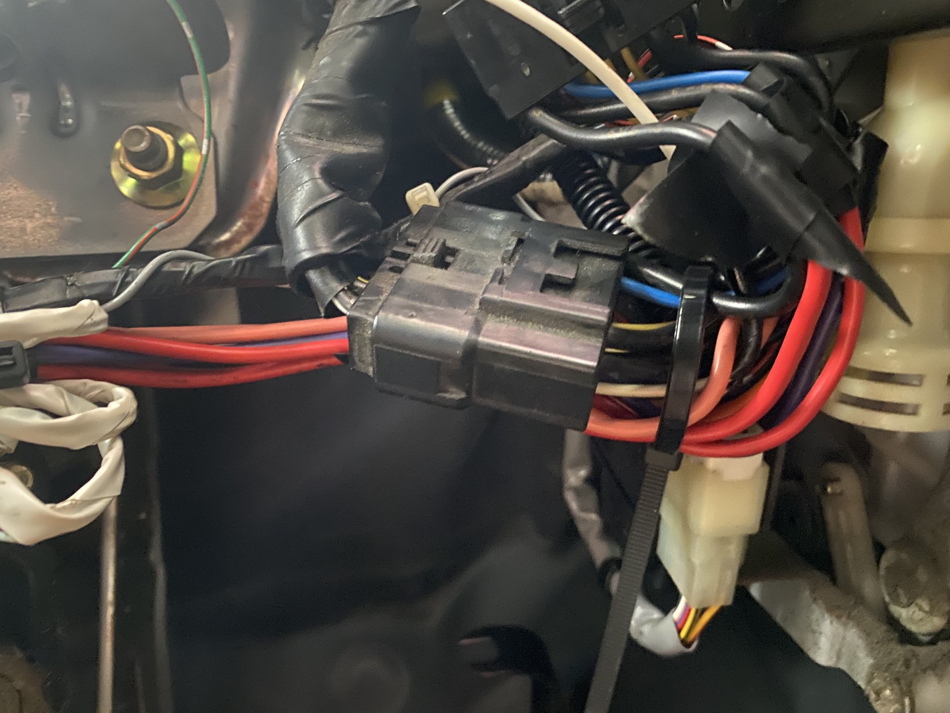

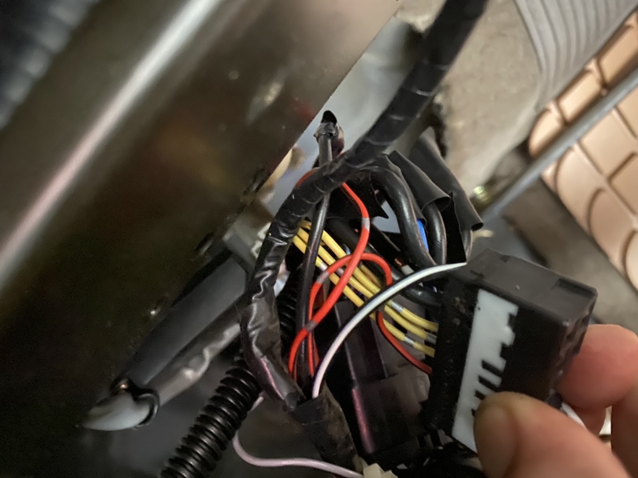

I’ll snap a pic of my truck side ignition switch connections so you can take a look. Things definitely don’t look stock but I am able to identify most of it using the FSM. I have very little electrical knowledge but you guys have been a huge help along with the FSM. I would never tackle something like this without you guys. I’m a sales rep for Boss Plows in case you ever need a plow or a spreader. I can hook you guys up with a great discount

Looks to be a lot of electrical tape and potential splices that I will need to investigate. Ugh……

And yeah, looks like a lot of (poor quality) PO stuff going on. Did you touch ANYTHING other than replace the starter (and of course the fusible links)?
You obviously will need to figure out what the PO garbage is sooner than later. Maybe hooked to an alarm system, maybe even with remote start...

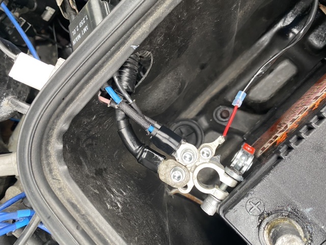

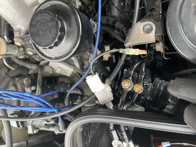

Here my FL setup. Problems began after I changed the FL. Initially had a really hard 1st start of the day which led me to replace the FL
Do you have the smallest battery possible in there? What is that side-post looking thing?
There is a whole lotta UGLY wiring in there next to those connectors you showed in that pic.
If there is a remote start on hits, I'll bet that's the source of your problem.
