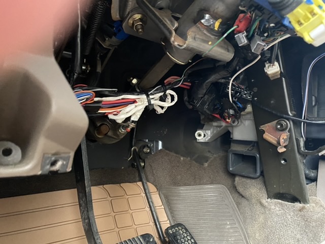

Do you have the smallest battery possible in there? What is that side-post looking thing?
There is a whole lotta UGLY wiring in there next to those connectors you showed in that pic.
If there is a remote start on hits, I'll bet that's the source of your problem.
See, that's why we try to ask about things like alarm systems, remote start, lights, winch, stereos because people THINK they understand how to wire something and they DON'T. I've been doing this a long time and I still have to question everything I do to make sure I don't dick it up.

A little update: I was able to locate 2 splices into the ignition switch harness that look to be from the remote start. No idea how this thing started and ran before but it did. I removed the 2 splices and cleaned up the wiring and it appears to have solved the issue. I was able to start the truck but it was still a little slow to turn over. I’m going to wait until I get the new ignition switch tomorrow before I reinstall everything but the initial startup and road test went pretty well. Still have to figure out why it’s starting so slow. Maybe it’s the tiny battery?
There is a remote start hooked up under the hood. I’ve tried disconnecting it when troubleshooting and it doesn’t seem to make a difference.
I was just looking at this wiring diagram and it seems like the wiring issue must be upstream from the starter. With the ignition switch taken out, how could the starter be getting power? I’m obviously lost when it comes to electrical. I’ve been reading the FSM all day and I just can’t seem to figure it out

Zoom in and check out all the perfect connections coming off the ignition harness 🤦🏻‍♂️ 🤦🏻‍♂️ 🤦🏻‍♂️. Currently cleaning it all up and doing right. Appreciate all the help fellow Mudders. Based on what I’ve seen so far I’m sure I’ll be back soon.
View attachment 2934892Zoom in and check out all the perfect connections coming off the ignition harness 🤦🏻‍♂️ 🤦🏻‍♂️ 🤦🏻‍♂️. Currently cleaning it all up and doing right. Appreciate all the help fellow Mudders. Based on what I’ve seen so far I’m sure I’ll be back soon.
I see an alarm disable in there too. That red button would be a "valet" button.
I hate seeing that kind of stuff on ANY vehicle.
