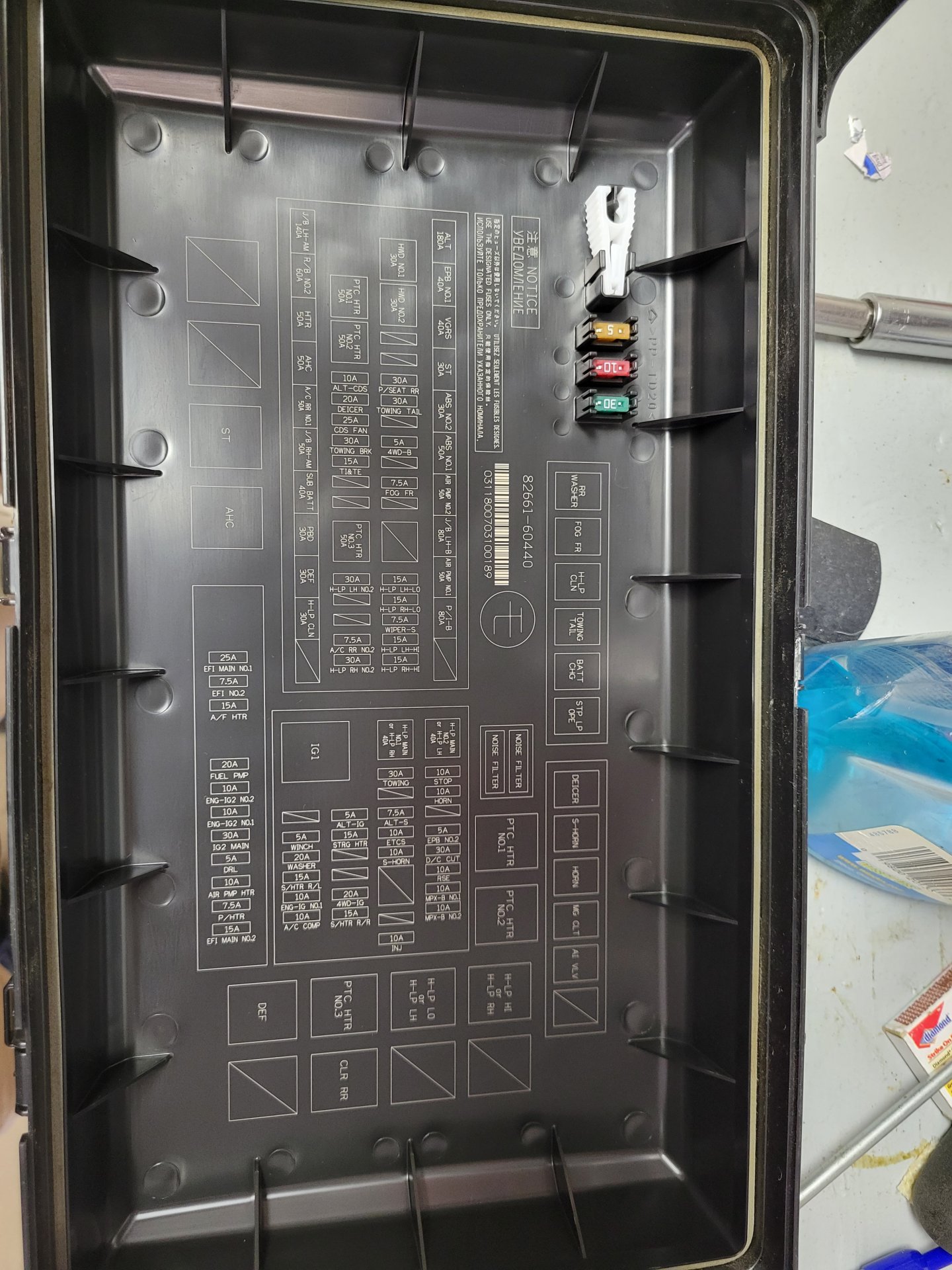

Which fuse is for the round plug in the wireless charging area? I'm not understanding the acronyms on this cover and don't have the wiring diagram.
I suspect you may find that fuse in the smaller interior fuse box underneath the steering wheel to the left.
yep
Passenger Compartment Fuse Box №1 (left)
Fuse #4 10amp
cigarette lighter

Found it, was actually fuse labeled p/outlet. And, you need to be an acrobat to get to that box, and fat fingers make it even rougher.
I hear you. I just added 2 fuse taps to that fuse block. Not as bad as getting to the top bolt on the back shocks, but it is up there with PITA items.

So, if the fuse I replaced "p/outlet" fixed the round plug on the wireless charging area, then that makes me wonder what the #1 fuse "cigar lighter" is??? I would have thought that was it, but it wasn't blown.
Simple, pull it and see what doesn't work. :hillbilly:
