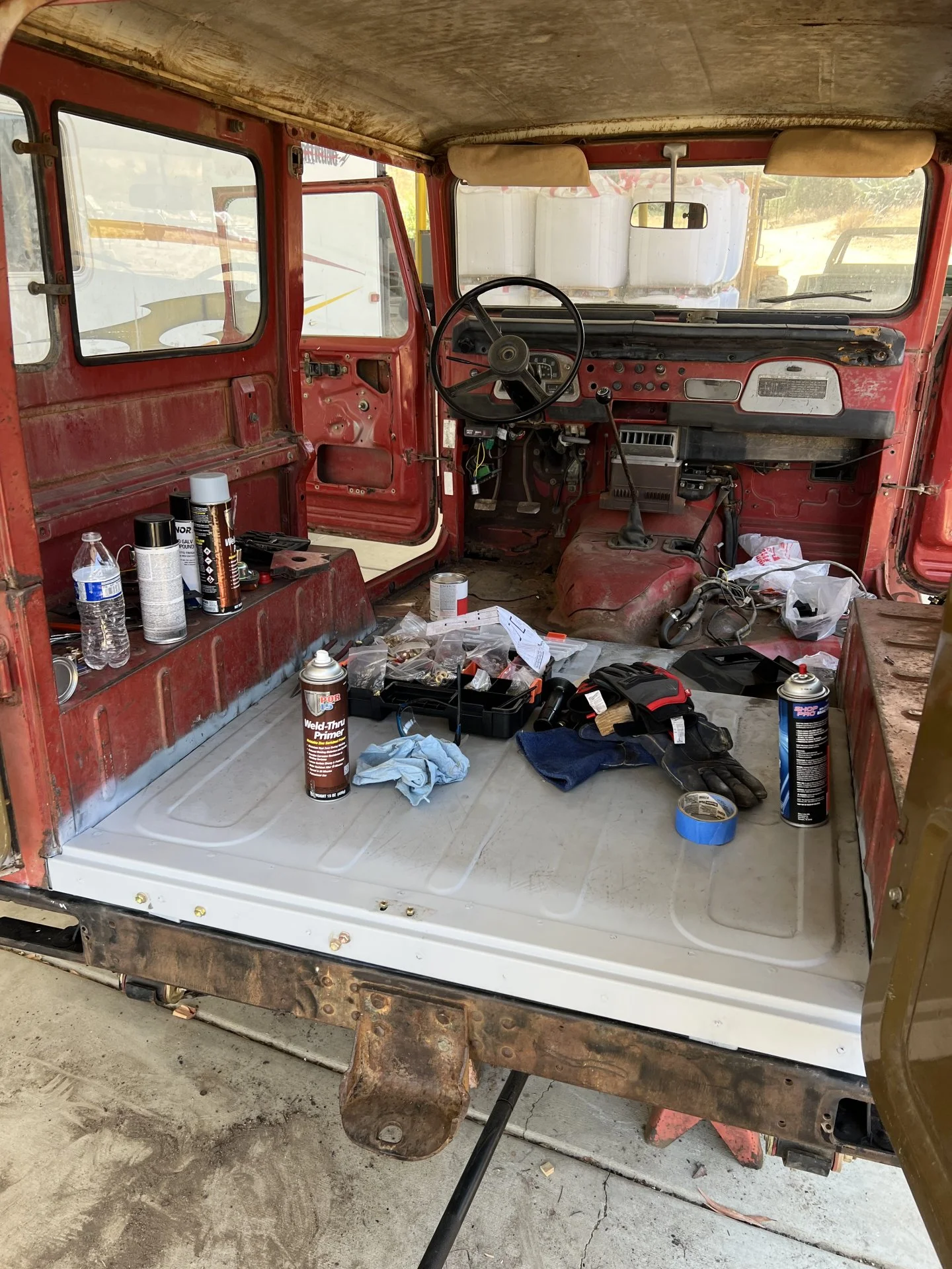

Thought I would throw an update here. I ended up installing the rear floor so far. The quality difference is noticeable, and in retrospect I would have ordered either the Cool Cruisers or Real Steel pans. Oh well... gotta work with what you've got! That said, the fit for the rear pan is pretty spot on, no install issues outside of the length of the rear pan being longer.

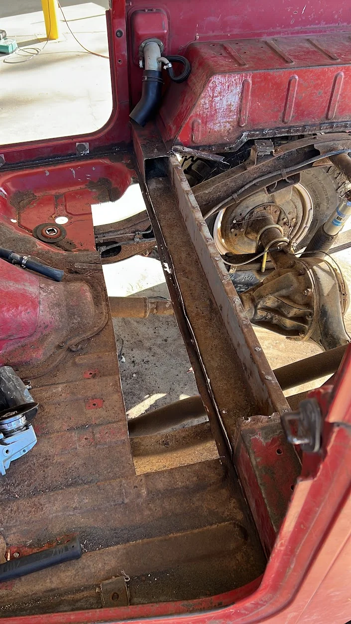

I'm insane and cut out the rear floor pan up to the channel, then cut the front floor pan right up against the spot welds so that I could cut them out. WTF am I doing? I don't know either.
Removed the front floor pan where the rear pan meets it for the pinch weld.

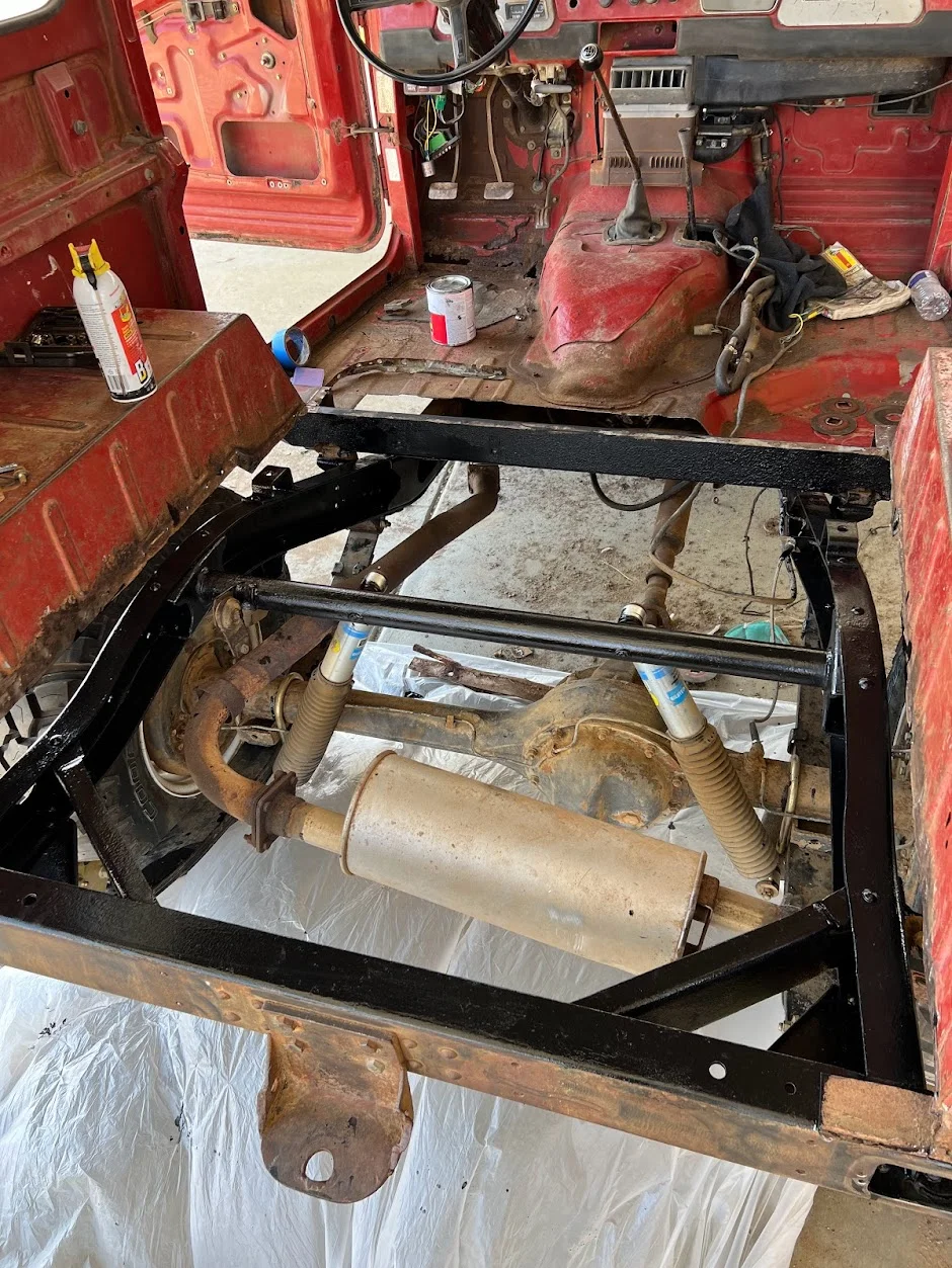

Prepped, primed, and painted the chassis

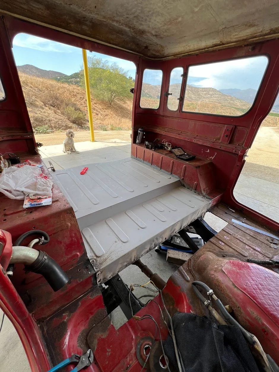

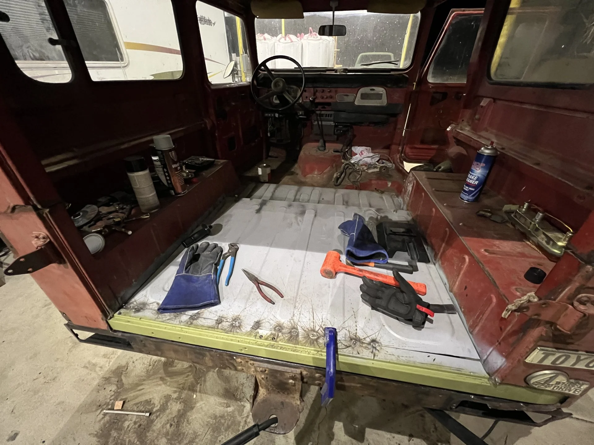

Half way in with the (s***ty) welds. I ran out of time about halfway through. This weekend I'm hoping to finish up the floor pan. Then I can go back and remove the rear sill body mounts and replace the rear sill. Then it is onward to the front. I had to be careful and not remove too many of the body mount points at once.
Welds look great! Scenery nice too. Lots of empty spaces in cali?
Thank you, first time I have ever welded, but my brother is helping me out. Depends on where you're at - I'm in San Diego county, lots of open space east.
What does QC Doodle think of your work? Quality Control, that is🤔
QC Doodle was not amused - he said "it took you 8 hours to do this!?"
Just going to throw another update in here. The cruiser heaven rear bed pan has officially fit. It did require hammering and cutting, but it wasn’t too bad.
