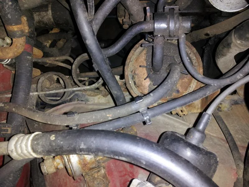

FJ62 Canister?
I have a 62 - is this the canister?
I also have/had the same issue w/ gas comming out of the cap when the vehicle is powered off with a full tank. This is from the passenger side:
Switch the two lines on the charcoal canister. You'll bypass the check-valve in the canister that prolly is no longer working.
Or, if you really want to keep the canister set up, you can replace it with this ONE (linky) and it works perfectly.
Here it is installed in an 80 series:
Seems to me there's three hoses coming out of the stock FJ60 can?
Also where does the not-out-of-the-fuel-tank hose go?
