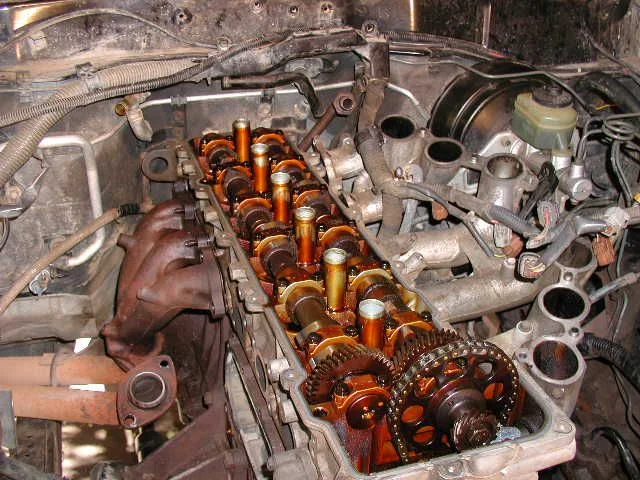

Well, the fuel filter is *really* easy to get at once you have removed the upper intake plenum...I removed both. All of my stuff around the block was removed for my rebuild. Everything but the block and brake booster.

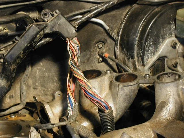

Permanently--mainly for ease of access and to be able to clean the lower intake plenum fully.
The way Toyota did it is that they ran it through the intake manifold and through IIRC the second to last runner which made accessing it almost impossible. You can see after and before pics below.
If i recall- he hacksawed the lower intake(which wasnt removed for the HG job) joint--slipped out the harness- and welded it back together.
Which harness is down there? I've never had the intake plenum off so I'm still discovering the 1FZ marvels. Is the harness is a vulnerable position like the loom near the EGR valve?
Edit: Nevermind. Thanks for the pics, that was the harness I was thinking of.
Hacksawed indeed and threw the lower plenum away.
The runner split apart too much and lost structural integrity. My friend Kirk here on MUD had an extra that he gave towards the project. So, I sent that one for some hot tanking and then reinstalled with the fuel injector lines running above and through the intake plenums (upper-lower) and then ran the other stuff underneath the whole intake plenum assy.
