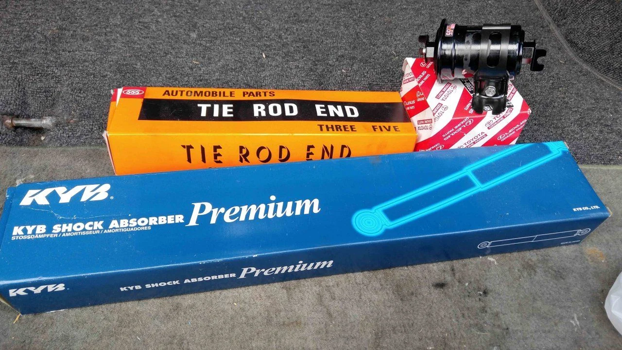

Yes, I know it's hard to get to. Yes.....I bought one about 3 years ago and just installed it today.
After cutting open the fuel filter on my LX470 (I recently replaced the fuel filter) and seeing what was in there, I was prompted to replace the one on my 80 Series.
The filter might still be working and it might look great on the OUTSIDE....but its a good idea to replace them every few years....(or right away if you suspect a fuel contamination event)
