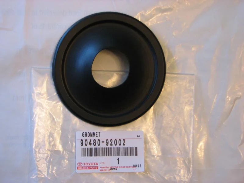

I "Think" it's part # 90480-92002 - Just listed as a Grommet...
Of course that's the one part # I didn't write down and threw away the bag. I have the EPC, but the problem is it's listed in the 'rear floor member' section and the picture is just a tiny grommet. That's why I had trouble finding it the first time.
HOWEVER - verify this # before you buy, with SOR or CDan or....

Just to confirm that this is the correct part. I didn't think there was any doubt but I know people like pictures. I know I do.
That is the part that I need anyway.
THANKS!!

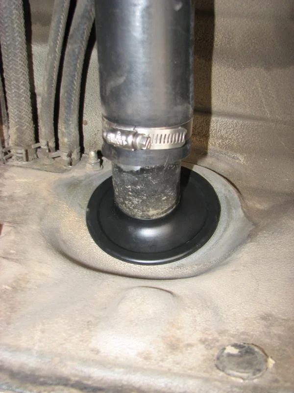

Do you have the lower grommet as well? Just put one on and it was the wrong size. I tried this one,,
Yes , I have them in stock and include them with the filler neck hose and clamps as a kit. I can sell them individually as well. It's the same one you got from City Racer. There's only one version of that part. Try putting some grease on it
