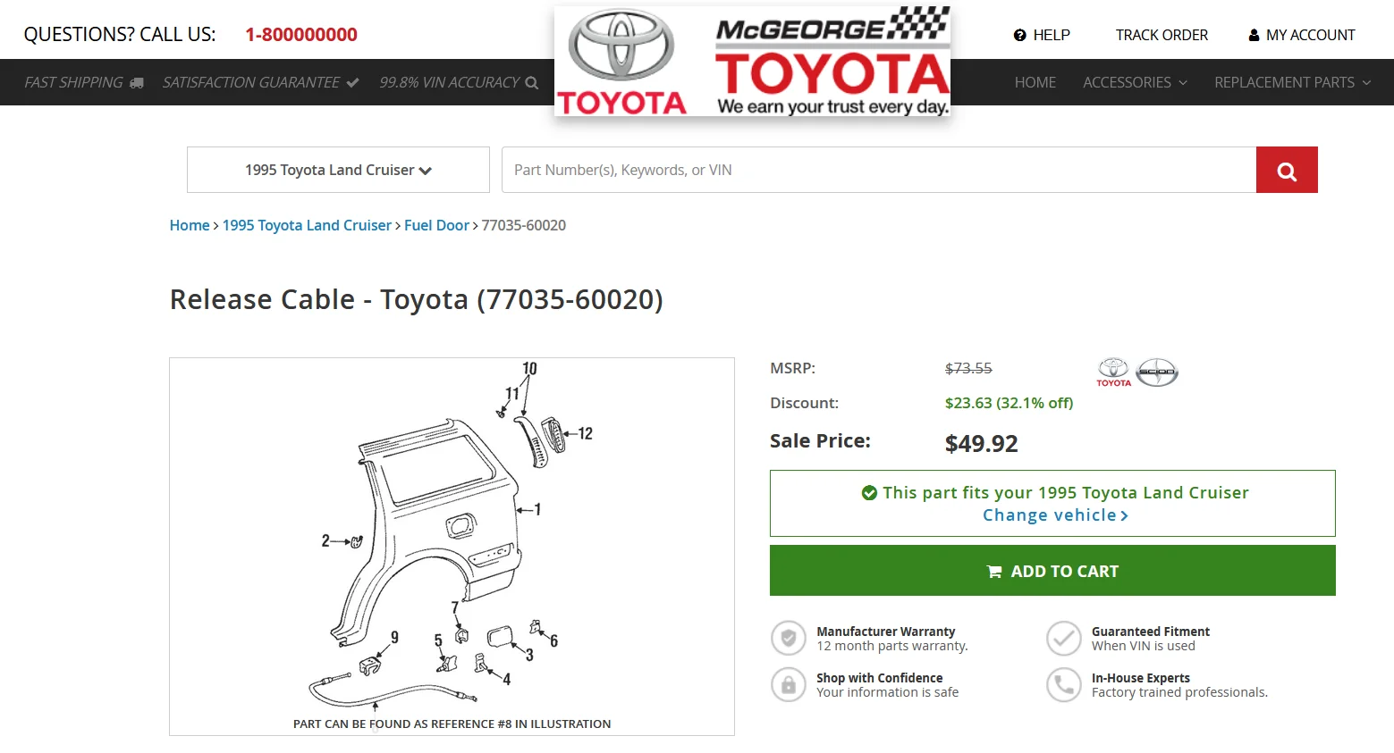

Why not just buy a new cable, if yours needs to be replaced?
