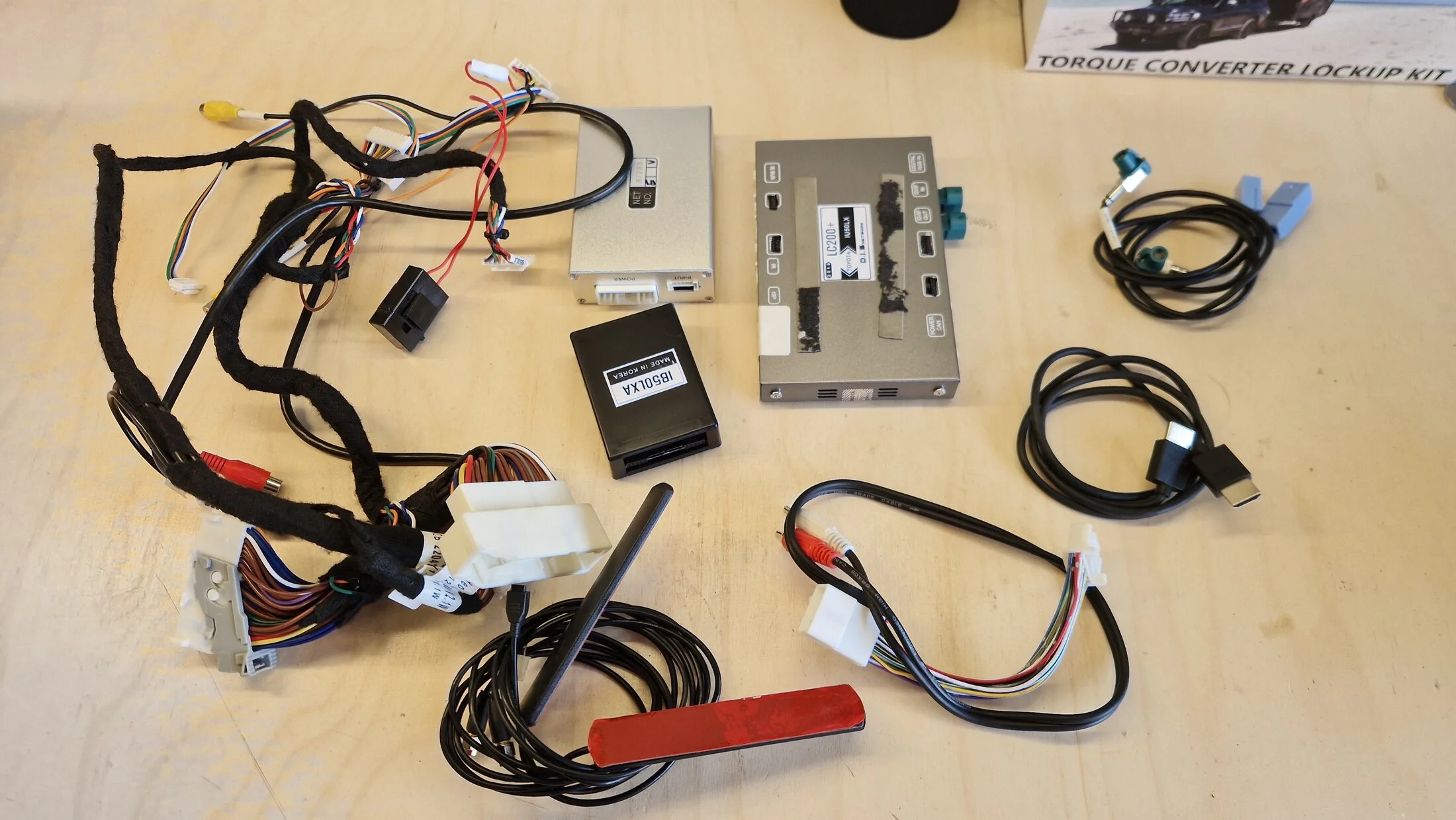

Hello,
have you managed to get to the bottom of this issue? I have simillar case, where my radio screen is black. No audio. All AC buttons work.
I get proper power to the unit, I got the HDD drive tested and it is working fine. I have no clue what causes this.
All happened when I unplugged android piggyback box I stopped using. caled Naviplus

oh my...this is really expensive. 8k for a outdated unit.
I bought a conversion kit on aliexpress with conversion kit. Radio unit was fine but conversion kit was horrible. So sent it back.
I will look for a different unit, anyone have a tested and reliable option that can recommend?
