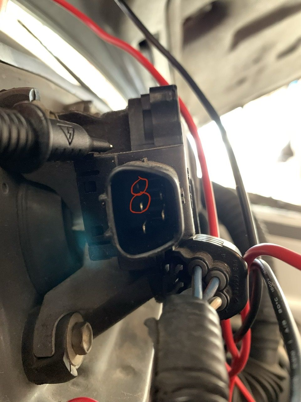

Thanks for the advice. I checked it today and I’m getting nothing. For a sanity check, here’s what I did.
left the wipers in about a 90 degree position, tested the two connectors for continuity and got no response. Attached is a pic of the connectors I checked. Based on tour advice, it sounds like the motors to me?
Looks like you’ve circled pins 1 & 2 on the motor. The diagram in my first post is of connector on the wire side, so the motor connector pin numbers are reversed.
Try checking the pins I’ve circled in yellow below.
Thanks for the clarification, I totally missed that.
I checked again with the right pins and still have nothing.
Interesting enough, last night I got them to skip/hop (really jerky) a couple of times when turned off like they were trying to get to rest, but stopped about half way. Feels like a motor issue.

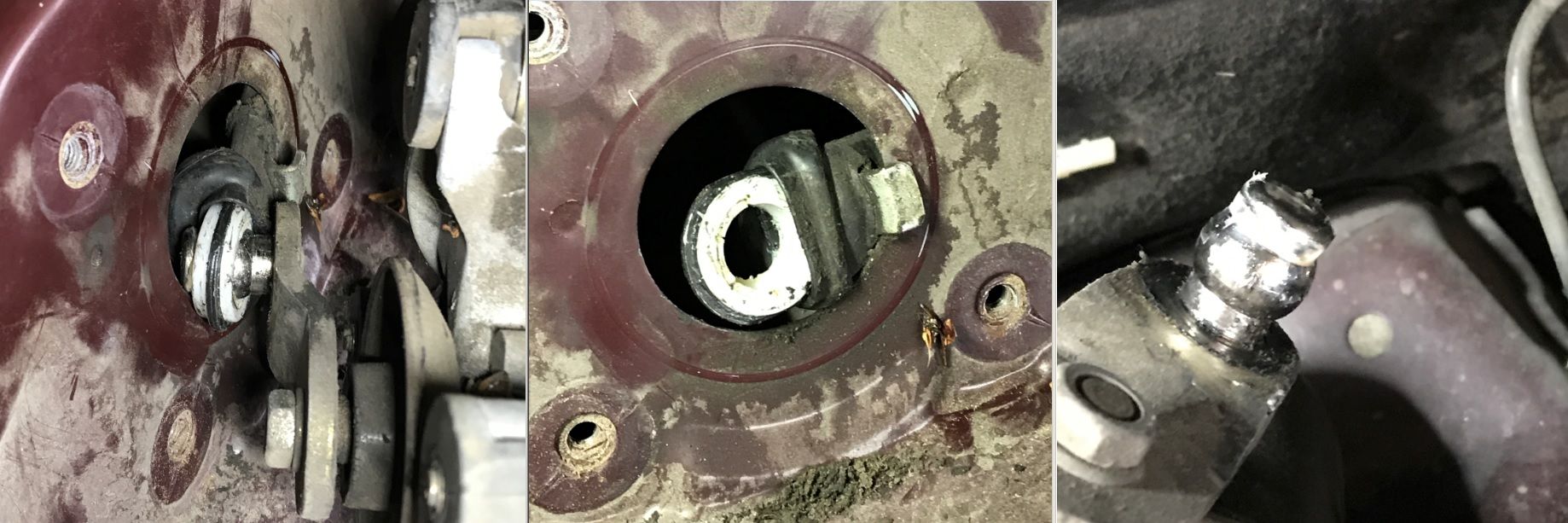

OK - Installed a salvage yard motor today - a quick 45 minute job thanks to Ayune's note above (thank you!).
Looking through other threads on the subject, I came across the below photos that show how to hook the linkage on the edge of the hole in the firewall - These are being re-posted below (without permission from Ayune, but they are his photos, so full credit to him!).
Note--- to get the linkage to stick out of the hole this far, you need to manually move the wiper blade upwards with your left hand, while holding the motor in your right hand and guiding the linkage end out of the hole, and hooking the linkage onto the firewall. Once it is hooked on the firewall, it is easy to use a large screwdriver to gently pop the motor arm ball out of the wiper linkage. The linkage will remain in place, and the new motor can easily be popped back in. Once it is popped into the socket, then manually lower the wiper blade to get the motor back into position to bolt it into place.
