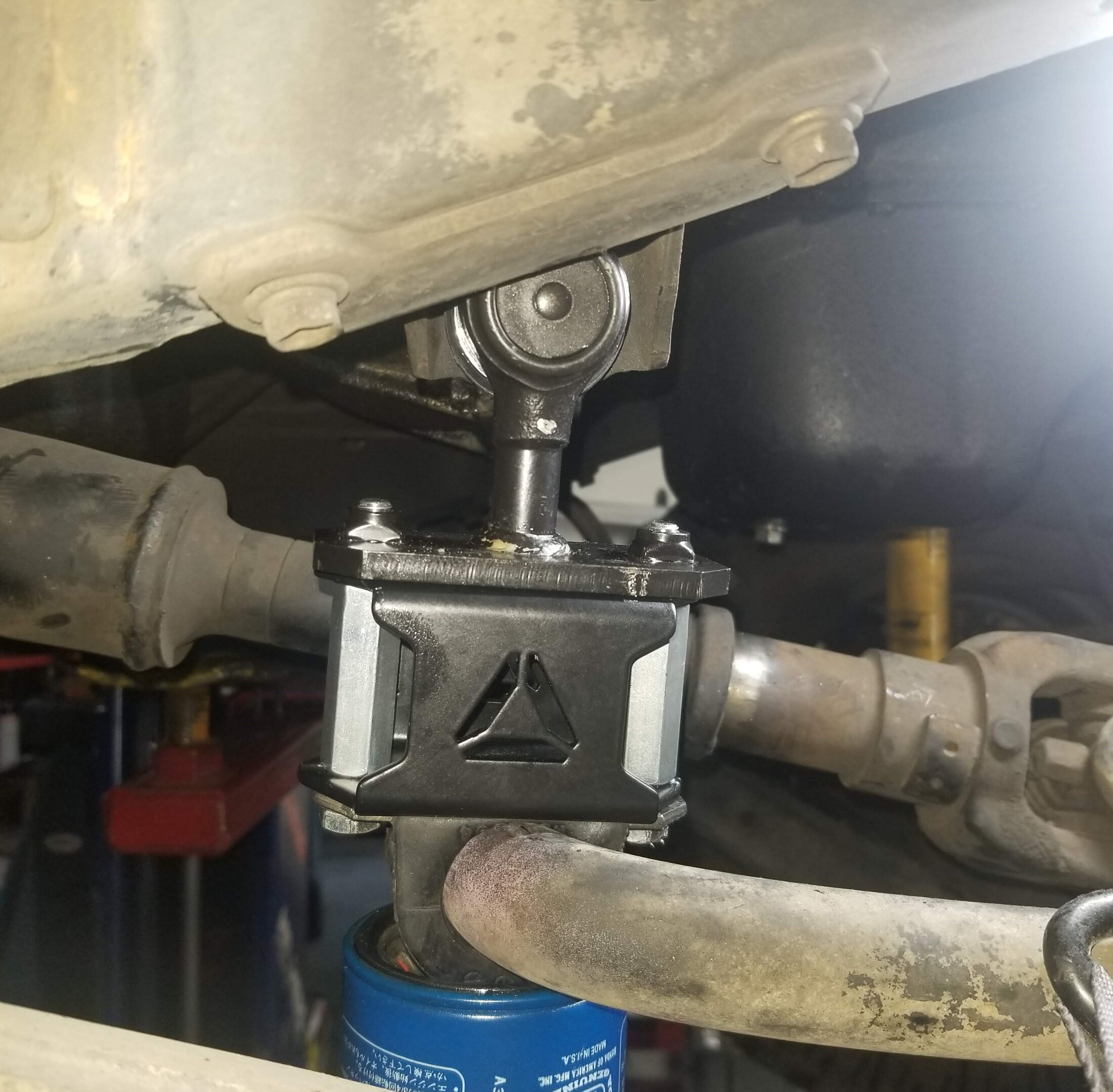

All, I went with the Delta brand spacers. I managed to get new mounts, bushings and the spacer in, but I have to warn anyone looking to install these, the process isn't for the faint of heart. Getting the sway bar up, bolt holes aligned, and parts to all come together in harmony was a ballet of vice grips, prybars and a screw jack (and a Honda oil filter). Not sure if I did it right for the install, but it all ended up without any blood being spilled or bruises showing up.
After about a week of driving the truck around, no contact between anything, no noise and importantly the driveshaft and swaybar are plenty far away from each other.

Part number for the Honda oil filter? :lol:
